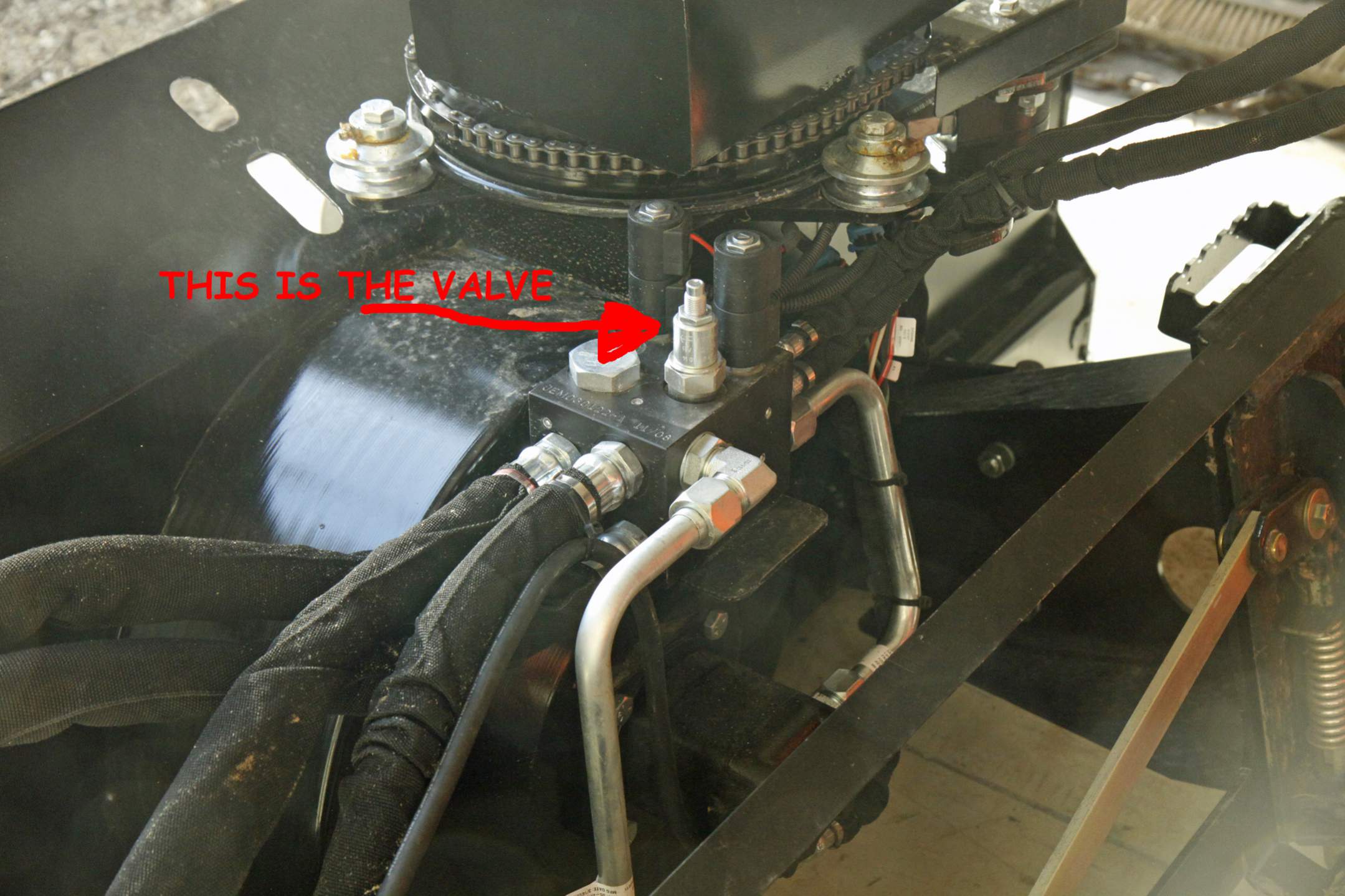

thats used for my loader mounted snowblower in the winter. i remove control after snow season
Ahh, are those all electric functions? No hydraulics you could use for the grapple in the summer associated with the loader mounted snow blower controlled by those buttons?

no , these controls only work with the electric over hydraulics on the blower unit.
