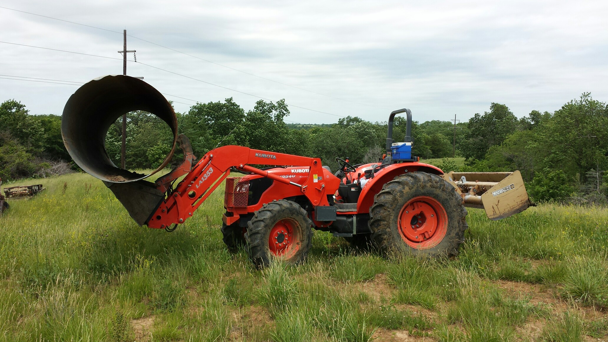

Most of us like a grapple the same width as our FRONT tires, Which is less than bucket size so I would go with the 54". My bucket is 72" my grapple is 52" on my Kubota L5030. The dual lid, like I have, is good for setting tall poles/post and secures off size loads better. Here is a pic of my dual lid grapple setting a tall post. The lids stabilizes the post side motion so just one chain is required.
Interesting application.
   / Grapple Advice: single lid or dual lid? #13
Dual "lids" for holding? Doesn't look right to me.

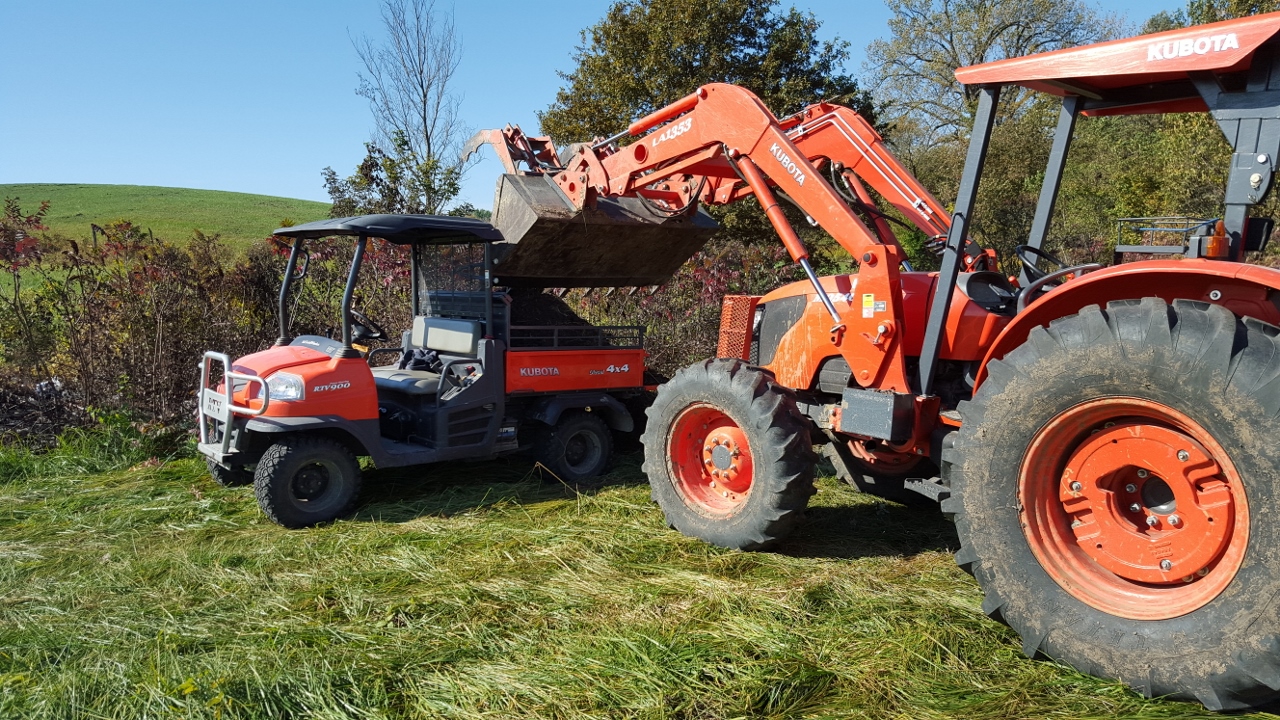

I'm a double guy. Mine is homemade on a Lo-Pro Bobcat bucket. All this talk about versatility gets me going. I can everything posted so far. Then I can go pick up a bucket of dirt...... :)
