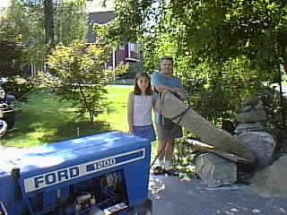

I went and found the toolbox and tapemeasure. Here's what I got from my local masonary supply house: overall length 3 in. with the feathers 1/4 to 3/8 in shorter than the wedge. The feathers placed together without the wedge make a 1/2 in diameter circle (split in the middle of course). When expanded with the wedge flush with the bottom of the feathers, the diameter has expanded to 3/4 in./w3tcompact/icons/grin.gif This system is designed for a 5/8 in hole and I drill to like 3 1/2 deep to use them. Occasionally, I bottom one out in the hole,[hmmm] but this is pretty evident when it happens by the change in sound./w3tcompact/icons/smile.gif Attached are my rough split driveway posts being installed. SteveV
