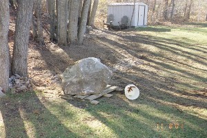

I'm from New Hampshire, the granite state. I'm trying to rid the yard of some of the larger boulders so grass mowing will be easier, look nicer, etc. I have a small tractor and skidded "the little ones" away to the side of my field. I'm starting to split the larger ones, down in size so that my tractor can pull them. So far I haven't figured out the knack of getting nice square straight pieces. I'm drilling with a rotary hammer, 3/4" bit about 6-7 inches deep. I'm using 3/4" feather and wedges (about 6" long). My problem is that once the boulder starts to split, it always curves off at about a 45 degree angle from the bottom of the feather and wedges. Yes, the objective is met, the stones are smaller but I'd like to know what I'm doing wrong? (if anything, maybe it's just these New Hampshire rocks) I've seen pictures of rocks split right down the middle. I'd at least like get a few good square pieces for steps in front of my sheds.
ANY HELP WOULD BE GREATLY APPRECIATED.

How thick are the pieces you are trying to split off?

I've never done it but saw on T.V. after they drill the holes, they use a chisel and "fracture" or weaken it from one side, over the holes, to the other side to end up with a straight break.

Bigger than this one. (4X4X3 triangle shaped)
This was the largest that my tractor could pull.
These rocks are very heavy, being from Nova Scotia, I think you'll know what I mean when I say heavy! The ones I'm tackling now are about 5+ feet.

After you chisel the line across the rock, tap all the wedges in until they are tight, then hit them one at a time across the rock, then go back and hit each one again, repeating that until the crack opens up.

Have you tried rotating your plane of cut to match that 45 degree angle? It may be that you are not following the grain (you can read some rocks, other are a mystery). Show us some pictures.

That's the look I'm looking for! There are plenty of cut
rocks here in NH just as you described. We have
old "pounds" in just about every town and they show
the cut marks as well. Old retaining walls around
cemetaries, etc. How'd they do it??????
If you look at the rock in the picture, I'm trying to half
something like that. That puts them about a ton and a
half and the BX can skid that amount of weight. I go slow.
Andy
These rocks are so weathered I can't tell where the
grain is.

I also saw the rock splitting on This old house. Perhaps you will have to almost circle the stone with holes to get a good break. From the looks of the foundation rocks it would seem they have been broken from larger flater pieces. Just guessin as my rock splitting knowledge is zero. I have split some of the slate for a campsite down at the lake but that do not qualify as rock splitting.

From what I can remember granite does not have any defined fracture planes. If this helps any.
