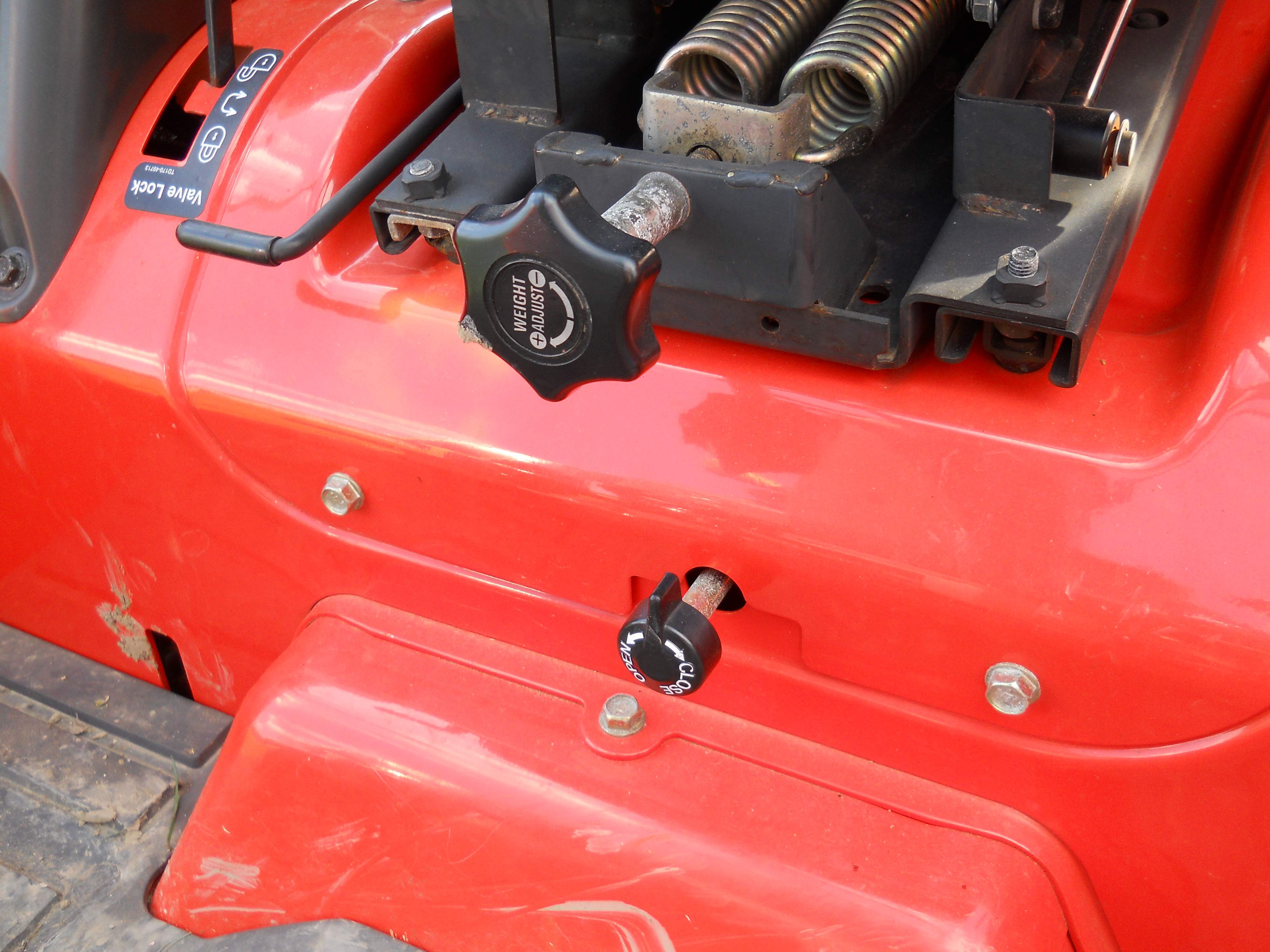

Hey gents my L5740 has the 3 pt all the way up and will not go down. The lever is connected under the seat area. I hve no draft control or rear hyd outlets. I was too hot do much other than look today but anyone have any ideas

I am assuming you know about the drop rate valve between yours legs under the seat. Make sure it is open.:thumbsup:
   / Grand L5740 3 pt will not lower #3
Here is the 3 point flow control knob. Make sure it is in the full open position. Philip.

thanks that was it i must have moved that valve getting on or off:thumbsup:
