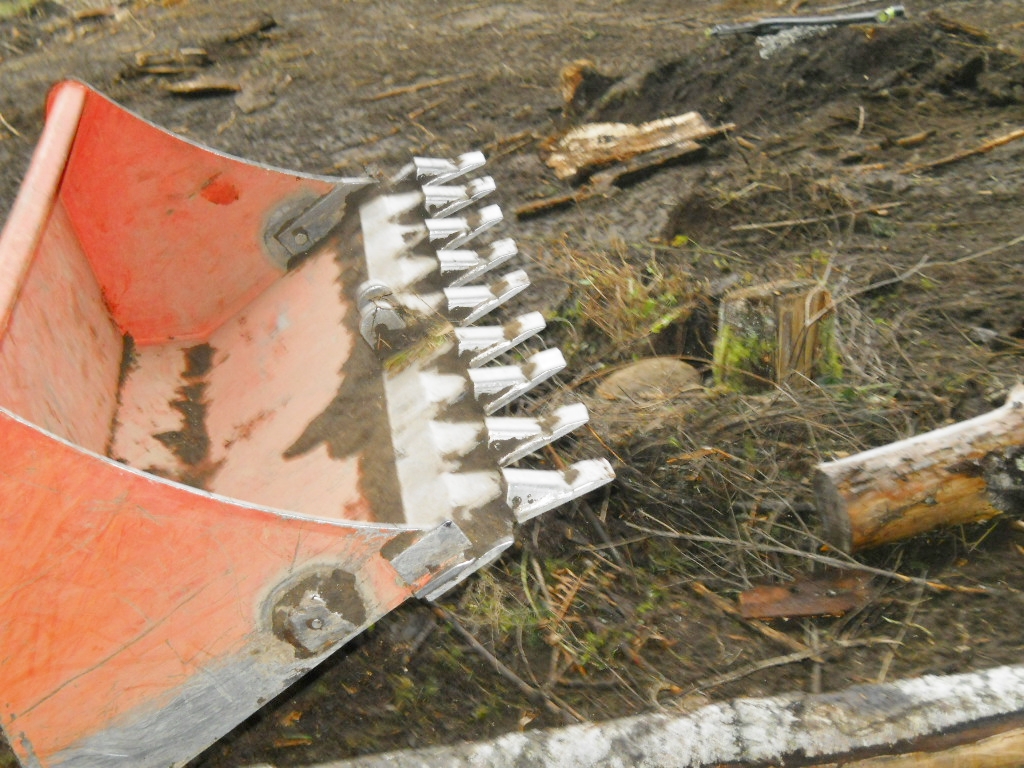

I have a BB but find it cumbersome to use as it does not hold much and you still have to dump and pick up with the FEL. I made a heavy duty tooth bar for the FEL. It now digs like a champ, even scoops up sod where the smooth edge just rides over it. Haven't used the BB since except to rip. The tooth bar makes easy work out of moving rocks also.
Ron

I have a sub-soiler and am wondering how it works to plant trees? It does not get the dirt out of the hole. I use the BH for that. FEL makes too big a hole. I made my own tooth bar as all the attachments I see on the web look to flimsy for what I do. My teeth are replaceable, they just pin on with a hollow pin.
Ron
Ron
That is a nice tooth bar. I like the replaceable teeth.
   / Grading with a subcompact to take out a slope #30
That's a really nice tooth bar.:thumbsup:
Any reason why the teeth are not turned around?
