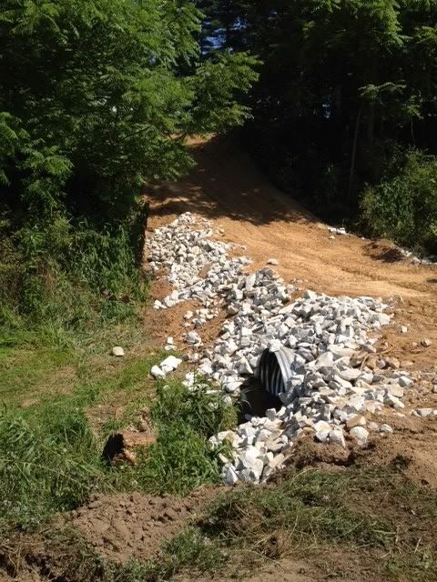

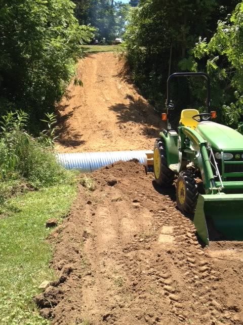

The box blade with rippers is going to be the tool you want, don't make the mistake of buying the wrong size. My 3320 built this bridge/driveway in about 3 days (my first job ever with a BB). The hill was very steep. Go slow, always pull the dirt downhill when you can and keep the seatbelt on with the rops up. Make sure to post up some photos.
