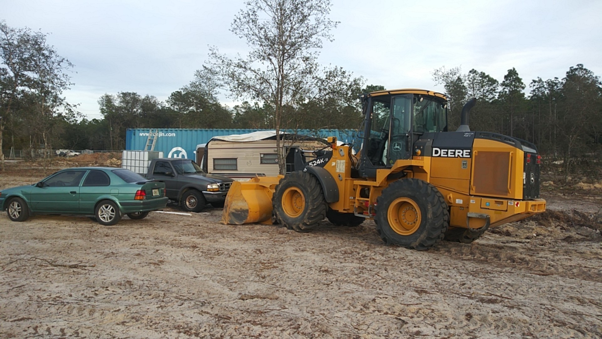

I used it for about an hour last night. Im not having very good luck. Its alot harder to see anything than my last machine.
Hopefully after 8 hrs seat time today I'll be doing better.
Nice looking machine. I've never run one before, so I can't say anything specific about using it. In some of the comments, I'm not sure if they are referring to something like this, or a compact tractor? Are you dumping what's in your bucket all at once, or slowly tipping it and letting a little out as you continue driving forwards or backwards?
I'm not sure why people want to tell you that you should have something else? This is what you have to work with, and I don't see the point in focusing on what ifs or should haves.
My guess is that in a few more hours, it will all start to come together for you and you'll find it goes faster with better results.
Great point that I share; it isn't so much what you see, but what you "feel". It takes a lot of time, practice, and patience to gather that skill. I personally am a whiz at grading with a FEL, but I have also been doing it for 40 years. Hang in there, you'll get it.
