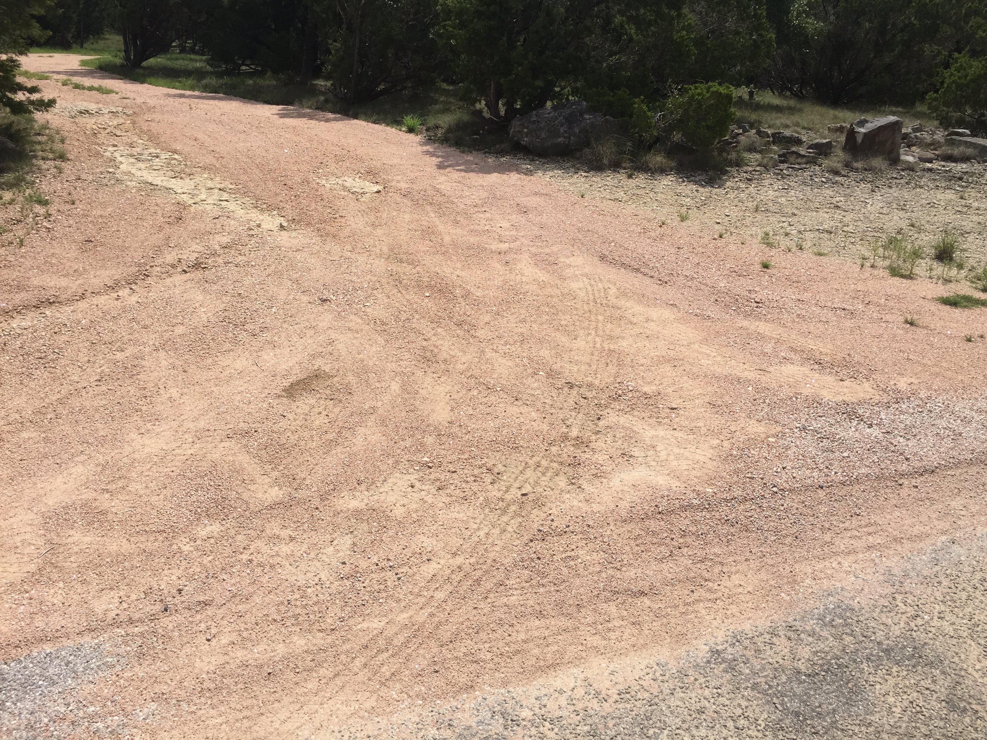

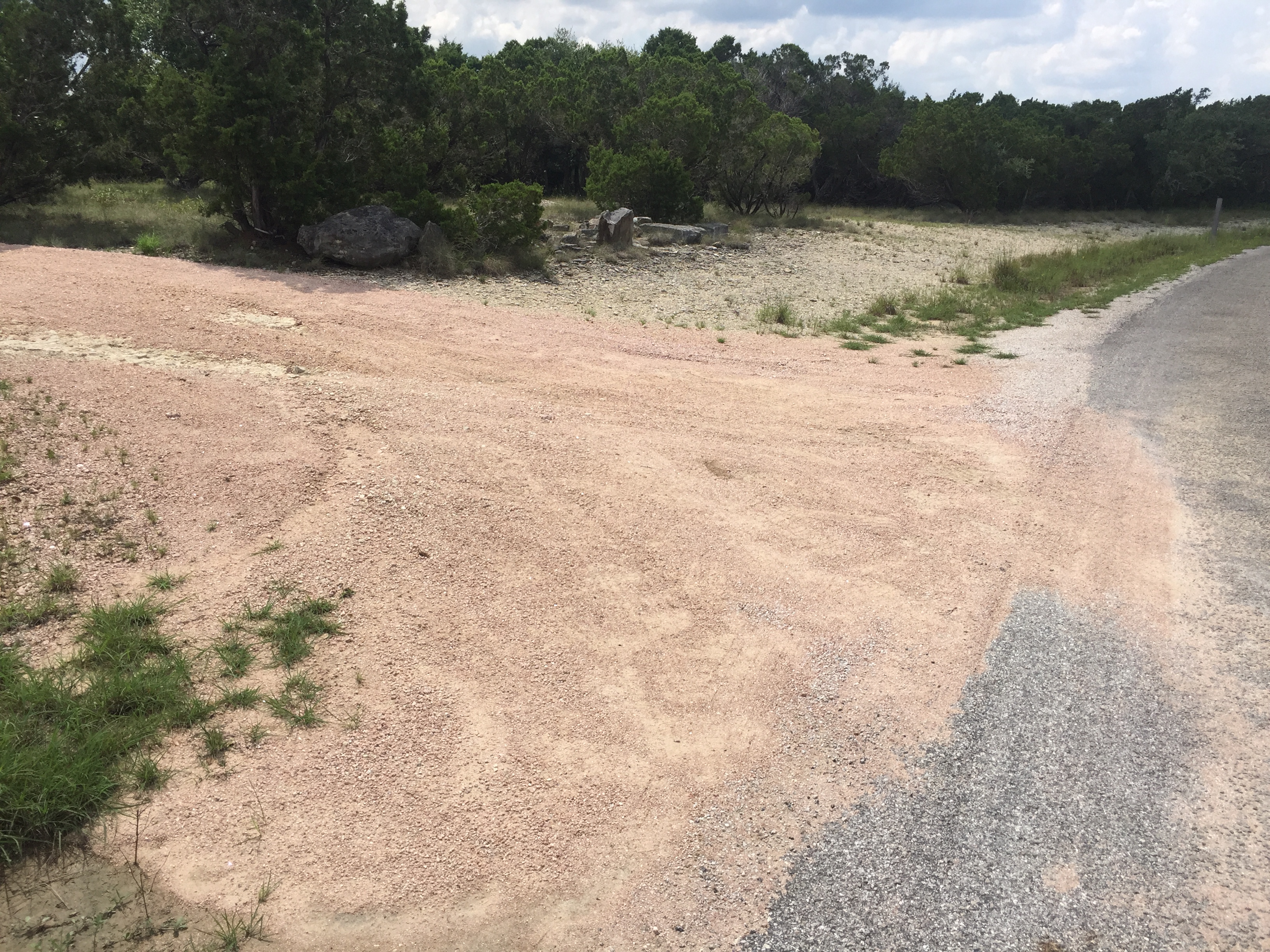

My Grapple is hard to beat but the new grader scraper might just be my new favorite. I've been reading about them on here for awhile now and didn't think I really needed it since I already had a landscape rake and box blade. I was wrong and can't believe how well this thing works.
I've got a mile driveway at home as well as another mile of gravel roads around my business to maintain. My roads around work have been neglected for a couple of years now. I was looking at about $3,000 in new gravel and decided to spend the money on a grader instead to see what I could do with it. Here are some before and after pics. Still can't believe how well this refurbishes the roads and fills in low spots. Grader is a 72" landpride.

Great looking results!! :thumbsup:

Another believer in LPGS's :thumbsup: Everyone seems to love them.
Great before and after shots. Besides leveling there ability to remix the gravel so that it is like a freshly regraveled road makes them a very good tool.

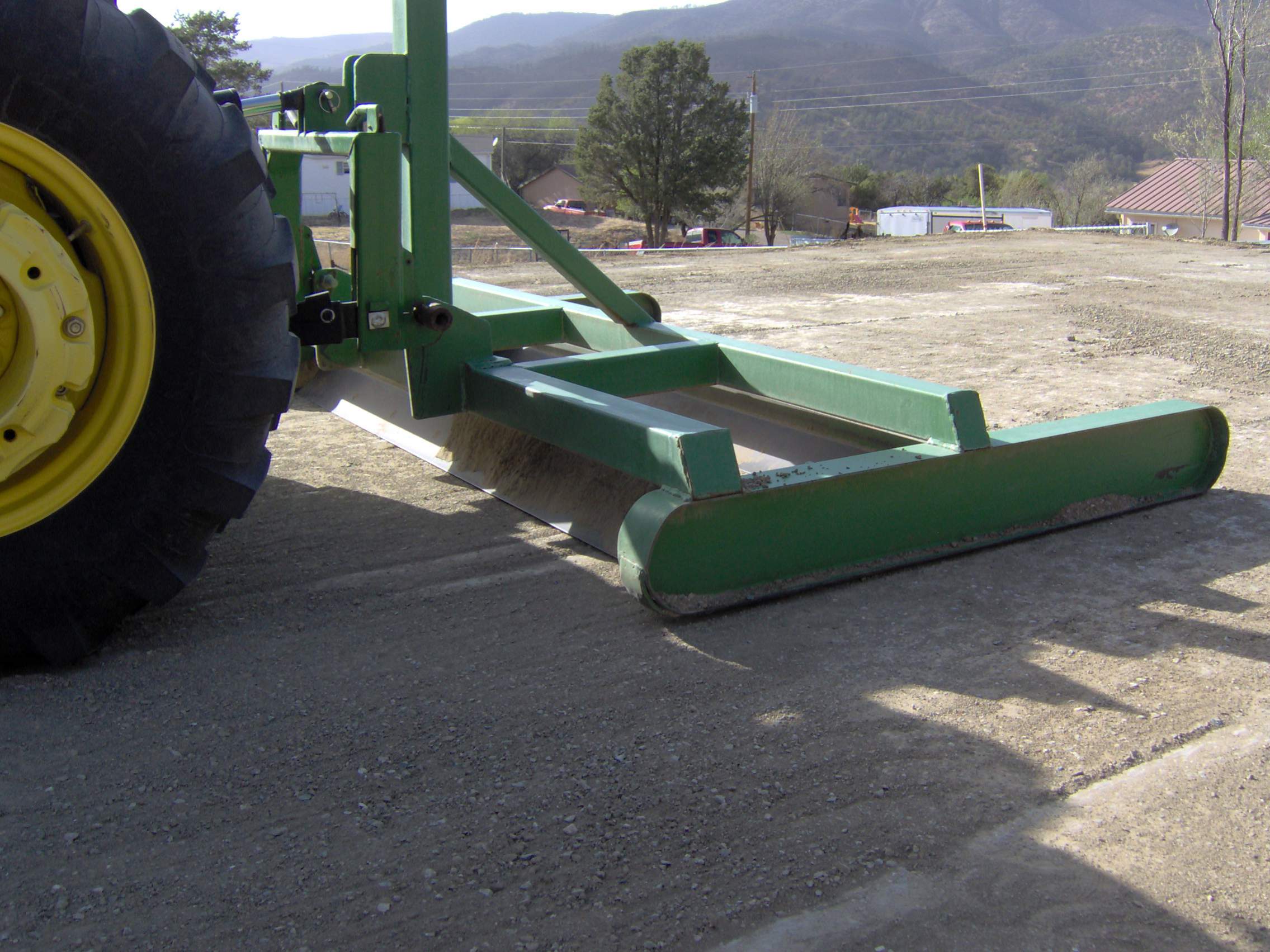

I built my two lpgs and Gordon Gould built his. I would prefer taller skids if the material is available but will say as long as you have enough clearance between the blades and cross members you should be fine. I have never had an issue with material overflowing the skids and sides of the planes. Never seen it happen yet.
Here are the two I built a few years ago, both do a good job for me one is 8' wide and one is 4' wide.
