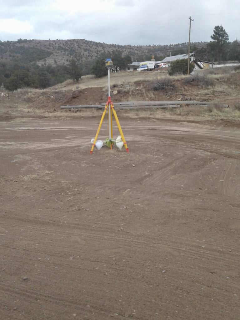

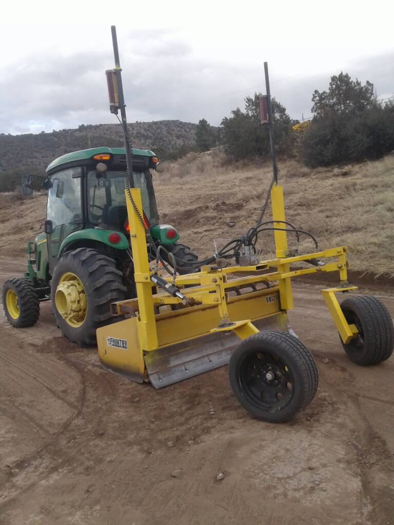

I have a Topcon RL200 2 slope with remote. Works great for field leveling with slope changes. Enter the slope you need with the remote and it is ready to go in seconds.
The receivers I use have a range of about 8 inches. That has has been plenty of travel for grading in my experience. 20180324_175350.jpeg20180324_174906.jpeg
