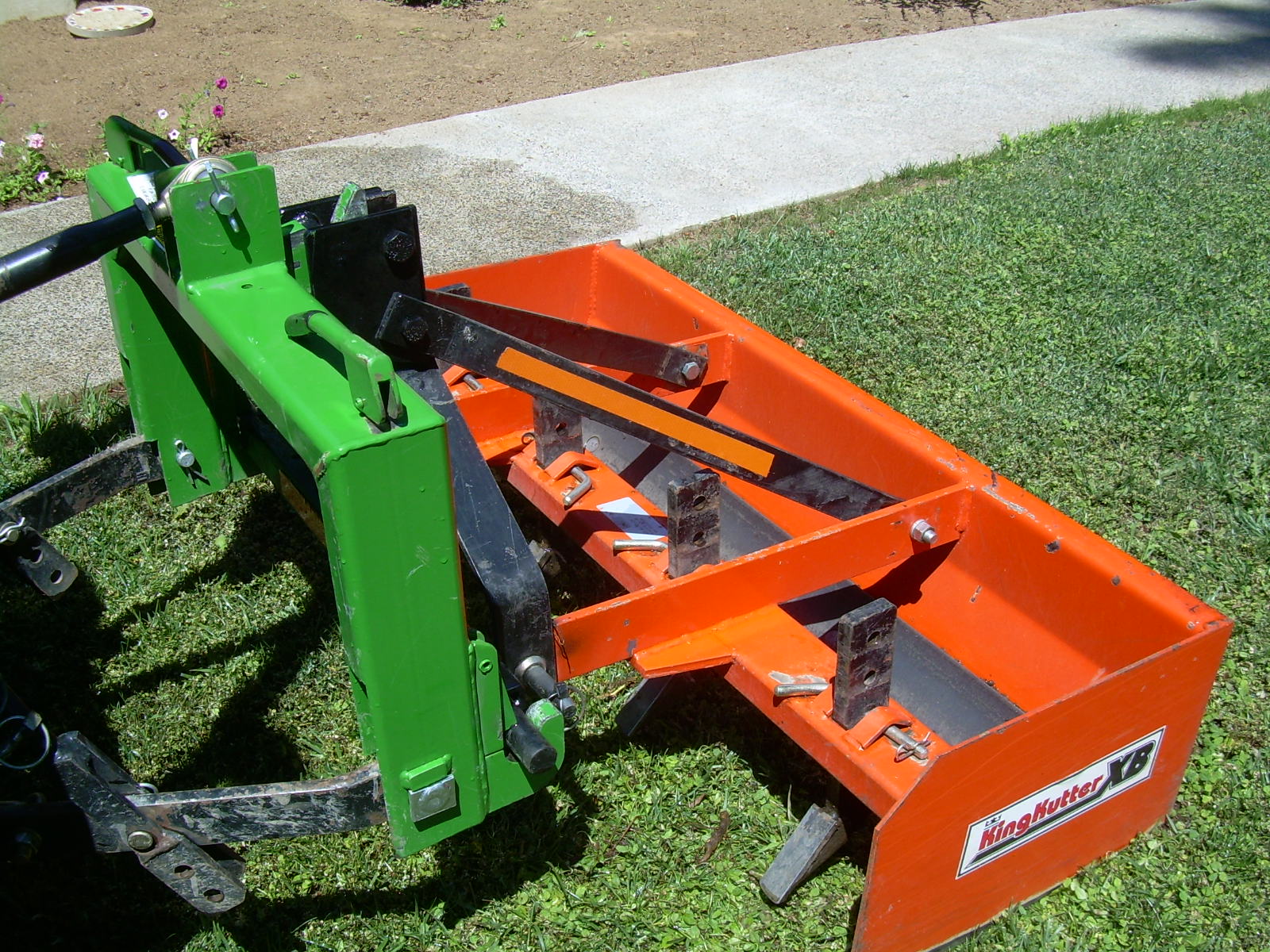

I have a grader blade and a boxblade. The boxblade has done many things, (dig up arenas, level areas, dig out new area for a fire pit, made trailes in the woods, and bull dozed dirt). My grader blade is pretty new and has (pushed snow, graded the arena, graded the driveway, added weights to hold back of tractor down when transporting heavy loads with the loader, and spread gravel). I researched before purchasing both implements and got great deals. The KingKutterXB boxblade 4' was $425 and the grader blade 5' was $250 from Montana tractor. The boxblade would be a first for dirt work but the blade is excelent for snow removal.:)
