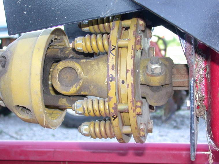

Got home friday and my step-son told me he broke the shear bolt on my Rhino SE6 cutter. HUMMM thinks I, the cutter's got a slipclutch on it and it's not supposed to HAVE a shear bolt. He shows me the bolt head and darned if it didn't have those 5 star points on it, yup, grade 8...
Now, I haven't been a good boy and loosened up the slipclutch and let it spin like I'm supposed to so maybe it froze up on me. While replacing the bolt we loosened it up and it spun under hand pressure, sure didn't seem to be rusted or frozen.
Not sure just what's going on there. Any hints? (oh yeah, the springs were compressed pretty much just like the spec said they should be)

Slip clutches will "freeze" (rust) to a point where they won't slip even if adjusted properly. They need to be forced to slip and slipped enough to "shine" the mating surfaces. A mower equipped with a slip clutch that is stored outside will most likely need the treatment more often than one kept out of the weather, but none-the-less, I do it with my mowers AT LEAST twice per season.
On the shear bolt... Is (was) the bolt that sheared of proper size? (Still, it SHOULDN'T have been grade 8, even with a slip clutch) Too small of a diameter bolt will shear with quite a bit less resistance than a properly fit bolt.

I'd check to make sure the PTO shaft is the proper length. If the shaft is too long, then it is possible that raising or lowering the cutter could stress that bolt enough to shear it or weakening it.
Is your shaft splined or a solid shaft with a bolt thru it? My slip clutch has splines...Is yours similar to this?
dwight

No splines on either the slipclutch or the gearbox shaft. Smooth only.
The PTO shaft seems about the right length, I guess. Rig's been raised fully and lowered quite a bit in the time it's been run, I'm assuming the bolt would've snapped pretty quick if it was being stressed from an overlong PTO shaft. Or is that a poor assumption?

I don't think there are any poor assumptions yet. You're still in the discovery stage on this problem.
But I think you can figure it out.
At this point, perhaps, you could read that Rhino cutter owners manual carefully, and set the mower up as the mfg recommends.
Personally, I wouldn't concern myself too much with this condition. Maybe just put a new gr 8 bolt in there and run it like you stole it!
If the bolt shears again, then you have a repeat problem and a basis for even deeper troubleshooting. Maybe even a phone call to the mower mfg technical group...if thre is one...
