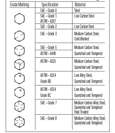

</font><font color="blue" class="small">( <font color="blue"> The grade is the number of hash marks + 2.
grade 2 = no hash marks.
grade 4 = two marks.
grade 5 = three marks.
grade 8 = five marks.
</font>
Junkman were you asking me personally or was this posters information correct? /forums/images/graemlins/grin.gif )</font>
No, but you did point out one fly in the ointment that I had originally missed ..... if the grade is the number of hash marks + 2 then a grade 8 having 5 hash marks + 2 would equal a "grade 7".... darn.... this new modern math is hard to understand... /forums/images/graemlins/blush.gif ......

Grade 8 = 6 marks, not 5 as has been pointed out.
