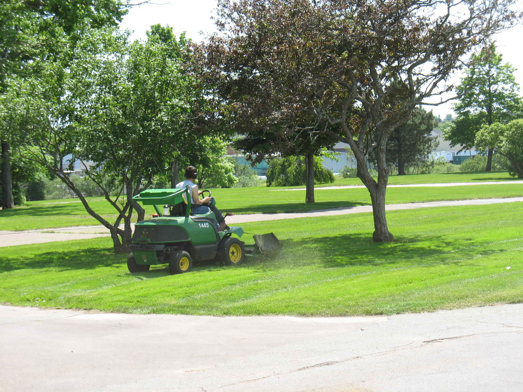

Is the the top of the box facing up or is it facing backwards and the latch is keeping it closed? Of course if they had to drill holes or weld a mount to the ROPS that's would have been a stupid thing to do.

If the ROPS is deemed to be a hazard to the operator, it can be folded down. Grass cutting around trees definitely meets that criteria.

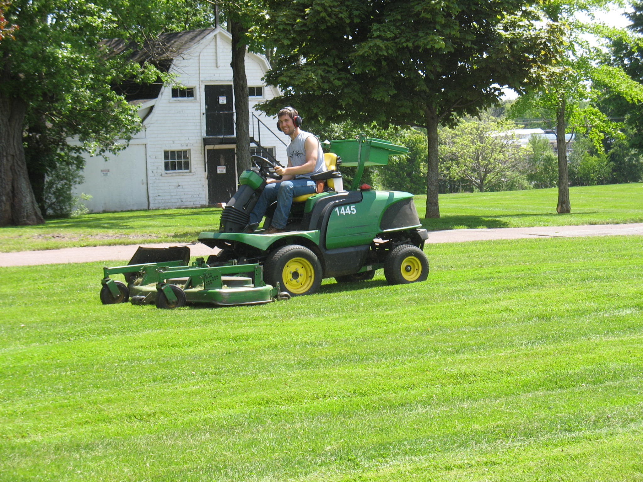

Here's a shot from a different angle. I'm sure that mowing under trees is a contributing factor to having the ROPS folded all the time; as the landscaping matures, that should be less and less of an excuse, though.
The hinges on the toolbox are at the back/top and, as far as I can tell, there is no latch, so the lid would flap like the tailgate on a dumptruck if they ever raised the ROPS.
I have to admit that I am assuming the box is bolted to/through the ROPS bars (otherwise it would bounce around too much), but I haven't actually looked closely to verify this.

Did yall see that the safety deflector is held back by a bungee cord?
If you run over a stick or rock it can bounce off that tree and hit the operator. It happened to me, so I know it's possible.:laughing:
Not to mention he is cutting with the discharge pointing to a sidewalk. He might stop when someone comes down the sidewalk, but who knows for sure? Maybe he figures he is far enough away from the pedestrian that it's safe, but we all know how far a small heavy object can be launched by mower blades...much farther than most people would ever expect...and having the deflector up in the air allows any object shot out to be launched upwards instead of down along the ground. I consider that to be more of a concern than the ROPS.
Yeap, those unseen hazards seem to show up at the worst possible time.
Many years ago when I was a kid, I was cutting the grass between the road/ditch when a rock bounced off the road and hit my sister in the forehead. Guess who dad blamed for that one?:D

These guys are definitely government employees. Whoever does their job orientation does manage to convince them to stop the mower whenever pedestrians come near; they're very good about that. The smiling guy is doing so because he stopped mowing when he saw me taking pictures, then smiled when he realized it was HIM I was taking pics of!

Is it possible that the tool box is on little pivoting mounts, such that it will always swing upright regardless of the ROPS position?
xtn
I thought of that solution, too, but no, that would make too much sense for a government operation!
Even if it was, it would hit him in the head if the ROPS were raised.
Hey ... at least he is wearing "ear protection"

I wouldn't know but they may have done an assessment and determined that the ROPS was not needed because of the (lack of) slope of the land and the difficulty of getting under the trees. Are ROPS required yet in Canada for commercial mowers?
