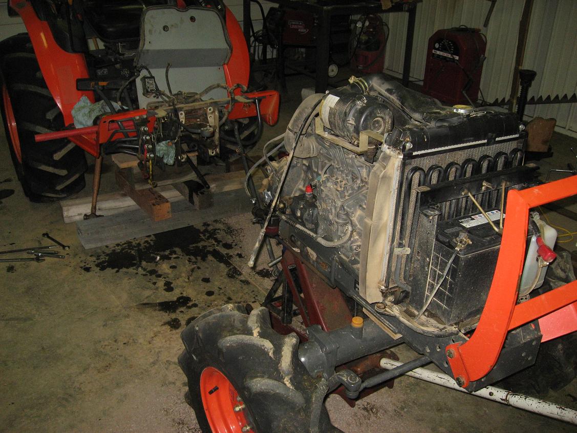

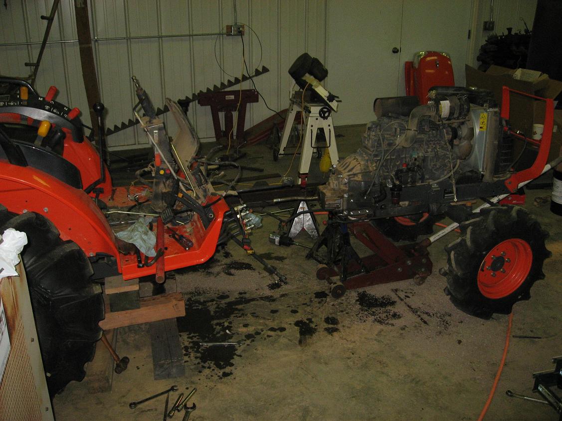

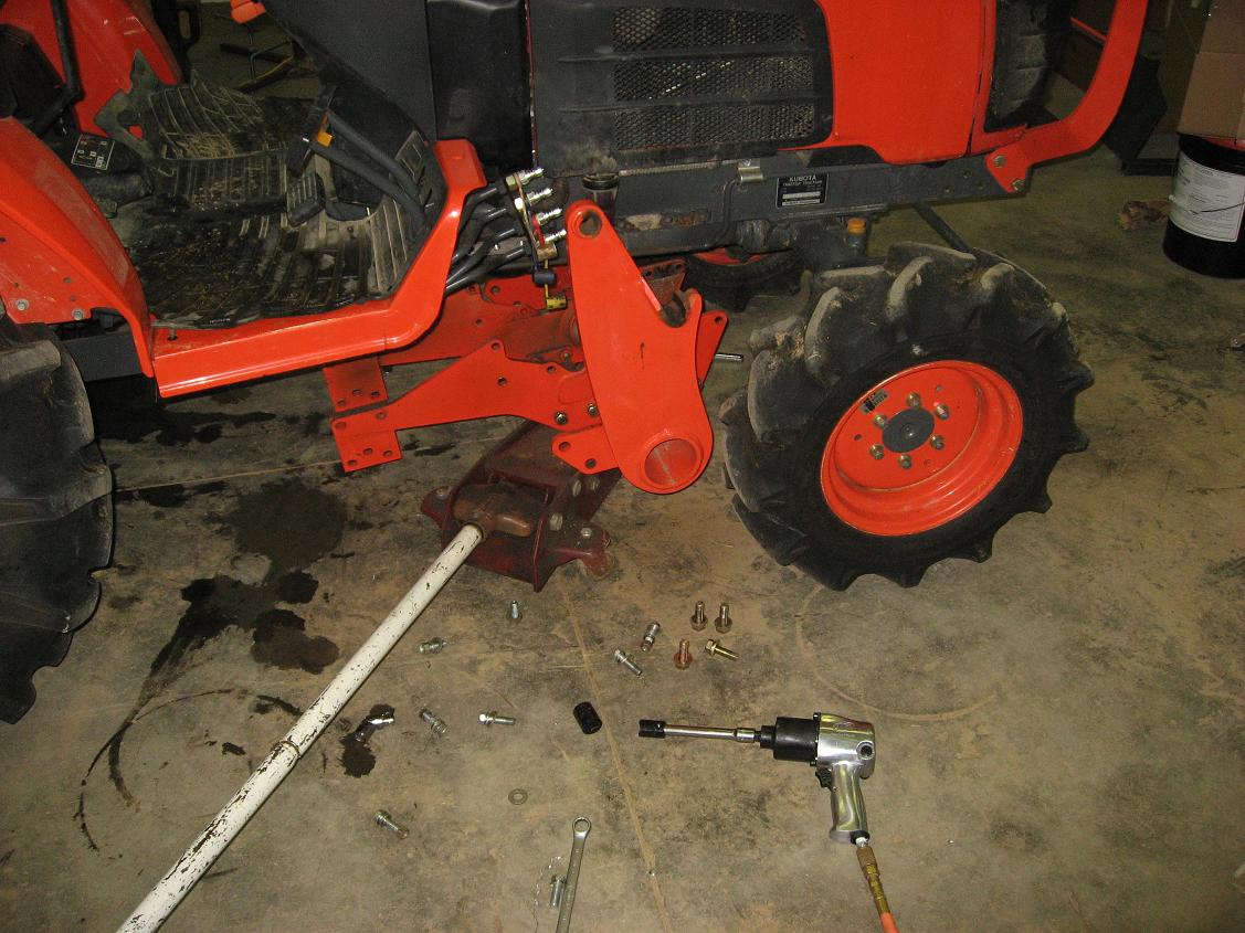

Anyways, I got the new seal in today. It was quite a job, and I still have to reassemble the tractor. Total time to split the tractor took 3hrs, it then took about 3 minutes to replace the seal, lol.
First I dropped the loader frame, lots of bolts but pretty straight forward. Lowered it down on the floor jack, it actually wasn't as heavy as I thought it'd be. Next took off all the sheet metal, fuel tank, wiring harness and steering wheel. Then came a multitude of hydraulic lines, some more wiring, and the steering drag link. The whole front 4wd drive line also had to be removed. I then realized I had to remove the steering box to get at the bolts to remove the rear frame section, so it had to come off as well. Blocked up the rear half of the tractor on some wood cribbing, then placed the floor jack under the rear of the engine portion. Unbolted the six bolts and 4 nuts/studs that held the two halves together, slowly rolled the front forward and then all the sudden I had a pair of two-wheeled tractors, lol.
Attached are a few pics of the splitting, once I get the rest uploaded I'll post some pics of the offending seal and drive shaft fix.

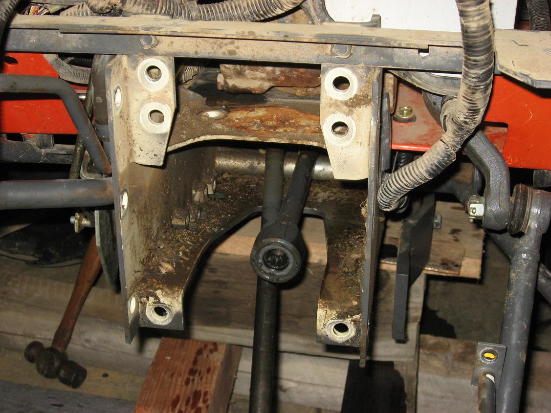

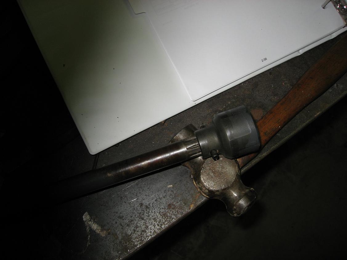

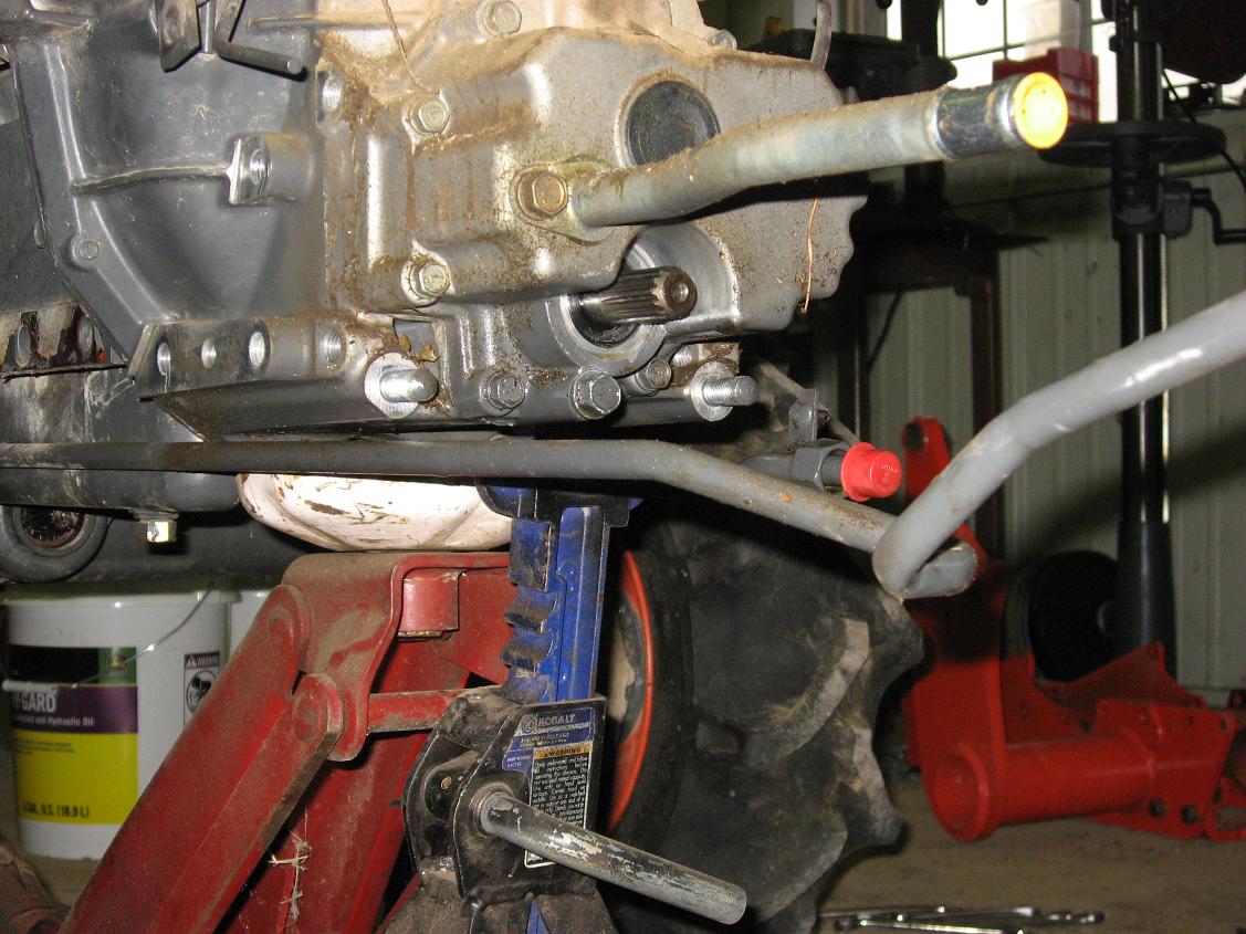

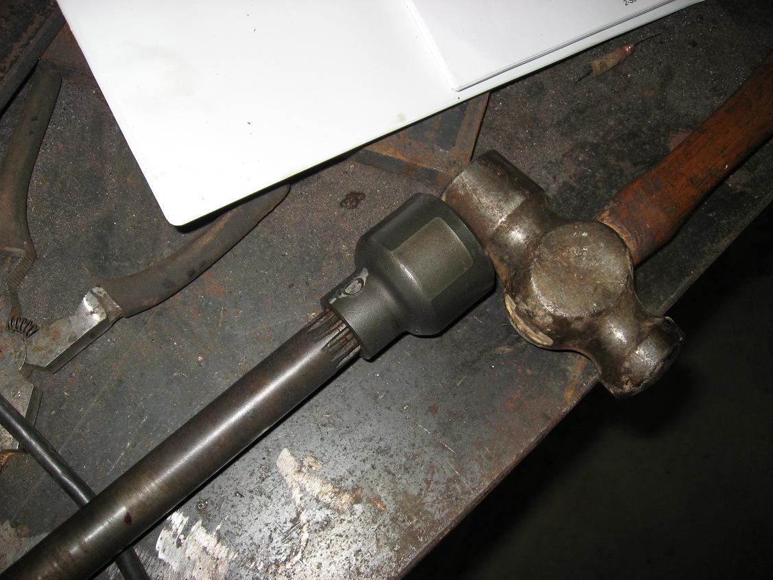

Once I had it apart I drilled a tiny hole in the seal body, threaded a screw in it and pulled it out. Sure enough there was some hay wrapped around the inside of the seal, hence the leak. Cleaned everything up real well, inspected the shaft and seal bore. A little light grease on the inside of the seal, and a very light coat of permatex 'super 300' on the outside of the seal, then carefully drove it in flush. Attached are some pics of the offending seal, and the location of the drive shaft in the rear section of frame.
Next was fixing the drive shaft so it this problem wouldn't happen again. The pics below show the original setup with the too long roll pin which caught the hay. Next pic shows the shaft with the roll pin cut off and ground flush. I did this on both ends, although the end at the HST is very unlikely to ever get anything into it.

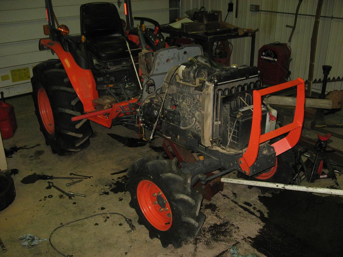

Slid the drive shaft back into place, cleaned up all the mating surfaces, and put the two halves of the tractor back together. I wasn't the easiest thing to do as 4 hydraulic lines, 4 studs, and the drive shaft all had to line up as it went back together. A little fiddling, some prying, etc and I had it all lined up. Put in a few of the bolts and that is where it is so far. I still have to put everything else back together, but at least the main fix is done. Probably will take another 3-4hrs to get everything else back together as I like to clean everything up and torque everything to spec as I go. Might get a chance to work on it tomorrow or monday, I'll give an update once it's back up and running (hopefully without to many leaks, lol)
Here's a pic of it as it sits now:

Thanks, it was a fairly large job, but when you just start tearing it down one part at a time it's fairly straight forward.
