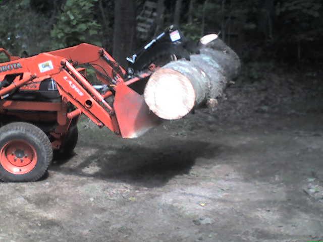

Had a little fun this weekend. I dug out a big pine tree with the hoe, knocked it over roots and all and carried it off in two pieces with the thumb. I never realized how useful a thumb can be.

Here is a good side view of the thumb.

lzicc; You probably know this but just remember a BH is ment to do the work with the out riggers down. This helps support the weight and keep balance. Not saying what you moved was too heavy but if it is used like that for a lot of heavy stuff you maybe replacing broke parts JM:2cents:
/ Gotta love the thumb
Yeah, I know. I was transporting the tree to another location. Do you think that is to hard on the machine? The thumb thing is new to me, but I want to make sure that I don't do any damage either like you said. I liked the way I could position the tree parallel to the tractor so I could move it up the driveway.
/ Gotta love the thumb #11
In a word YES, it can be, not saying lighter loads would be an issue but heavier loads could cause premature wear down the road. Another thing to keep in the back of your mind is safety/balance{again I'm sure you know this} carrying something to the side like that does give a "tip factor".
I can relate to that I use a mini excavator the same way to move logs out to my trailer. I like the fact that I can move them through tight spots and not drag them through dirt. The logs get used for milling, clean logs are much better then dirt covered.

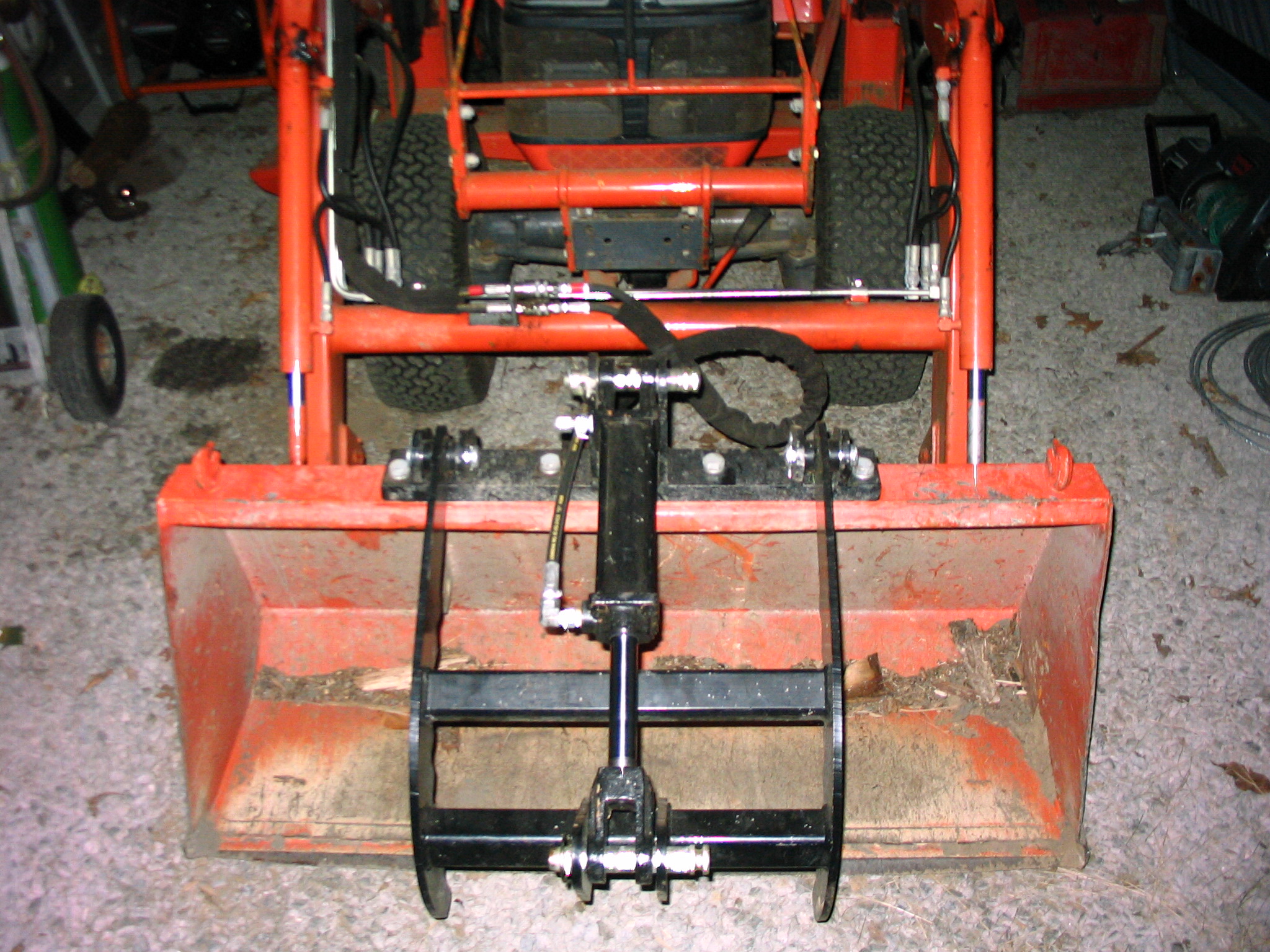

The other Thumb....for those w/o back hoes....

I don't know about riding around with that arm all the way out like that with a load hanging off the side, and no ROPS!! Hope the rest of your land is as flat as what's in those pictures! I know that if it goes over in that configuration...and to be sure, I hope it never does....the hoe will stop the tractor just like it was a big stabilizer......but still....
