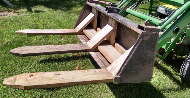

I've decided it is time upgrade from my old wooden forks that I've used for the past 15 years! (See attached picture of the old wooden one.) They've served me well but since they are stored outside, every year or two I have to replace cracked, worn or rotten bits of 2x in order to keep them in good working order. Additionally, as you can see from the picture, the wooden forks that I built use three 2x10s for the forks to provide some strength which means that I can't pick up a traditional pallet. Finally, I've always been a bit concerned about the real potential of a catastrophic failure that will of course occur at a most inappropriate time.
Anyway, I found a nice old set of 36" forks (for only $50) that, other than a bit of minor surface rust, are in pretty fair shape - the perfect size for my little JD 790. However, I'm going to have to make a carriage for the forks and then of course there is the minor little problem of converting my pin-on bucket to some sort of quick attach. I'm way too old to enjoy horsing attachments around to line up pins!

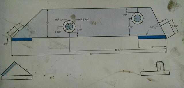

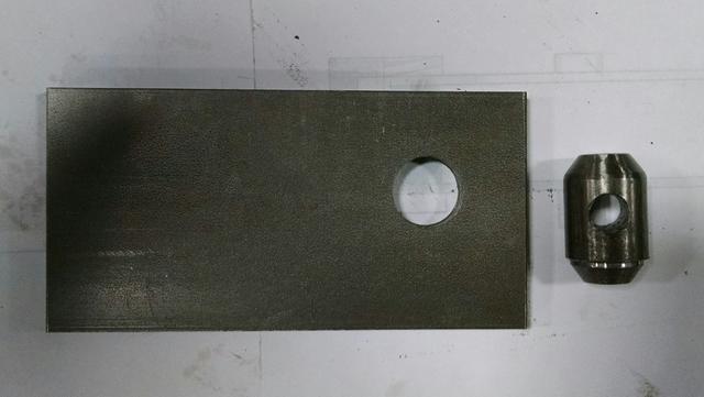

OK, been working away at the chosen concept for a quick-attach. Here are some pictures of the progress with a few words to help describe what I'm doing... er... trying to do. :eek:
I first played with a number of designs with pencil and paper and then spent a couple of days learning to use SketchUp in order to get a better idea of how it might work.

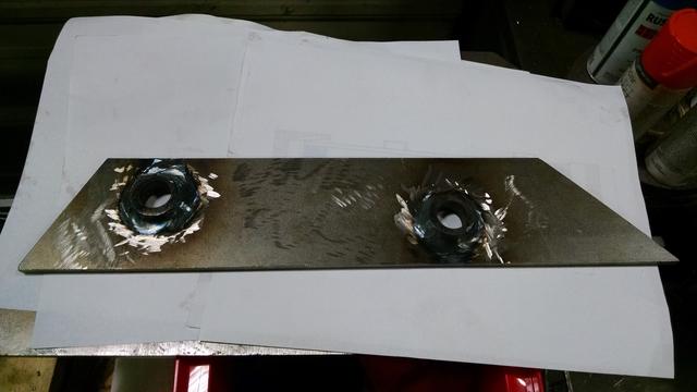

I then dug through the steel pile and pulled out a few pieces of flat stock and 3/4 ID pipe that might work and cut and drilled and welded and came up with the individual ears that will be welded up to be attached to the loader. Here's one of them although it's direction is flipped from the drawing.

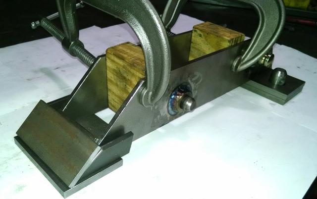

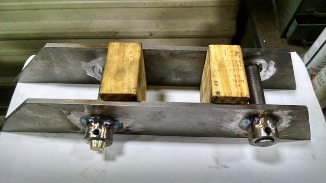

Here's a matching pair with a set of wooden blocks used as spacers which are sized to allow the fit of the loader arms and hydraulics.

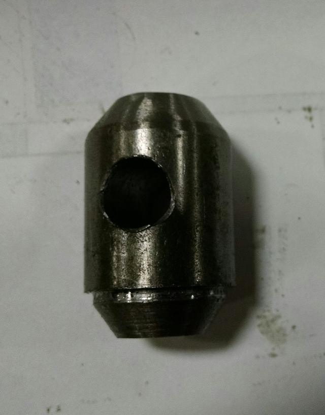

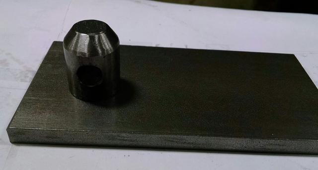

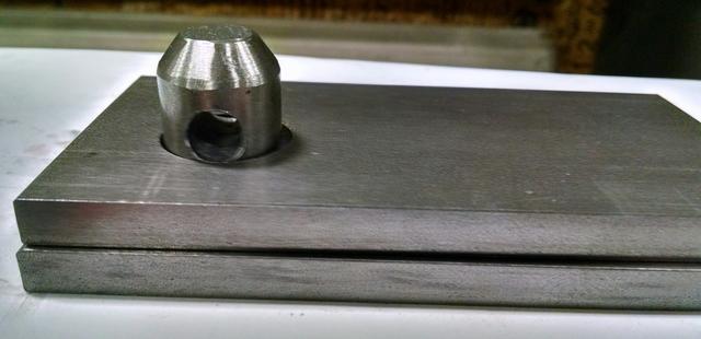

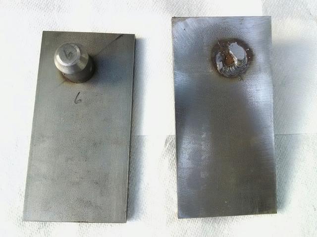

I then took some 1" round bar stock and turned and drilled out a few pins that will be welded to a plate which will then all be welded on the bucket. To try to create some consistency, I turned down a 7/8" diameter 1/8" deep step that will allow the pin to be located in a 7/8" hole drilled in the plate. Here's a pin:
And here is a pin alongside a plate and then the pin in the plate. You may note that I used 3/8" x 3" cold rolled bar stock for the plate so it should be strong enough. The third picture in this group shows the bottom plate (yet to be attached) to the ears as it would fit over the pin.

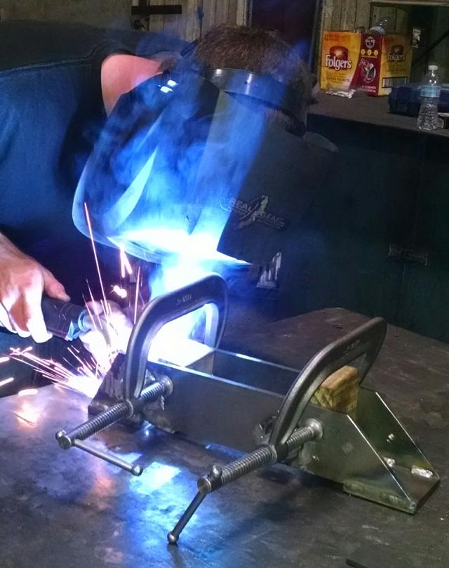

Next it was time to cut up various bits of bar stock to finish up the ears and create the pockets. I used 1/4" stock for the ears and the upper or outer part of the pockets but used 3/8" stock for the base of the ears and also the bases to hold the pins and pockets. Then I mocked up all the pieces in order to check fitment.
Looked OK so...

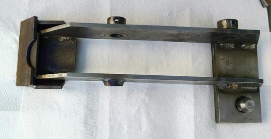

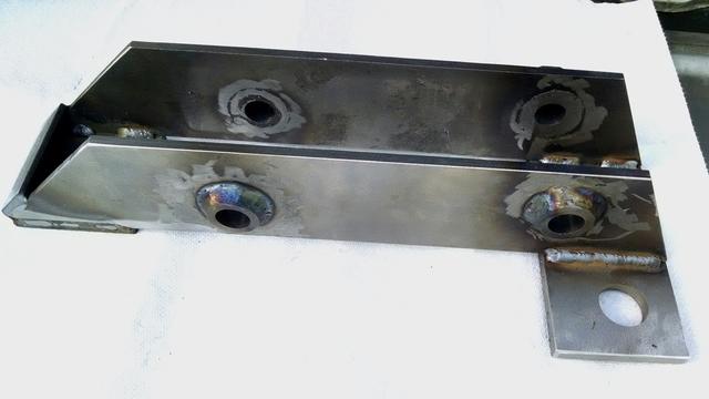

OK, back to posting the rest of the pictures... Had to stop to eat dinner. Hmmmm BBQ Wings - not much better. It's like eating Sunday dinner on Saturday!!! That comment should age me. :laughing:
Anyway, here are some pics of the welded up pieces. This first is the completed ear assembly that will be attached to the individual loader arms. I've not yet done the cross bar that will lock the two together as I can't find a piece of 2 x 3 stock. I'm trying to build this without buying any steel although I may try the salvage yard. I like to think that I'm not really cheap, just Dutch. And yes, I am proud of my Dutch heritage.

This next is a pic of the pin welded into the base plate. You can see that the pin sits cleanly on the plate with the back side solidly welded within the drilled hole. Because of the recess in the 3/8" thick backing plate, very little grinding was needed to smooth out the back side of the plate. This plate then will be welded onto the bucket.

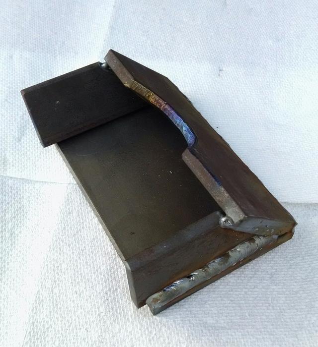

Below is a shot of the welded up pocket that will be welded onto the bucket in order to catch and contain the nose of the quick attach assembly which will be on the loader arms. You can see that one side is angled out in order to facilitate lining up the loader arms as it moves into the bucket. I've not yet done any additional welding on the inside of the pocket as I want clean contact between the sides of the mating assemblies.

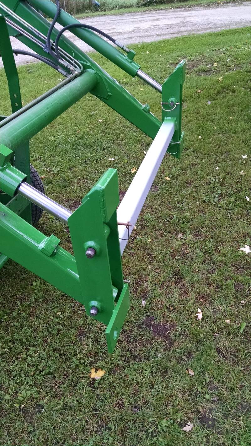

This last is a picture of the loader sided ear assembly with its nose in the pocket and on top of the plate with its pin.

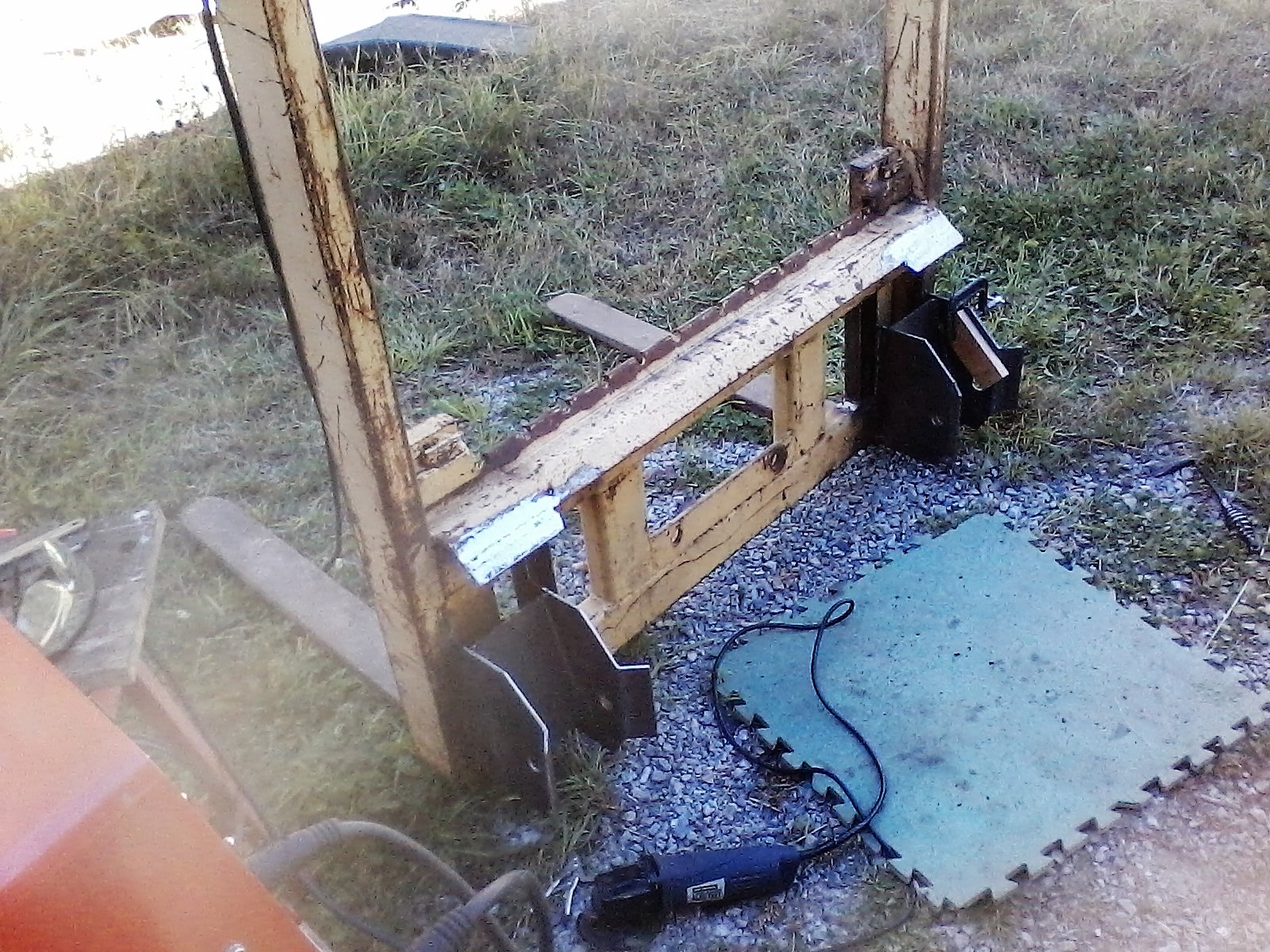

got a couple pictures of the frame ( camera still has a cracked lens so sorry about the quality)pallet mod 8.jpg pallet fork mod. 7 jpg.jpg
also measured the forks and they are the 36 inch by 4 inch wide versions.
started thinking the square edge on the brackets was unneeded and cut an angle into thempallet mod 7.jpg
Hope the pics are helpful of the frame

After getting the dimension for the cross bar, cutting and welding it in (and adding a bit of paint) it's back to the loader for another test fit... gotta love it when a plan comes together.
