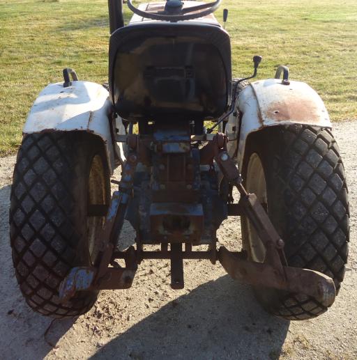

Haven't measured mine yet and doubt if it would help but I do have a question, are you using stabilizers with turnbuckles? That would prevent the arms from getting against the tires. When my stabilizers are too loose that happens to mine when I have an implement attached. I doubt if the length of the arm would change that anyway. When I don't have an implement on the tractor, I use a small chain, strap or bungee cord to hold the lift arms towards each other and keep them from flapping into the tires.
/ Got The S373D!
#26
I will try to get mine measured this weekend.
Mine has turnbuckles on the outside of the arms that attach to the same bar on the tractor that the arms do.

Here's was the setup I had. I'm thinking someone made/screwed with it. It had cat 0 lift arms and the pivot was welded to some angle with the drawbar. Notice the pto guard is missing and won't fit with the "retro". It had the cat 1 pivot rod mounted underneath
I removed all that and put the kubota arms 22 1/2" center eye to eye length. I have a standard cat 1 drawbar from TSC 26".
It clears when down, but half way up it puts the lift arm into the tire
And I want to add that I flipped the rear wheels so I have an additional 3" of clearance on each side. I could put a 21" drawbar on it and that would fix it temporarily, but that doesn't help with my box blade or scraper blade issues...

Here's how it looks with the rear wheels flipped
Left side flipped. Right side standard
I flipped the front wheel to see what it would look like and to see see about putting some front wheel weights. I'm not going to flip the fronts bc it's too wide and I'm just envisioning an axle breaking from the extra stress from the wheel being out so far

I will get you full measurements of mine this weekend. I can tell you they are definitely not straight like those kubota ones you have on there.
/ Got The S373D! #30
I would appreciate it and if you could measure how far it comes back straight off the pivot before it bends outwards. I think I'm going to get some 24" universal arms from TSC and heat them up and bend them out. The kubota arms are really too short to use a standard top link.

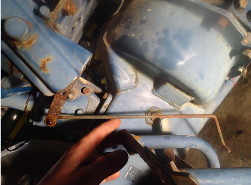

Question on my S373D,
What is this link supposed to attach to/do?
It is attached to the throttle lever assembly.
/ Got The S373D! #32
It probably is intended for the foot throttle. ("Gas pedal")

A couple ideas for getting the 3 point arms to work correctly is reversing the pins on your box blade so they point in or look into the lower links for Yanmar tractors.http://ernies.net/Three_Point_Hitches.htm
Does the throttle lever on the dash move if you pull it? If not, look at the injection pump arm when you pull it. It appears to be a foot throttle. I was going to make one of those for mine too

Freakingstang, what size are your back tires? I'm wondering if they are bigger diameter than stock. The hitch you have is like the one that came on my 1450 and I agree, it's not stock. If your back tires are bigger diameter that might explain why the arms are rubbing on the way up. Just thinking out loud. I can do some measurements too. Later.
/ Got The S373D! #36
They are the stock 9.5-16 bridgestones. I noticed your rear wheels are flipped too

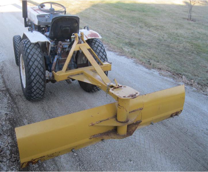

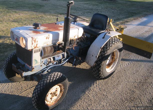

Got to "play" with the Mitsu again today. Borrowed my buddies 6' rear blade and smoothed out the driveway. Going to build a front weight bracket for suitcase weights.
