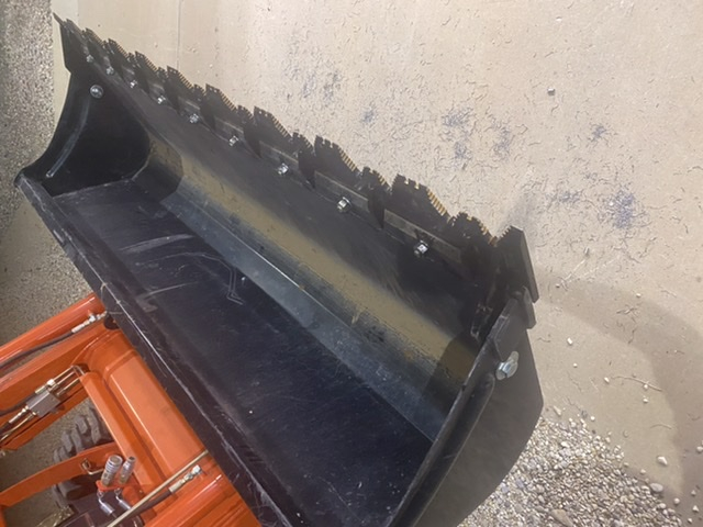

Haven’t had chance to test it out but it looks like it will do the trick. The fit was perfect. I took the measurements per their instructions and it fit like a glove. I didn’t have to beat it in with a hammer but the width was so perfect it required a decent shove to get it between the bucket edges. Install was super easy. Two bolts on each side and nine across the front. You have to drill 3/4” holes for the sides and 5/8” for the front. You definitely don’t want to bump into this thing It is sharp.

Why does this bar need nine bolts across the front edge? Most other such bars only have the two bolts on the side of the bucket. Seems unnecessary to me!

EA guidance is although they include them, they are not mandatory.
My take on it was why not take the extra 30 minutes and add them for strength...for the bucket.

looks 'wicked' !
Wish I knew about those before I bought a flat factory cutting edge for mine. I do like that mine is reversible and uses the factory holes, but I'm sure that wicked one digs into piles and shrubs much better.

Two to mount, the rest on the lip are for a more permanent mount. I also only did the two on the side of the bucket with zero issues.
