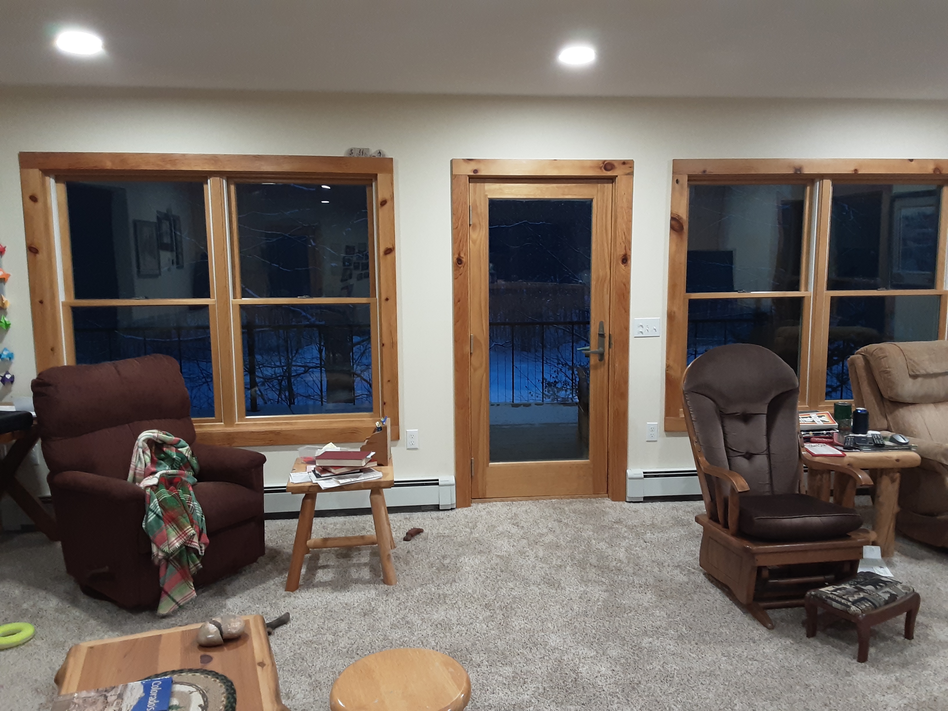

HH, when milling your trim boards for windows and doors, cut opposing boards from a book matched piece. This way you see the same grain pattern on both sides of the doors or windows. I did this when I trimmed our windows and doors with white pine. Cut/sawmill the boards at 10/4 (2 1/4") thick, dry then resaw on bandsaw to 1"+ then plane to final thickness. Now you have a set of book matched boards. But don't tell your guests, see if they recognize what you did. Jon
DANG thats fancy!!!! But pretty cool idea.
   / Got my sawmill up and running!!! TIME TO MILL!!! #67
Here is a picture of our living room windows and door. Jon
