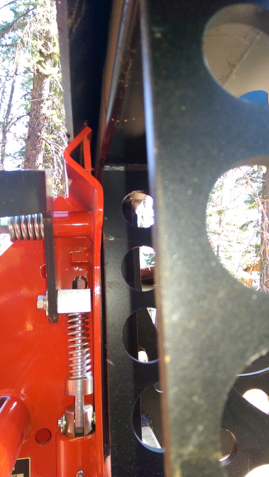

David,
Sent you a pm with thoughts on the SSQA, I think I've inserted a picture of mine here. If not, shoot me your email and I'll email it to you.
Mark
