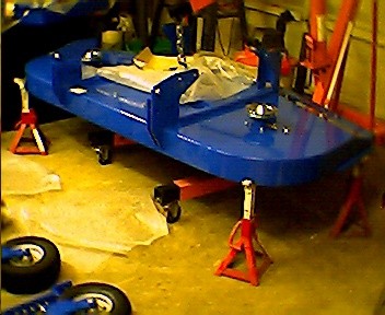

The RFM was very easy to assemble. The instrctions are good and have pretty good pictures. This is one of the first items I have assembled that I did not have to take something apart and try again! You should have no problems. One little tip that helped me is I put the deck on jack stands. This elevates it to a nice working height while sitting and allows easy assembly of the wheels. See attached.
Hope this helps!

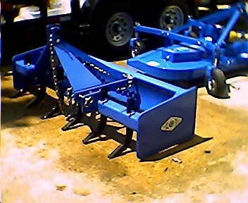

Well I got them all together and here ara a couple of pics. First the box blade. I got the BB3072, in blue of course!
