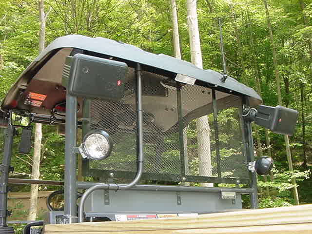

Rear view:
2 outward pointing work lights and a box light on top of the ROPS. The lights (and speakers) fold flat to the rear grate if needed for transport or box loading. (They don’t interfere with the box tilt). The side lights are set to swivel in all directions if/when needed.

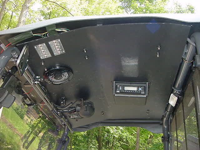

Roof panel view:
Pointing inward into the cabin (mounted on rear of ROPS) is one of the Warn lights I was mentioning to Zeus. (The other is pointed into the cargo box).
On the left side of the roof panel are 2 panels of 5/each toggle switches. These are marine grade switches and panels that I used to control the lights and stuff. Except the 2 center front lights which are on 1 switch, each of the other lights are on their own switch so you only need to turn on the one(s) you need. One switch powers the amp for the stereo, another powers the 12v accessory plug I put in the roof panel for the spotlight.
Everything is fused and so far, no problems turning everything on (although I don’t do it for more than a couple minutes). Wonder if I should fill the cargo box with a bunch of 12V batteries??? /forums/images/graemlins/smile.gif
Pardon the view of the wires going to the front lights. /forums/images/graemlins/blush.gif Ran out of time the other day when installing and didn’t have a chance to clean them up. Actually, what worked nicely for the front lights (since they’re mounted to the roof panel) was a 4-prong trailer wiring harness. That way, to remove the roof panel, I just unplug the harness and don’t have to do any un-wiring for the lights.

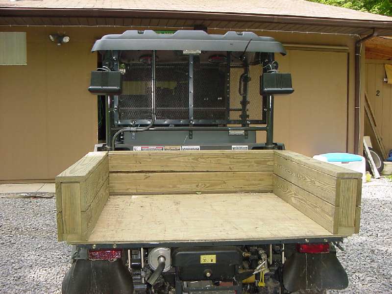

Thanks (I think) for having the most customized RTV you've seen. I can't get anything from my dealer so I decided to make everything myself. (Did you see the split windshield?) Hope the machine doesn't look too much like it's been jerry rigged. /forums/images/graemlins/crazy.gif
When I first got my RTV, I wasn't sure about how well the OEM box would hold up against the wood I wanted to carry. I carry my wood in chunks and bring to the shed for splitting. It would not be unusual for me to carry 1500# at a time. I wasn't sure the metal sides (without a plastic bed liner) would be able to take the impacts of the wood nor was I sure that the sides wouldn't buckle near the back when carrying that much wood with the tailgate open. (I put in 3 ranks as high as I can stack, and stack over the tailgate). The plastic bed liner still isn't available at my dealer...
So... I took the metal sides off and made my own box. (picture attached). The picture shows it awhile ago, prior to building the tailgate (which is a 2x12 hinged to the back).
I did the full assembly of the box off the machine then mounted using lag bolts into the existing holes where the OEM box was mounted.
1/2" pressure treated floor.
2x4" pressure treated framing. (I should take pictures of the insides of the side panels where there's a 2x4 across the bottom with (3) 2x4 vertical supports).
5/4 decking material for the sides and top panels. The top panels lift off and there is storage in the sides.
I'm going to take it off and stain black before winter. Just didn't want to stain over new (wet) pressure treated wood.
I can take more pictures and send/post if you're interested in making one also. Let me know.
