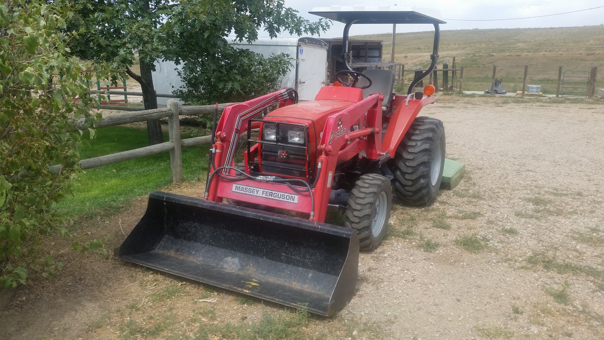

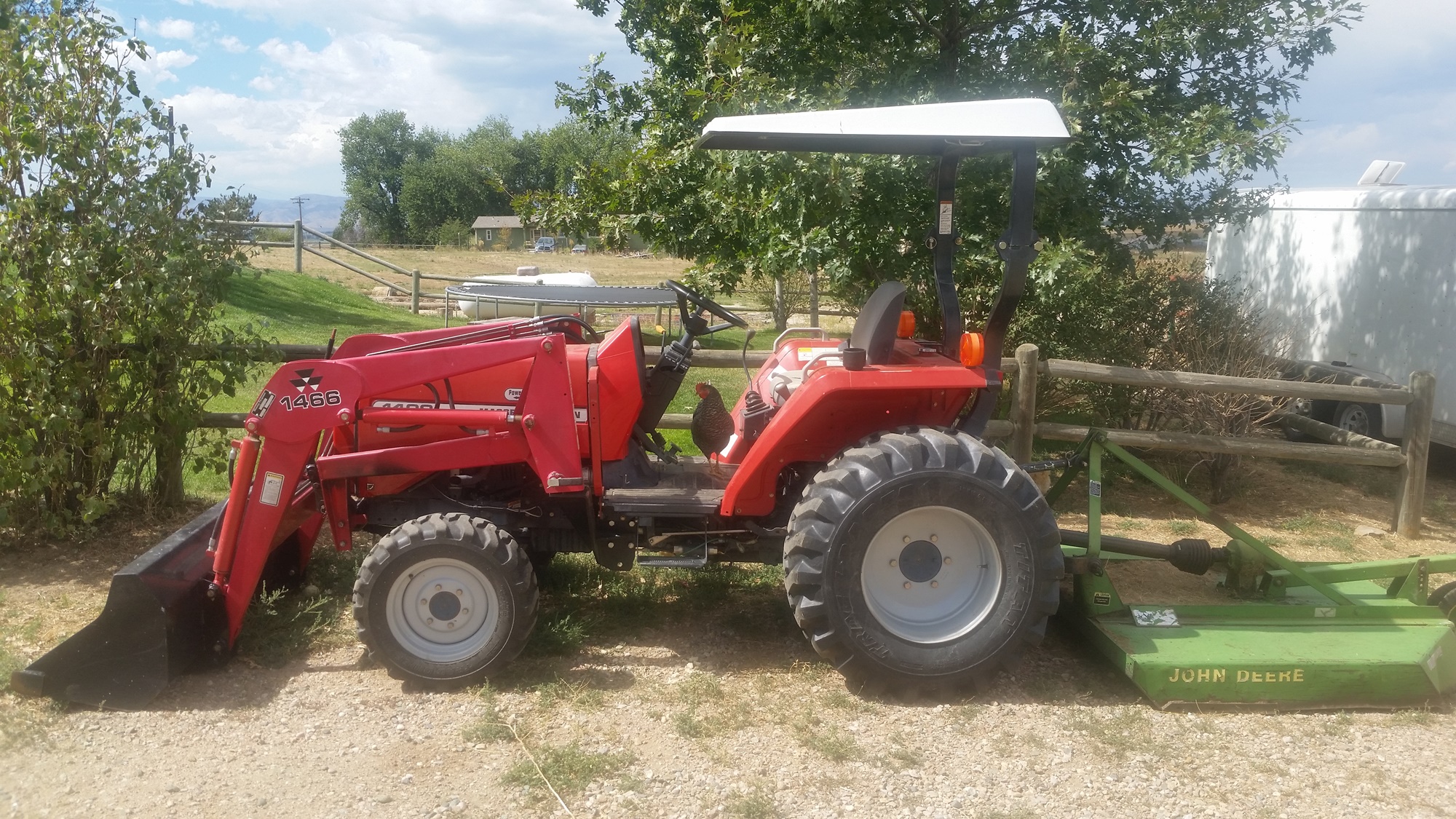

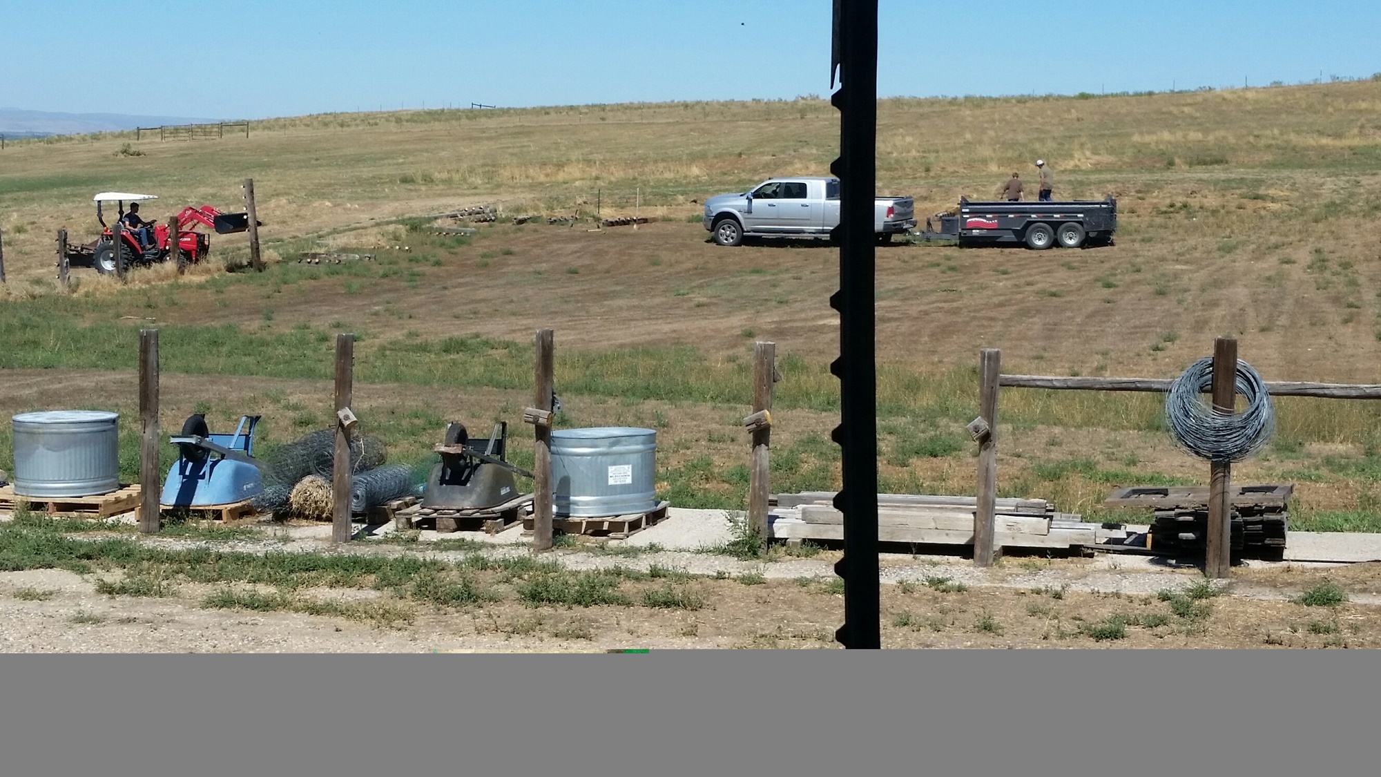

Here's some pics, including an action photo of my Nephew and some of his friends helping me take out some old corrals built of railroad ties.
