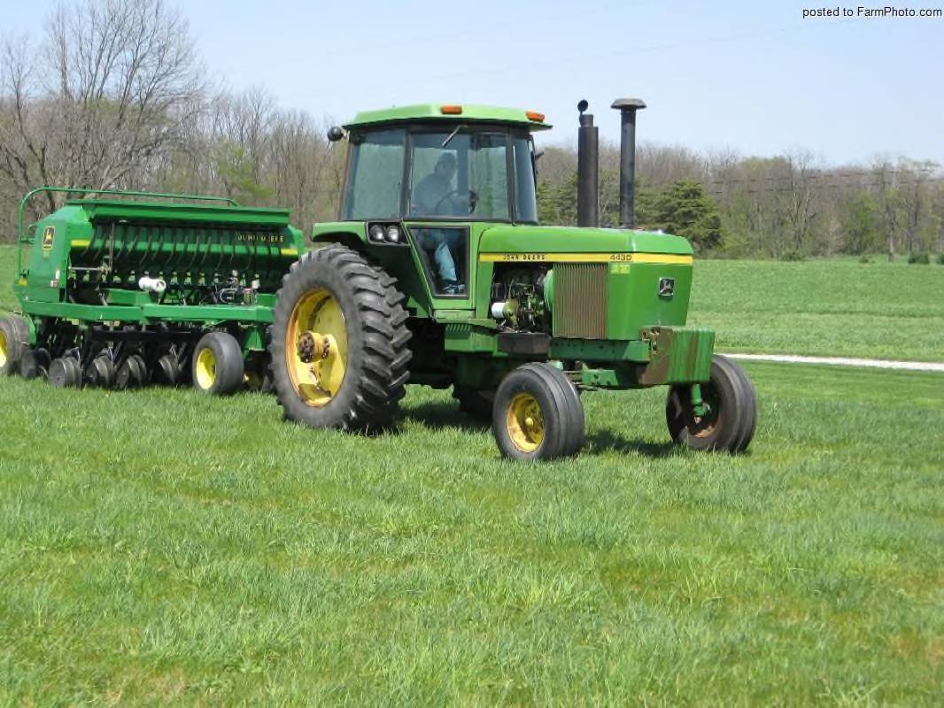

Thanks, Im going to give it a shot. I will have my rear tires loaded by spring so i believe that will help me out a lot. Really thinking of having my neighbor who has his own Welding Business try and make me a 10 bale accumulutor and grapple maybe but the more i think about it i'm thinking i should just cool it make sure things go well next summer. Im self employed and have 3 helpers so i can hire them to help load hay also lol so I think cost would be lower to just try this route first. Hoping we can find buyers for 3.50 a bale of timothy/orchard grass mix.
I'm renting a no till drill early spring to overseed my 10 ac. Should hopfully help things out.
Here is a pic of me no till drilling in some alfalfa in the spring of 2008. A 10ft JD drill. It worked out pretty good. The hay field across the lane I no tilled in alfalfa and orchard grass in 2006. It was soybean stubble and worked a little better. I used oats as a cover crop and made oats hay in July.

Nice I duno what size the one will be i'm renting. They have 2 different sizes and i don't think i can run the bigger one w/ the DK50. I'm just overseeding in grass fields of mostly timothy/orchard grass can i still cut these come June for a First cutting? Do you guys do any spraying before firsrt cut or in between cuttings? This all new to me and i just don't really know lol i'm just hoping i can get a few hundred bales of my 10 ac or so.
