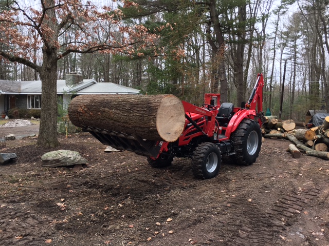

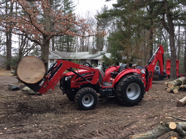

We took down a 2nd growth Red Oak and, me being me, wanted the longest lengths possible. Well, as I was lowering the biggest log (second from the back) in the picture it got stuck in the grapple and rolled forward about a foot. I heard a loud pop, it came from where the loader arms mount to the posts. Other than the sound I cant find anything wrong, loader is still level. Anyone else ever had this happen? From the log weight chart it weights about 5,200 lbs. Maybe I'm just being paranoid.
/ Got a little carried away... #2
I personally would drop the loader off for a full inspection of the main uprights, especially the 'saddles' the pins rest on. Look for tiny stress cracks and fractures. Look down the main beams at all the welds to the subframe. Inspect around all of the bolts mounting the subframe to the tractor (good time to also put a 4' pipe on a breaker bar and put some torque on all the loader mounting bolts).
It is also entirely possible the noise sourced from farther up on the loader and with all of the weight out front, the noise simply sounded farther back at the main pivot/joint.

Loader is rated at 3400 lbs. for some reason this machine is a Pit Bull when it comes to lifting. That was as high as I could lift it in that picture.

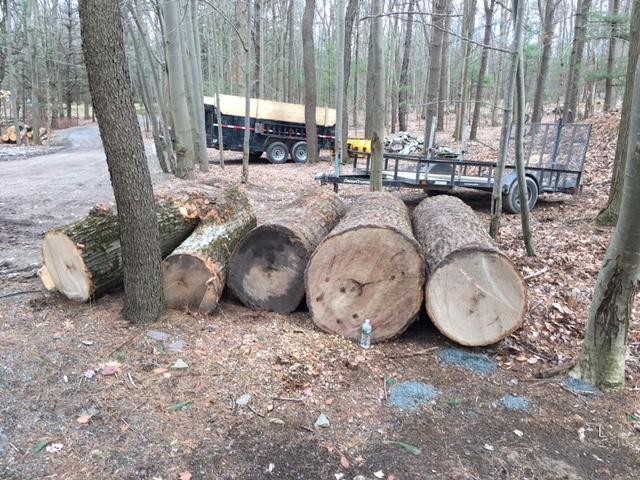

Log was 11'
40" at big end 36" at small so averaged at 38"
Sherrill Tree log weight chart says around 475 lbs, per foot, for Red Oak at that diameter, multiplied by the length, comes to 5225 lbs. could it be lighter, absolutely.
Tractor is a 2555, 55hp Mahindra, rears filled.

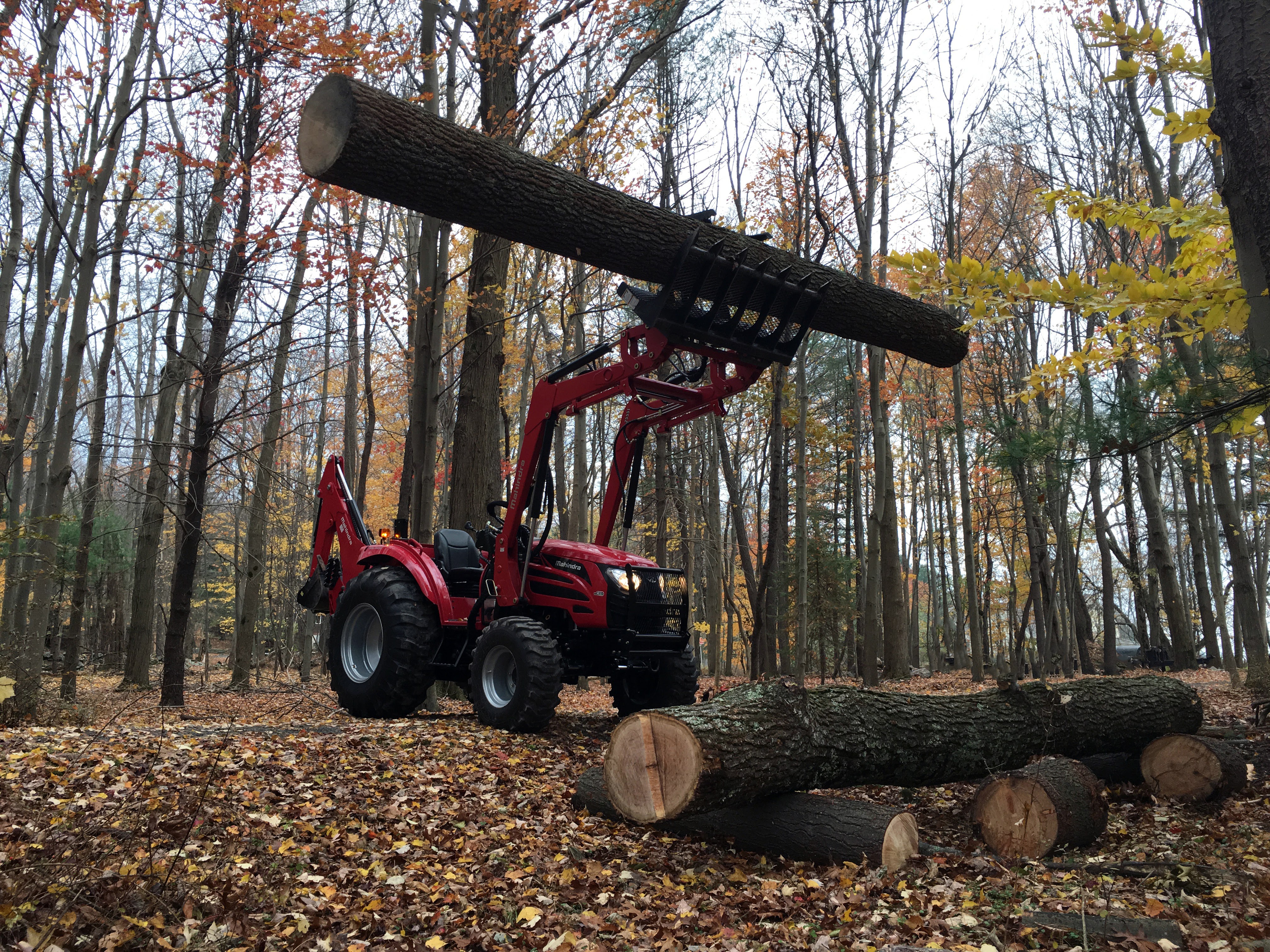

This was a Live Oak around 3800 lbs.
