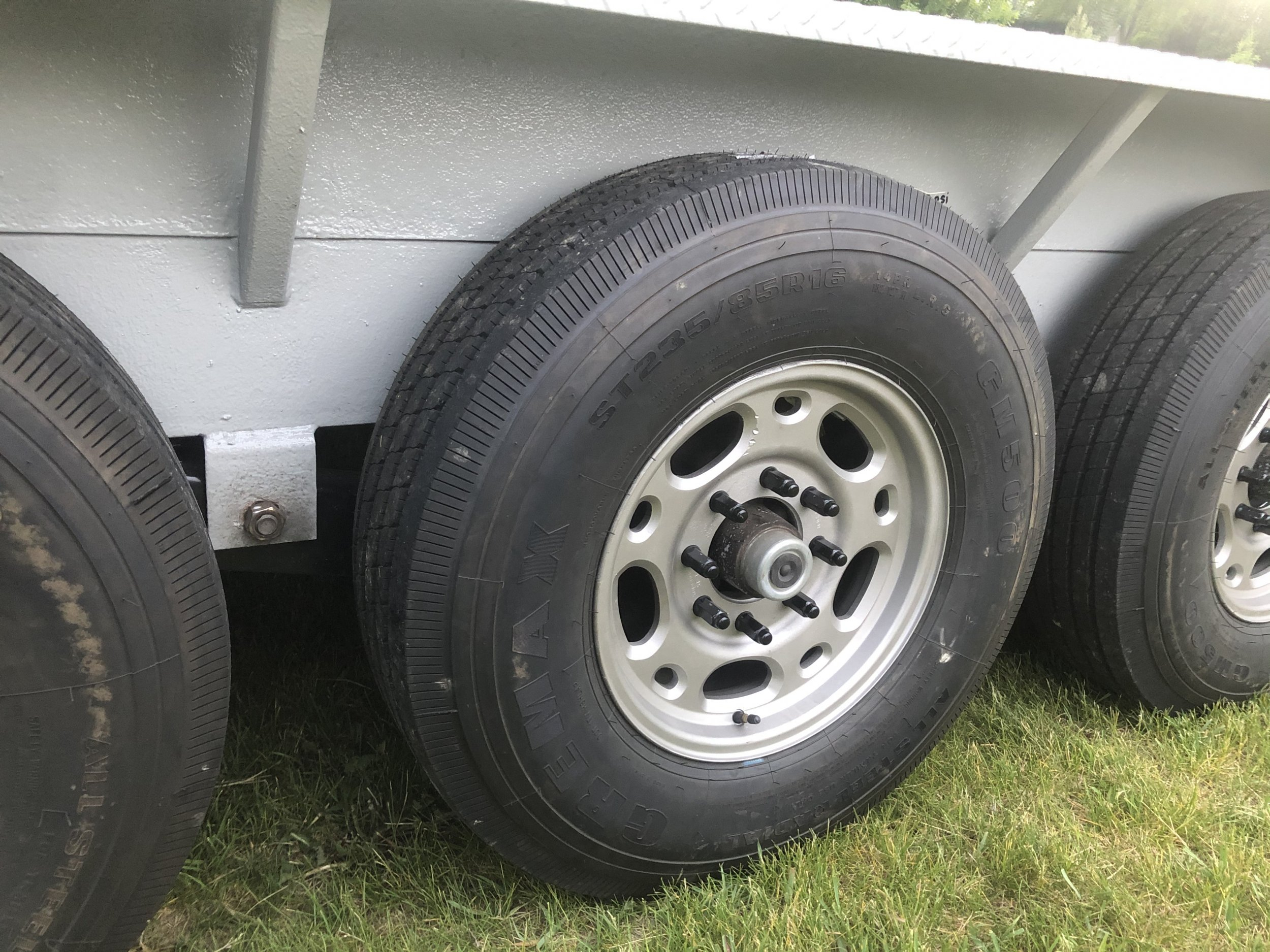

For the tires I went with a 235/85 16 14 ply. Hopefully these won't come apartike the 12 plies. The wheels are PYOs from a 2000 era Chevy/GMC pickup. I sandblasted them and then painted the wheels using a silver appliance epoxy. I really like the long lug nuts; they help conceal the hub.

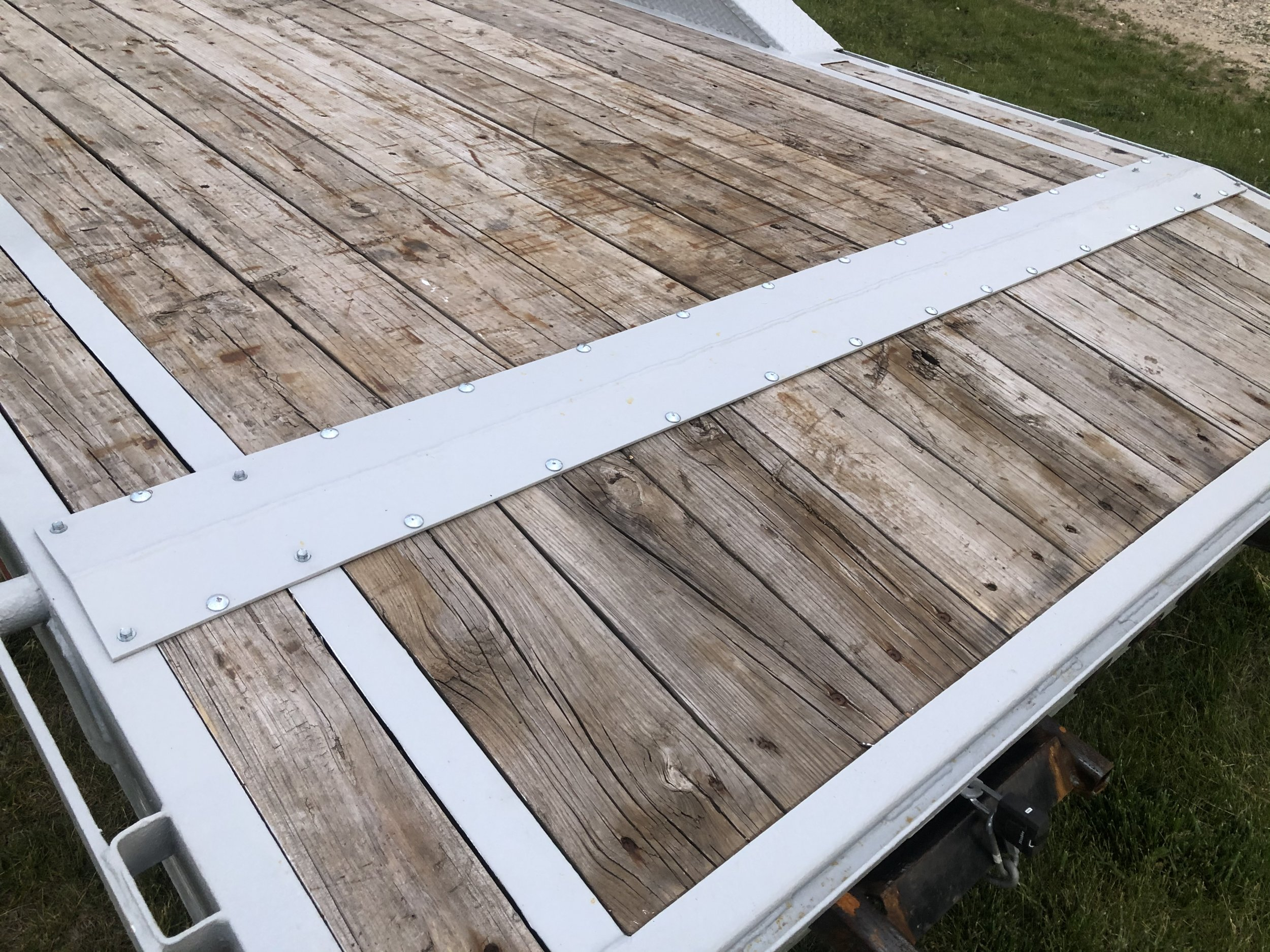

#74
Rebuilt the transition plate at the beaver. The original one was much thinner and something had hooked it causing the plate to bend out of shape. This one is now bolted to every board plus the four rails.

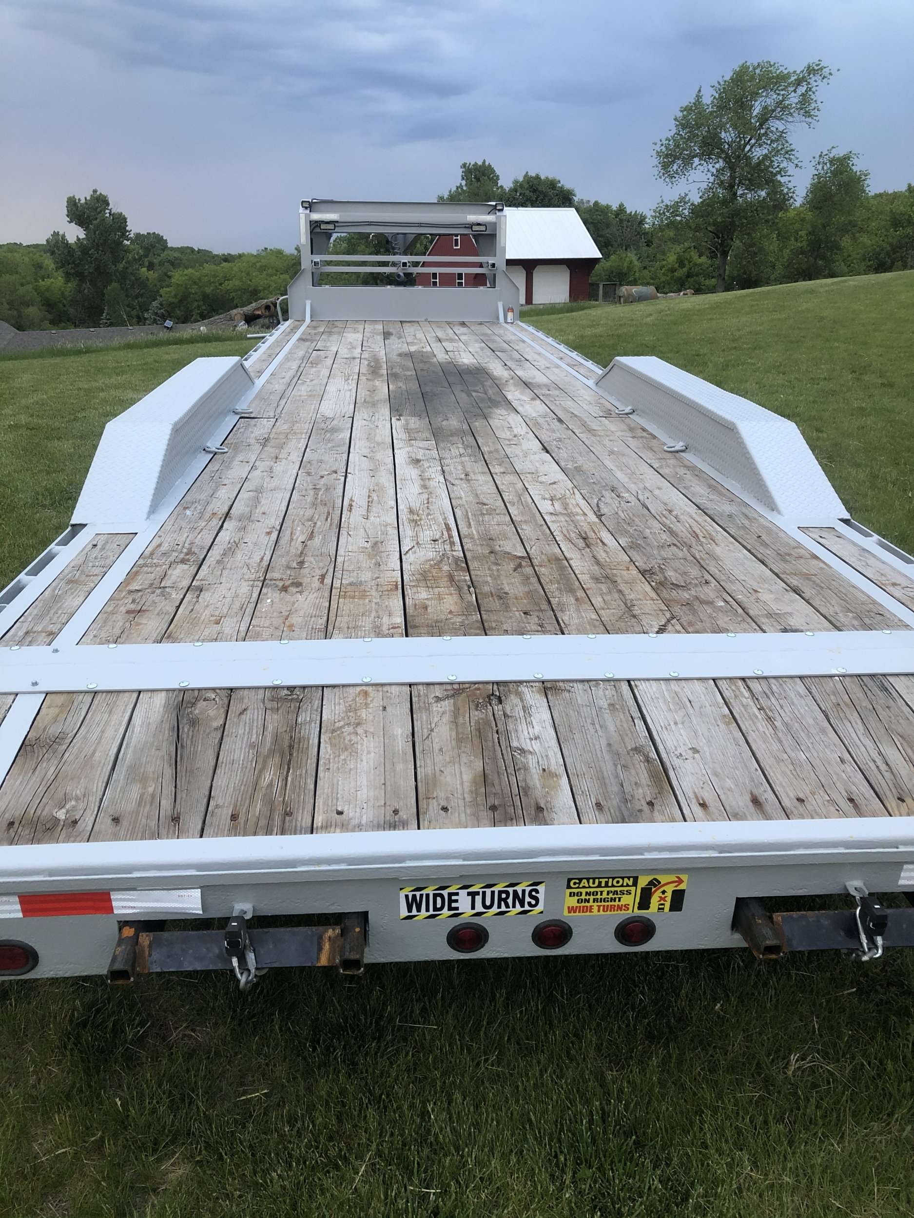

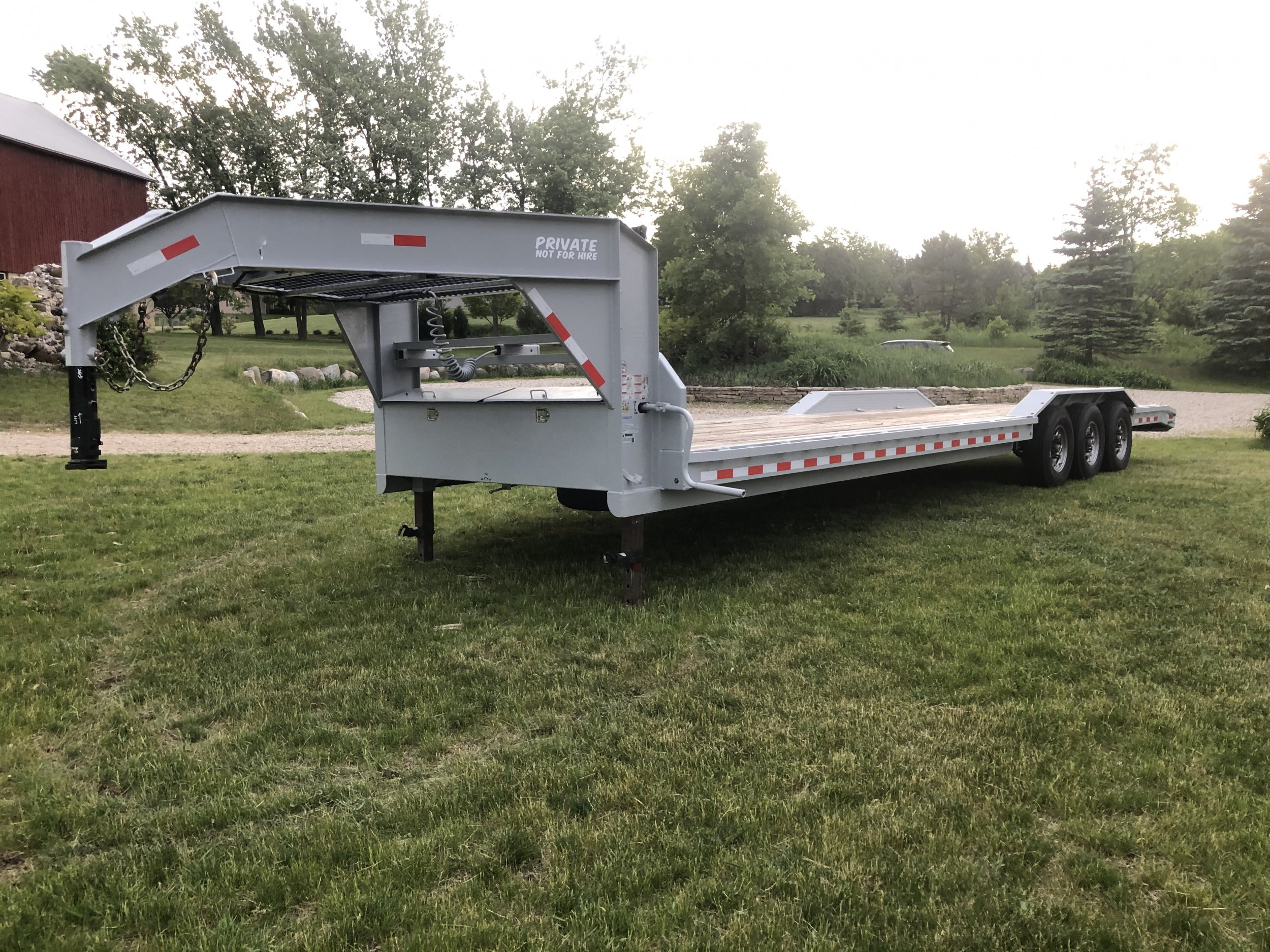

#77
Finished product. For where the project started, I couldn't be happier with the results

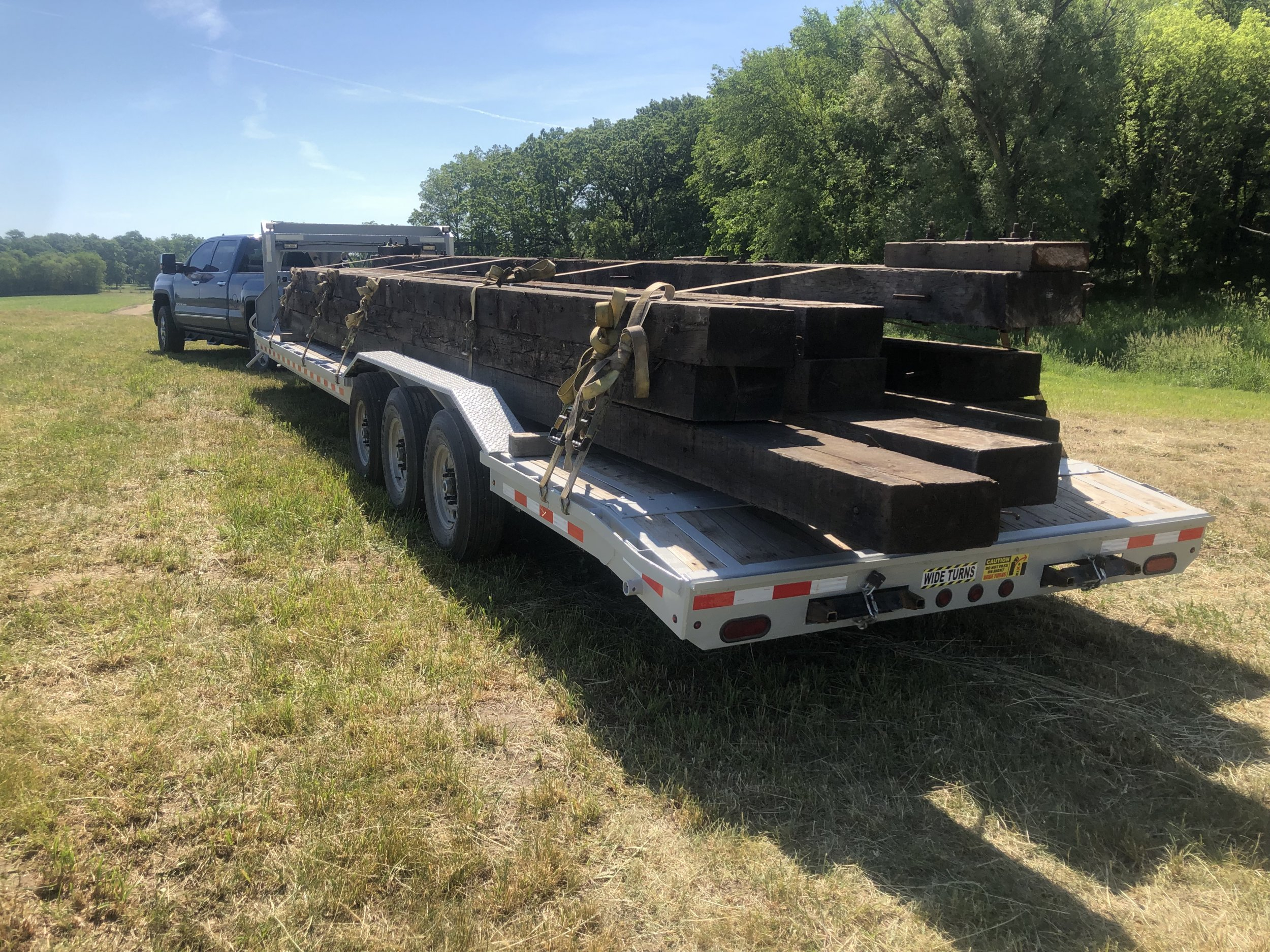

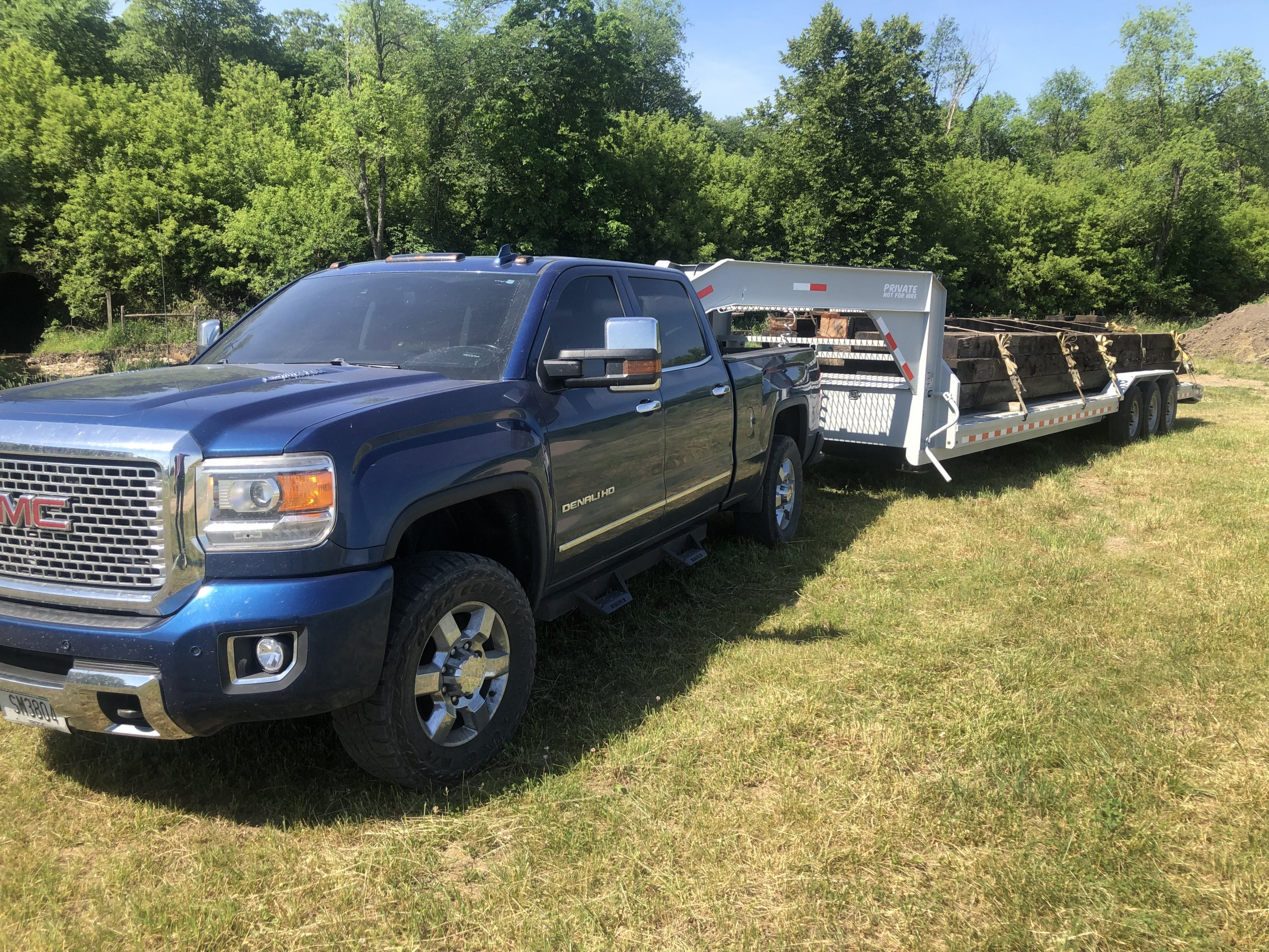

#79
Load test today! Picked up my heaviest load ever. 12 8x16x32' creosote soaked timbers from a railroad trestle. Each one weighs about 1,200 lbs. Trailer handled the load real nice. Didn't want to sway or get squirmy on the bridge approaches. Definitely could tell I had 21,000 behind me, but it felt like the truck could handle more.
