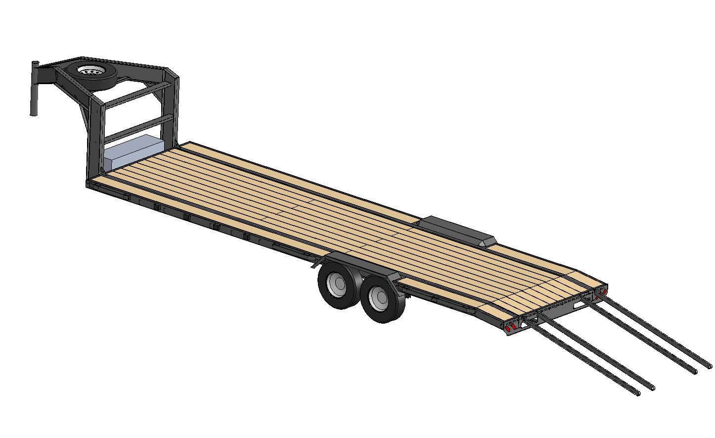

As I was generating an order list of materials, I decided to just go ahead and design the whole trailer in Solidworks, so I wouldn't miss anything. This allowed me to figure out how to fit corners, and to cut things to the right size on the first try. In the end, I kept adding and adding to the model as I went, so basically the whole trailer is in there now. It proved invaluable as I went along to be able to try out a few things without actually cutting metal and making scrap...
Here's the model as it exists today. You can see it's not 100%, but was enough to get the trailer to 100% with a minimum of mistakes: Trailer.JPG

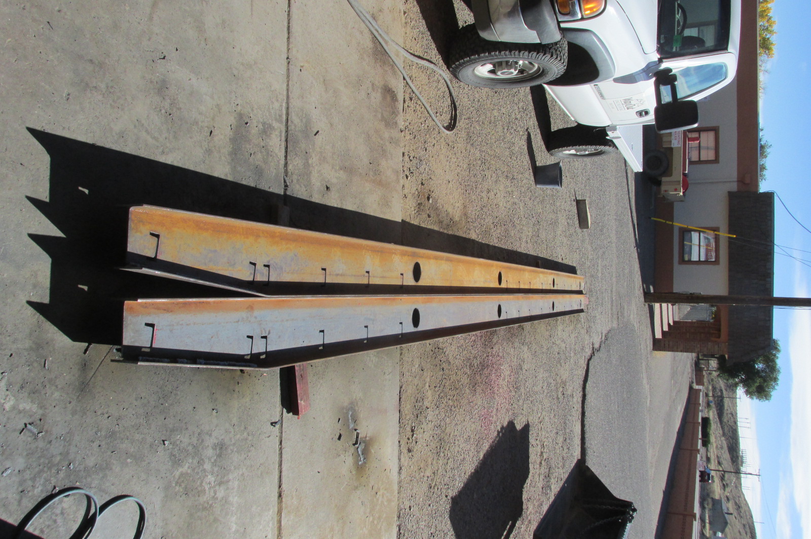

My first order of business was to order about 2400lbs of steel. Two 30' and one 25' I beam for tongue and rails, and lots of 3"x4.1 and 5" channel. Thankfully one of the guys that works in my complex has a gooseneck, and he let me use it to pick up my steel. My trusty 1455 did the unloading, and I stacked it all on the side of the building... This is a 1200lb bundle of channel...

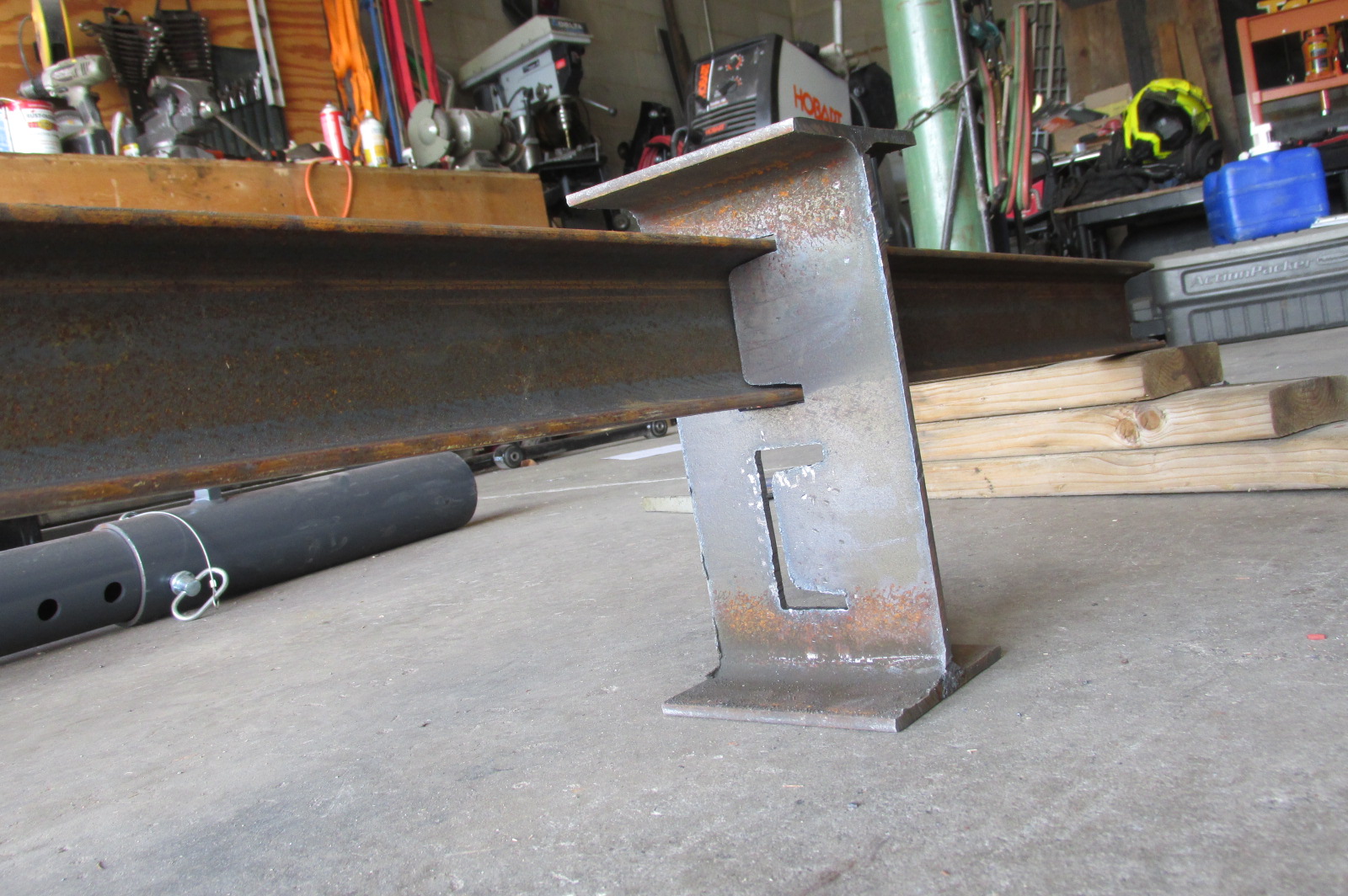

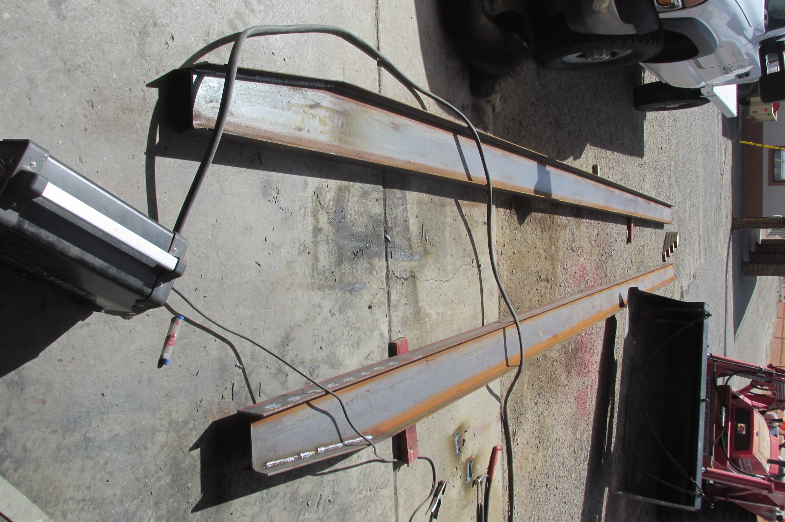

Then it was time to cut the beams to length. The extra 2' was cut off and will be bracing on the tongue, and I carved out a dovetail on each beam and re-welded the top flange.

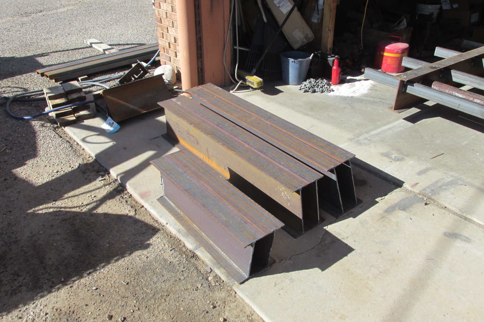

Then I made a template from 1/8" plywood stapled triple thick for notching the beams with my plasma cutter. I've used this technique several times now, and it works well! (Soak the plywood in water a few seconds before each cut if you have to make a lot of them!)
Test cut, yup, channel fits!

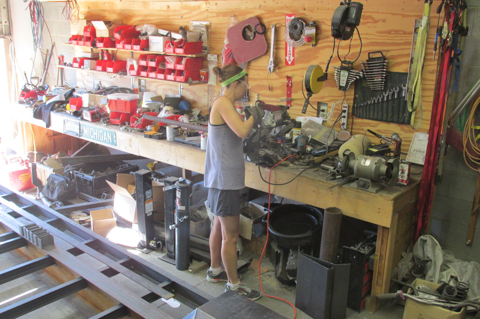

I used 4.5" pipe for the crossmembers to make the trailer torsionally stiffer, without the need to run a "torque tube" down the length of it.
Made another template to cut the 4.5" holes as well, using a 1/8" drill bit for the pivot.
And here's the finished rails.

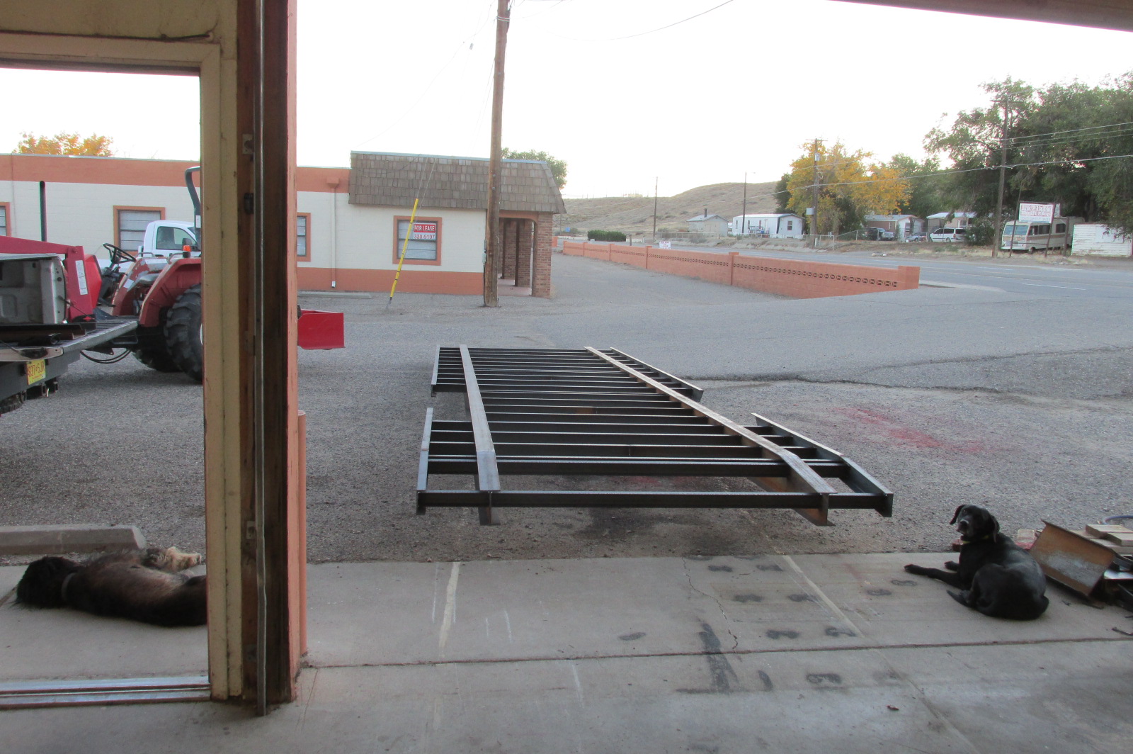

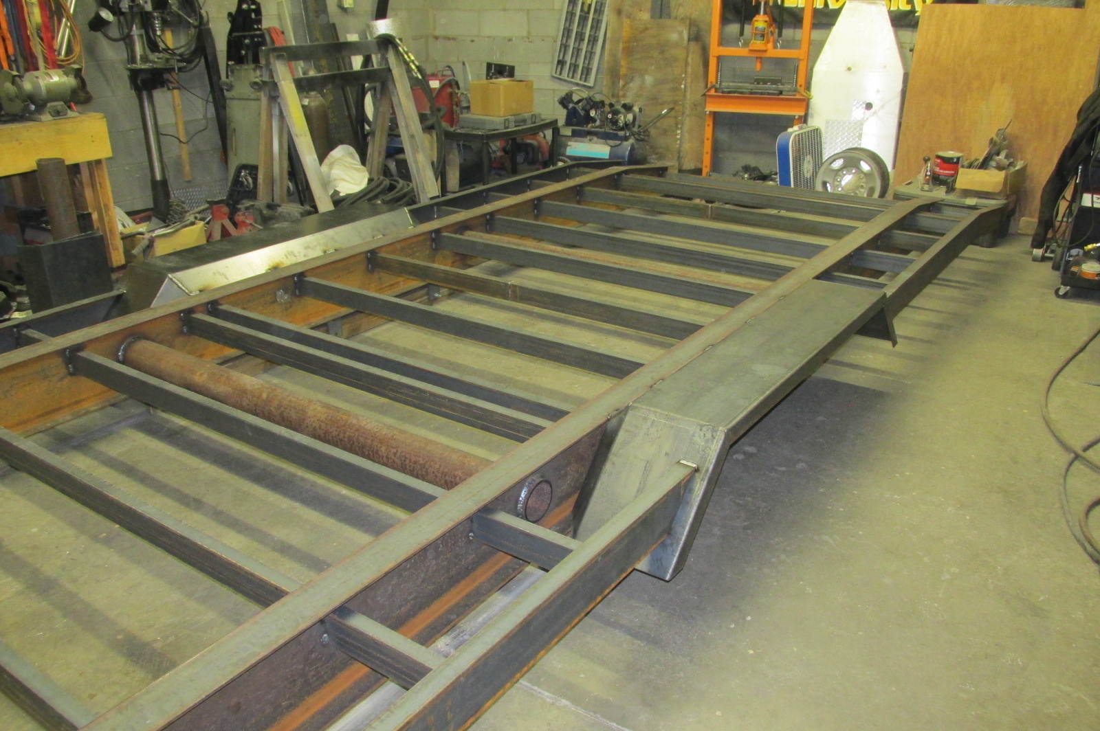

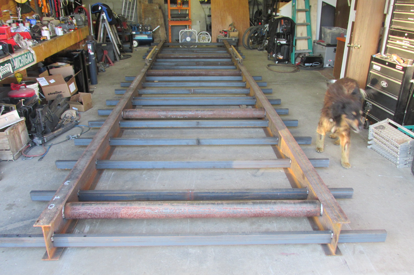

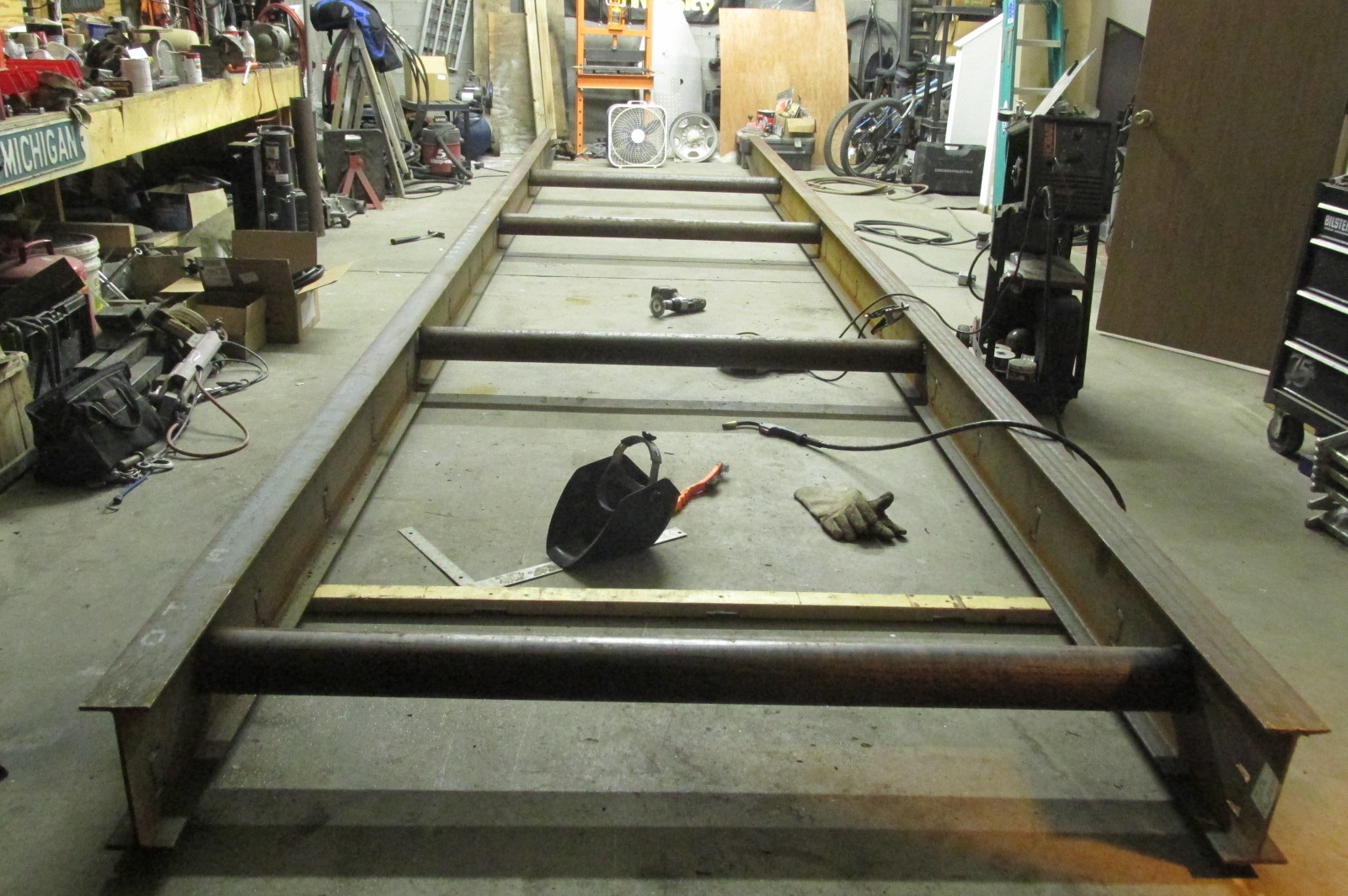

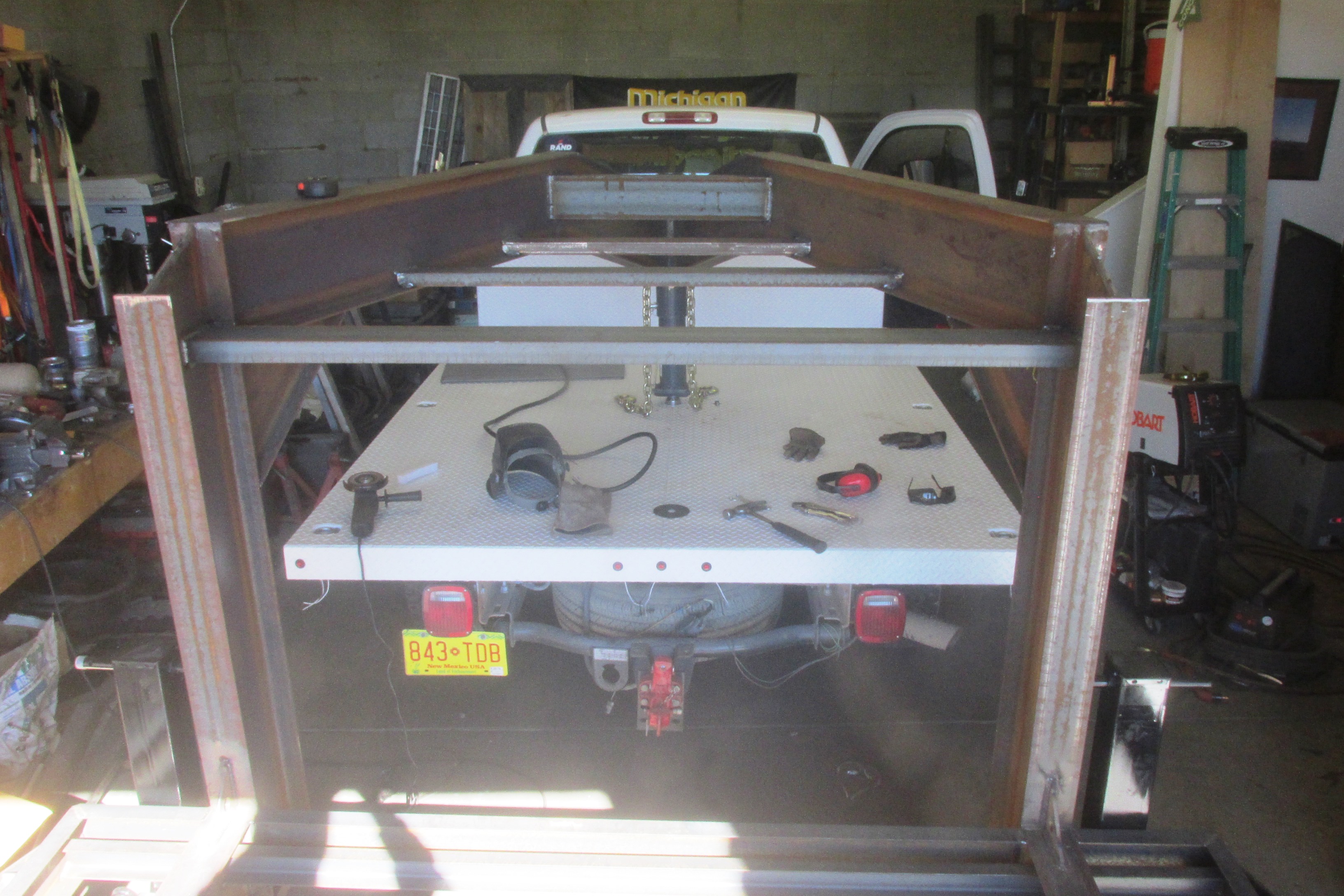

After piercing the beams, I dragged them into the shop to lay out and weld the crossmembers. (My shop is just long enough to fit the bed of the trailer, so I held of as long as possible on welding the tongue on.) I lucked out and the shop floor is really level... The beams were level to each other just laying on the floor, so all I had to do was square it up and weld all the cross-tubes into place. I used tubes for crossmembers to try to get better torsional stiffness than using I-beam or C-channel...

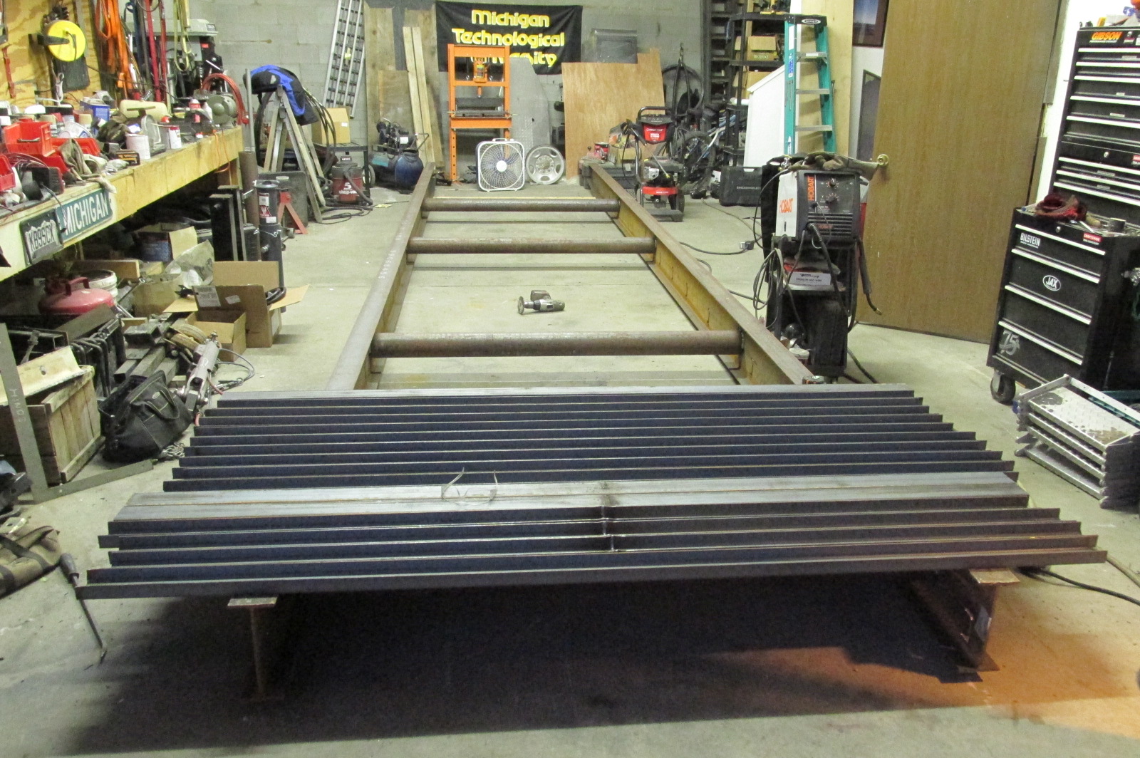

Then I cut a LOT of 3" channel deck supports...
And slid them into place for welding...

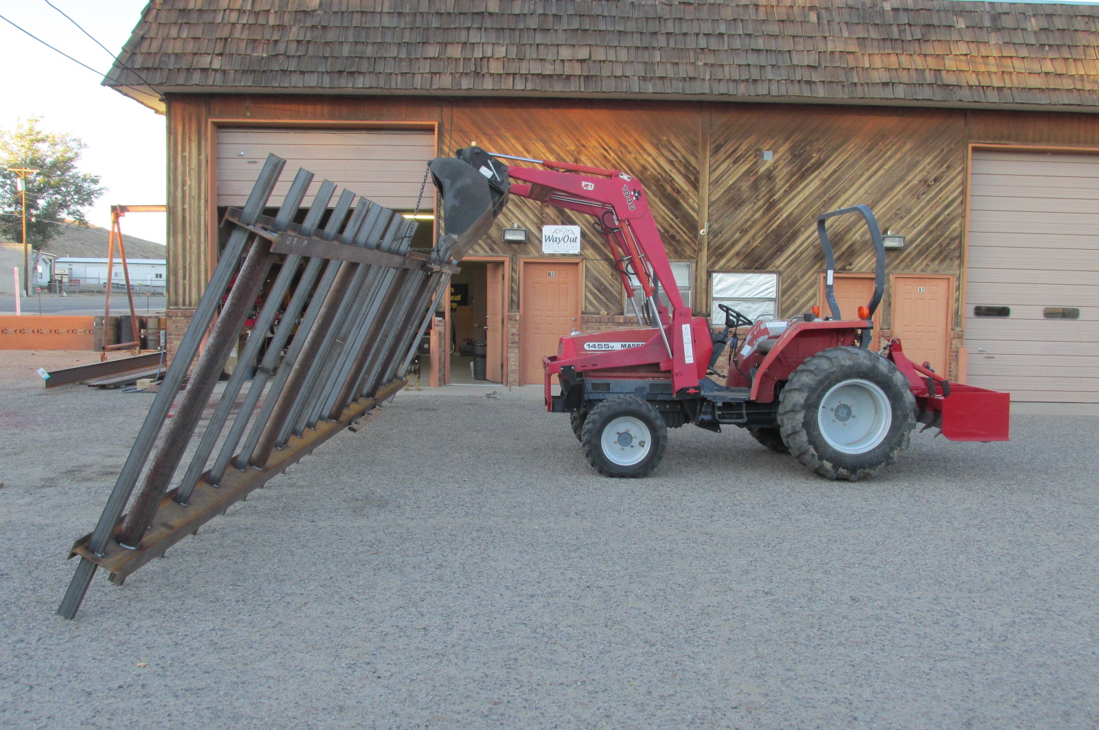

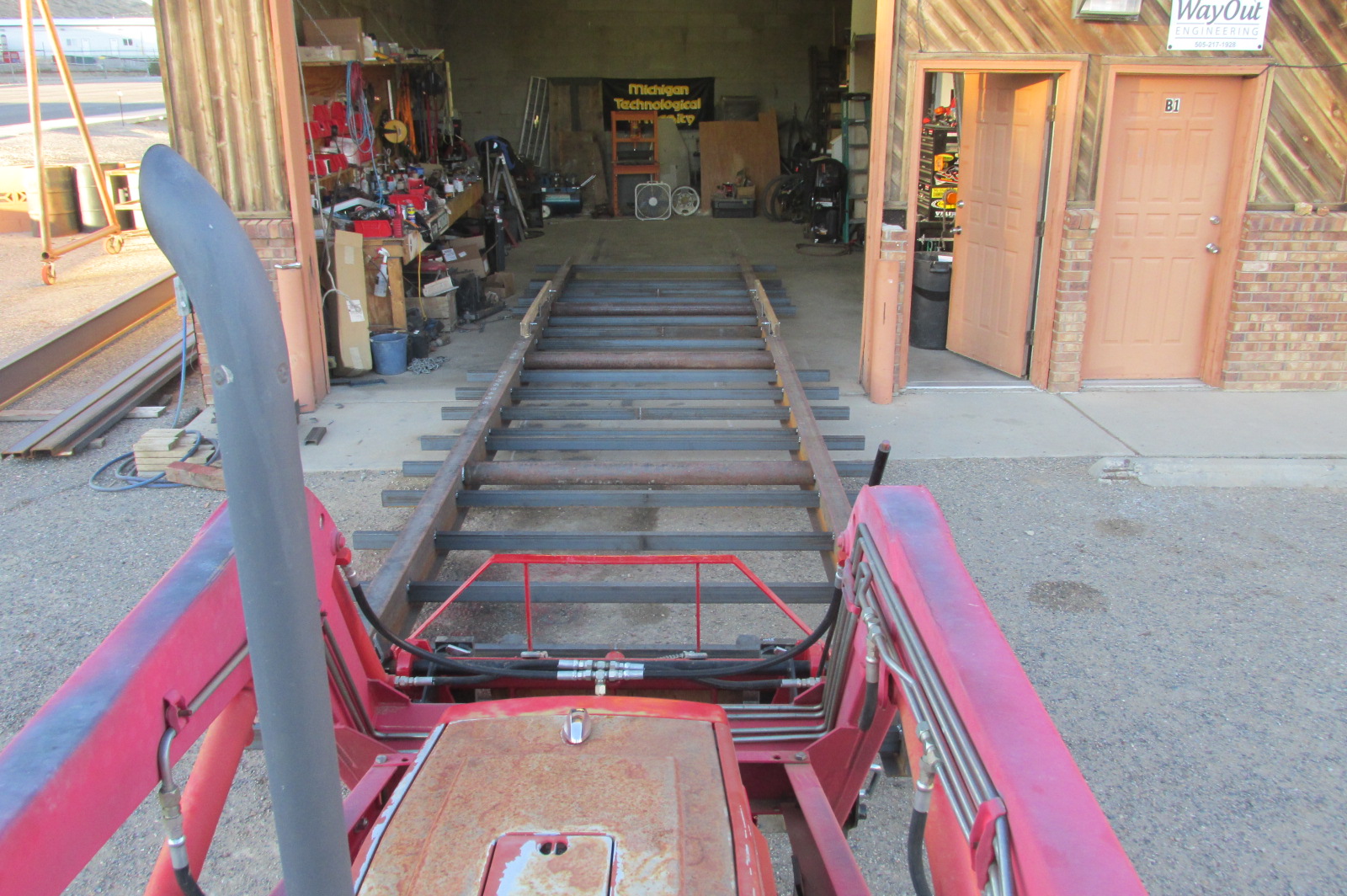

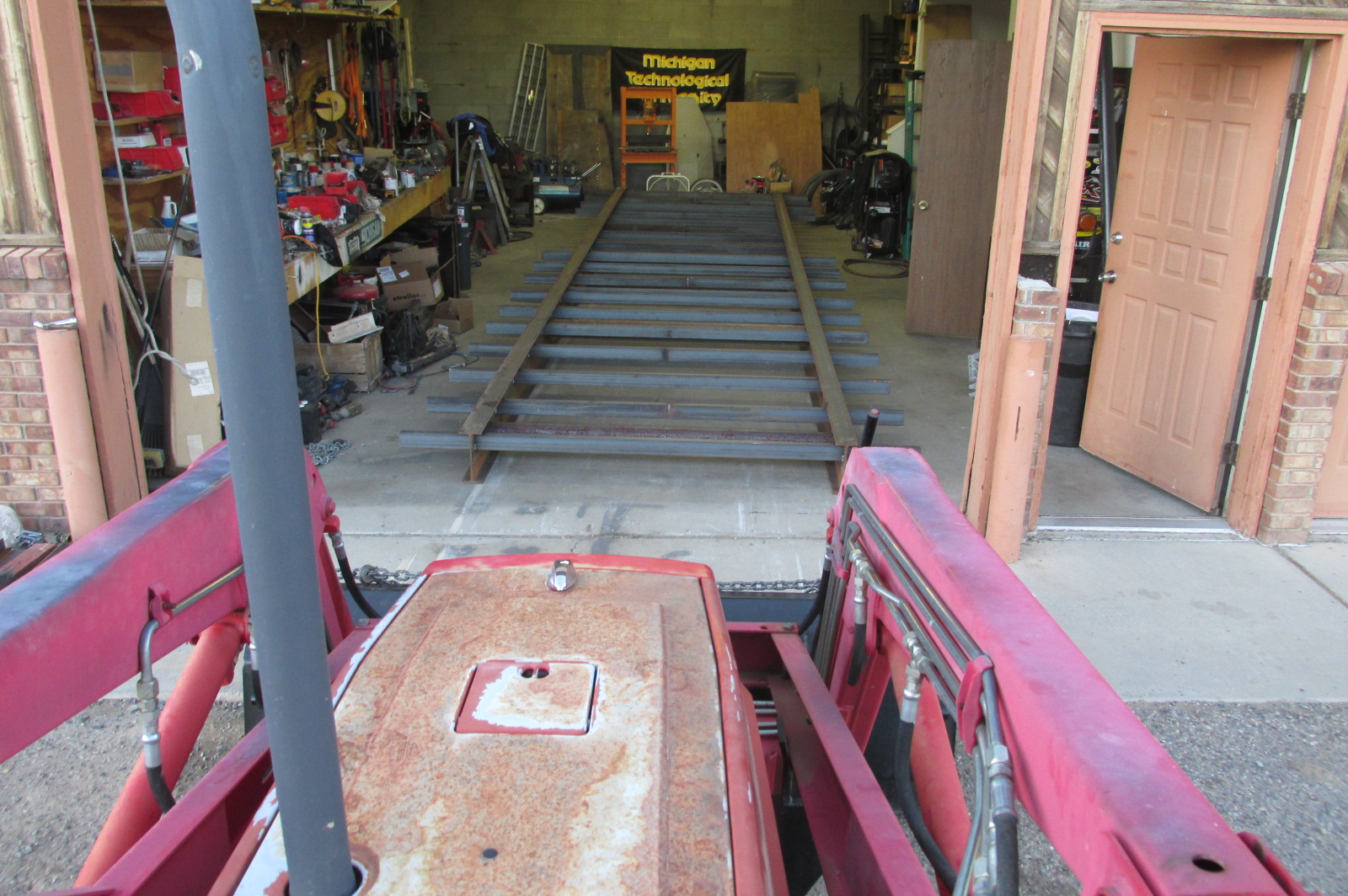

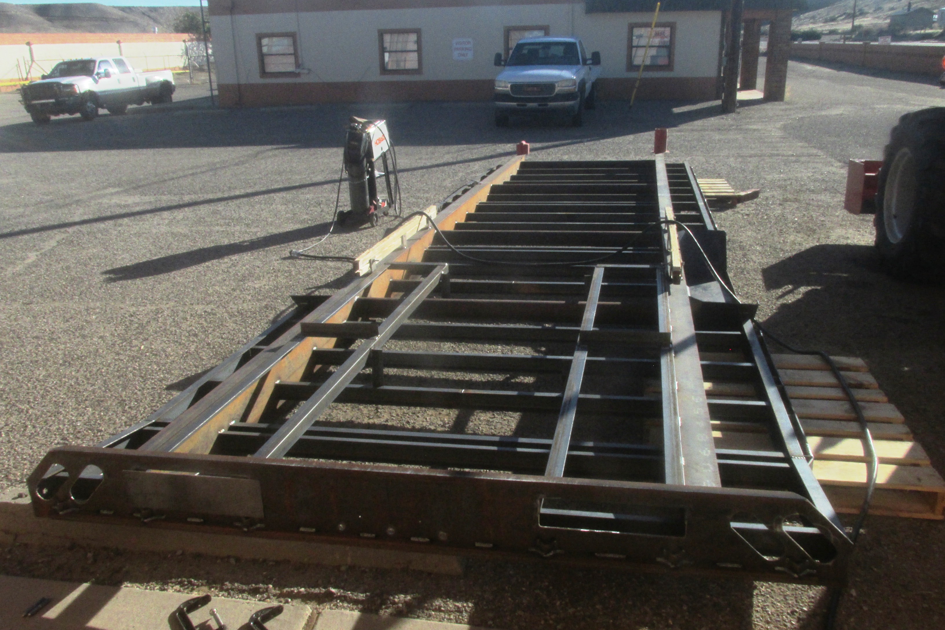

You'll notice that the deck is upside-down at this point. My intention was to weld everything on the bottom, and then only have to flip it once... That didn't quite work out, but it was pretty easy to flip using the tractor loader... You can see that I bolted a chunk of 2x4 into the suspension brackets so it would slide easier once flipped without damaging the brackets.
To flip, drag it out...
Chain it to the bucket hooks and flip it...
Then shove it back in for more welding on the top side...

With the top side all welded, I cut the 5" channel outer sides of the trailer and welded them on too. This is where the model paid off... I was able to cut them to fit the fenders before the fenders even existed... Hmm, only picture at this point was outside. I ended up flipping it again to weld the bottom of the side channel to the deck supports...

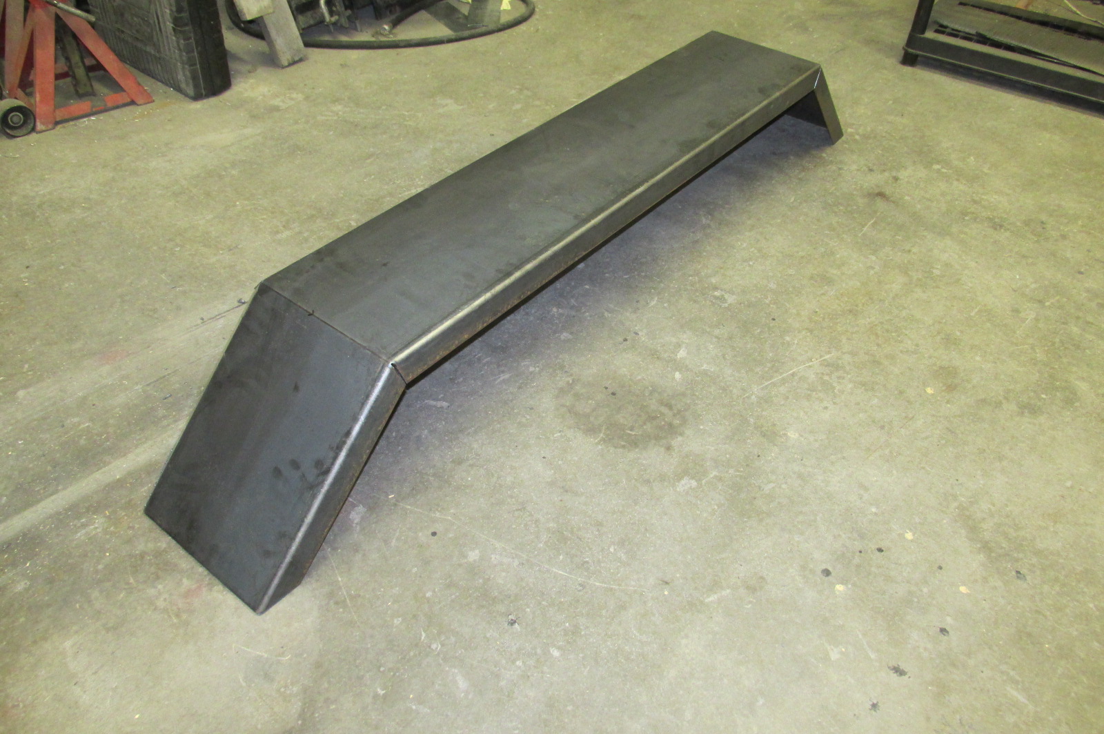

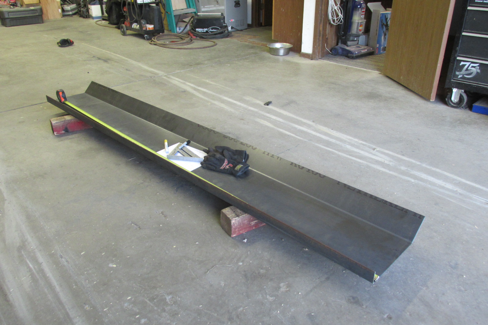

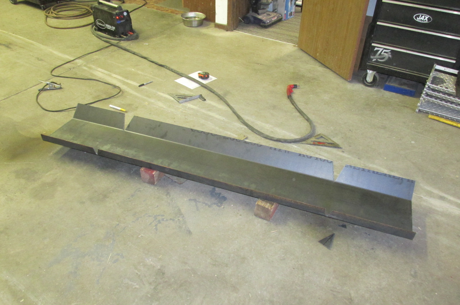

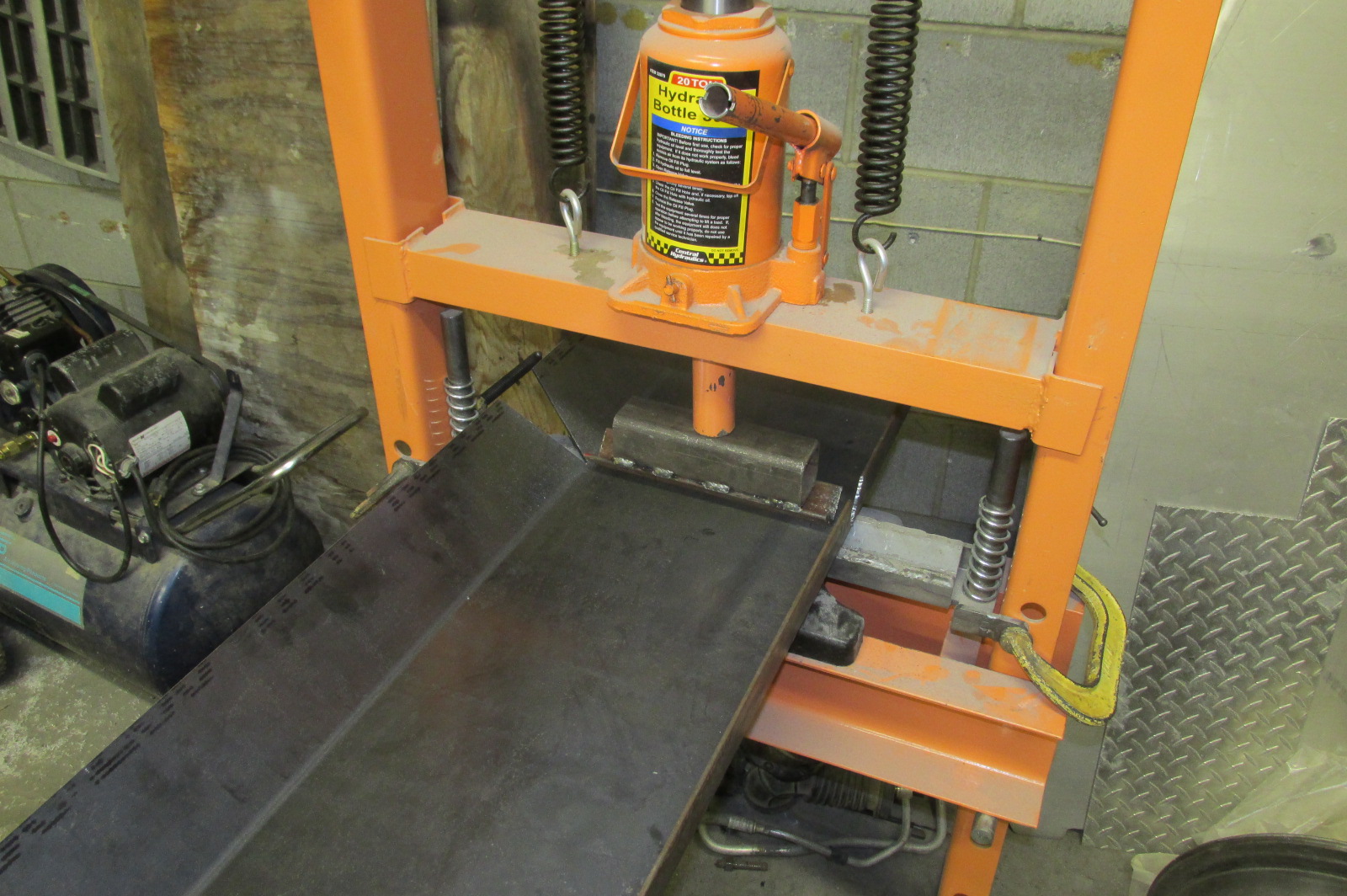

Speaking of fenders... I couldn't find any good options for easy to build fenders, so I ended up getting my local steel supplier to shear and bend some sheet for me... I basically got two 8' sections made, with a 2" 90deg on the outside and a ~4.5" 45deg on the inside...
I notched them where I intended to bend them at 45deg to make the front and rear portion...
Then loaded them into my HF press with SWAG press brake. I made a new short upper part, as my kit has a full width upper part...
And bent both ends to 45deg and welded them up.
Here they are tacked into place, and then stitched to the frame rail and side rails. (Ended up fully welding eventually.)
