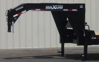

I had another thread on here about gn vs. bumper pull. I have decided on a gooseneck but have a few questions. My local trailer dealer (who is really a good guy, one of the few business people I trust to do things the right way) has a left over GN 27'. He gave me a good deal on it but there are a few things which I would do differently if i ordered a new one. it only has one front jack instead of two. Does that make any real difference? The trailer I am looking at is a Maxxuum 27' deck over with flip up ramps. I will in reality only use the trailer maybe 5-10 times per year. Any reason to spend more and get upgraded axles or two front jacks?

not sure what you are asking about the axels but 1 jack should be fine as long as you do not unhook loaded a lot, the trailer alone probably weighs under 1000 lbs and the jack is probably rated to a min 5k so that's a pretty good ratio.

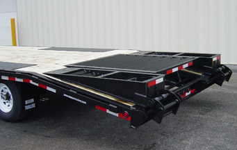

Is this what you have, but with a single jack and 7K axles?
MAXUM Deckover Gooseneck Trailer
I have a single jack on my trailer, never wished it was dual in the 7 years that I have owned it.
