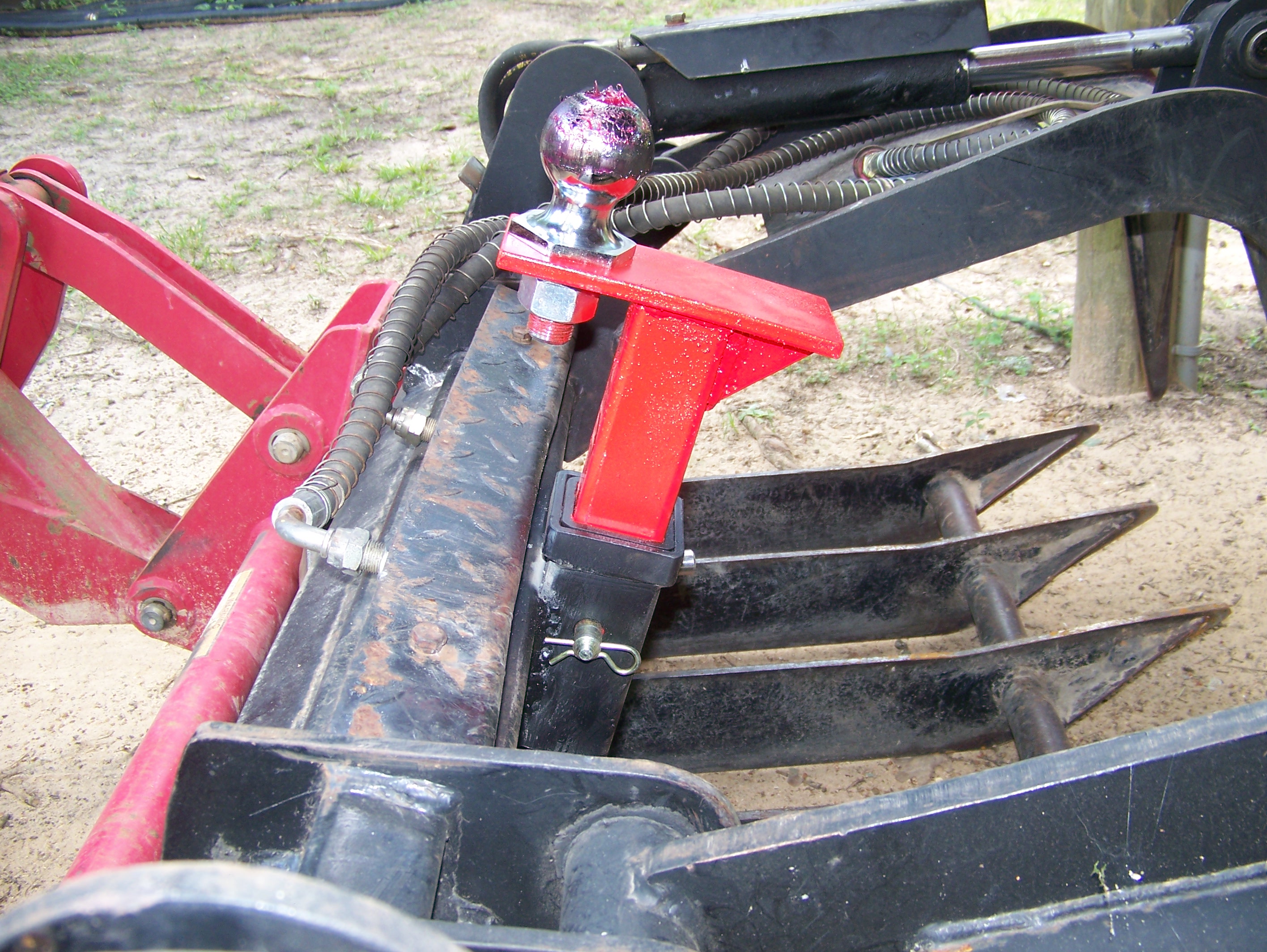

I got tired of swapping my grapple for my loader bucket to move my gooseneck trailer while stacking lumber and moving logs around the sawmill. So I welded a receiver tube to the grapple and welded up 3/8" plate to make a ball mount. 7-7-19 Grapple Ball Mount Detail.jpg

Gooder-un :thumbsup:.

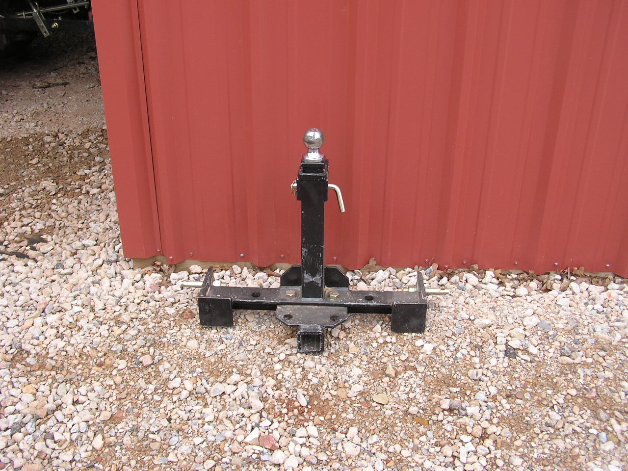

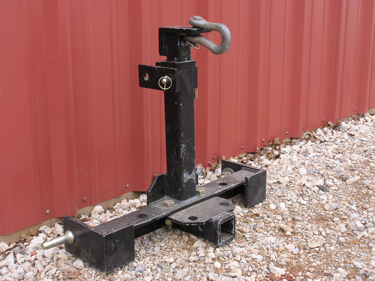

Make one like this for the 3 point and have even more versatility:
Your ball mount will work with it so you can push or pull the gooseneck:
View attachment 617475 View attachment 617477

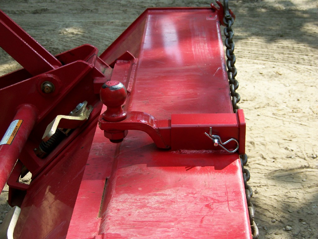

Don't need that with this hitch on the loader bucket. 5-14-07 Ball Mount 3.jpg It would get in the way of my counterweight anyway.12-31-07 Tractor jacks.jpg
Also, that 3 point thingie can't pull me out of being stuck like my counterweight can.:D
While hitched on the loader bucket or the grapple, I can turn the trailer around about 300-310 degrees.:thumbsup: On the 3PH, it would be hitting my rear tires, limiting around 200 degrees turning arc.:(
Also, I don't have to look backwards backing the GN into it's shed. Just drive forward in low low gear with the wheel up and I can stand up if needed.:cool:

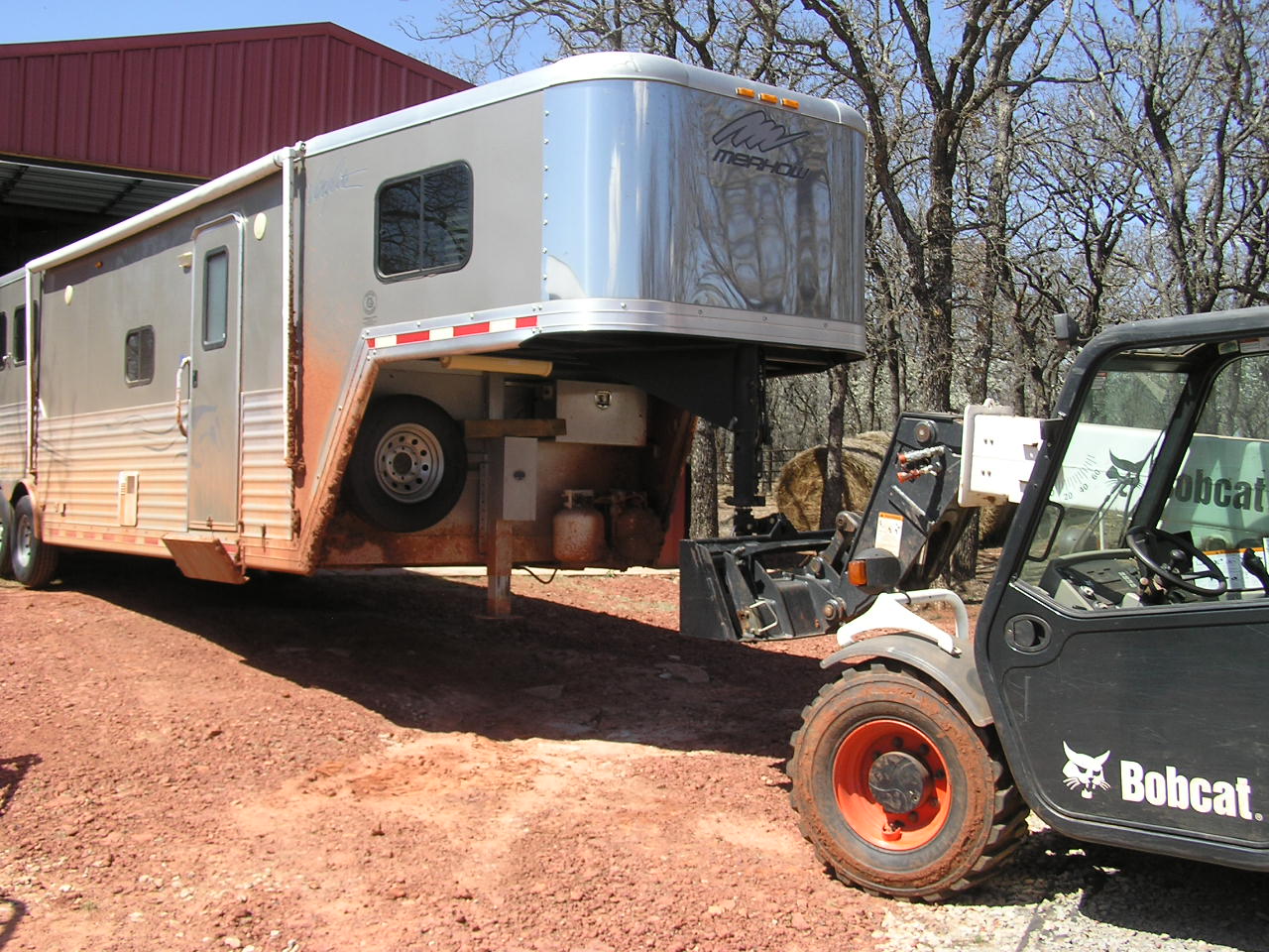

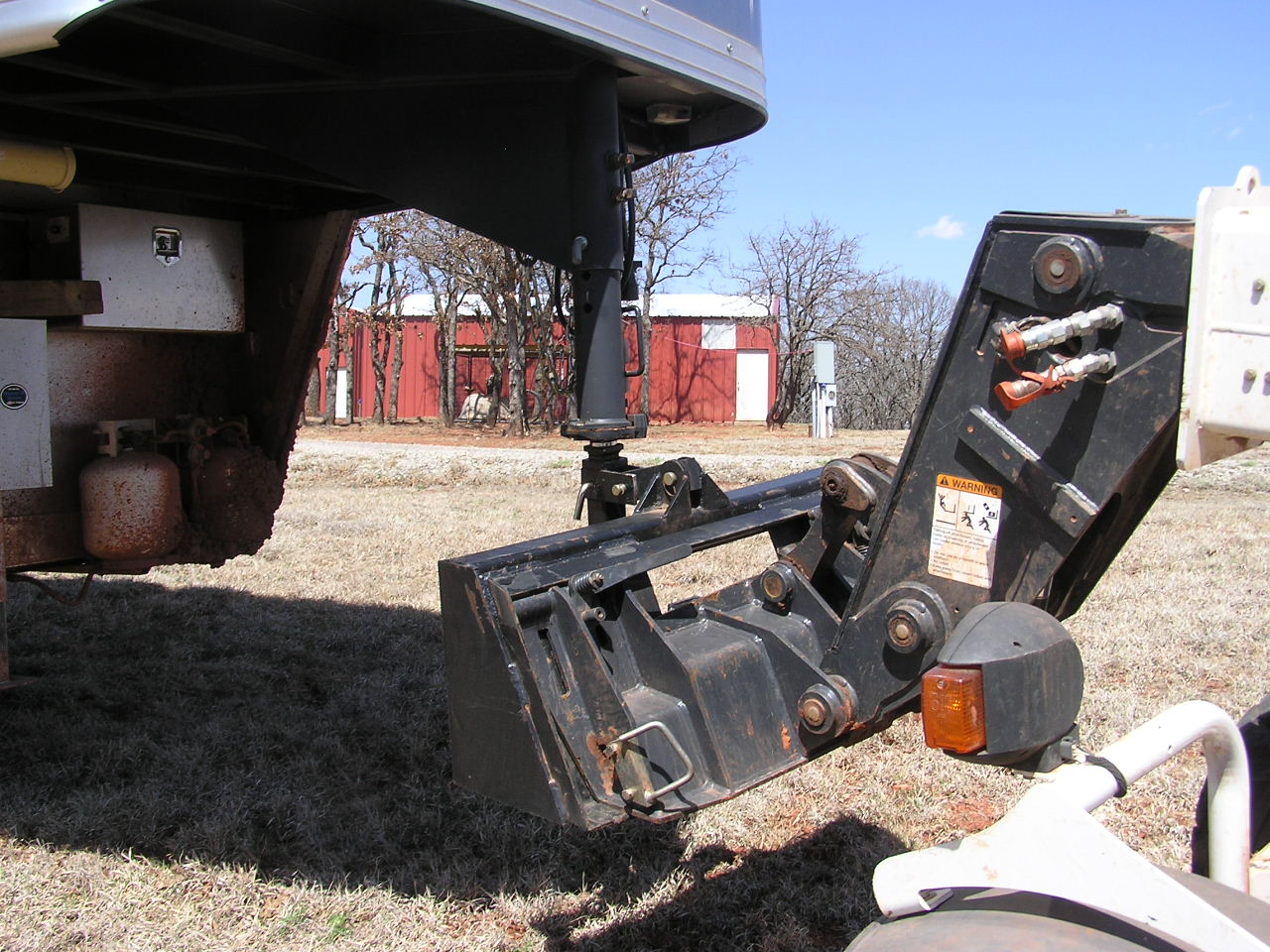

Actually I use it on a 3 point adapter on the SSQA. So am not looking over my shoulder:
