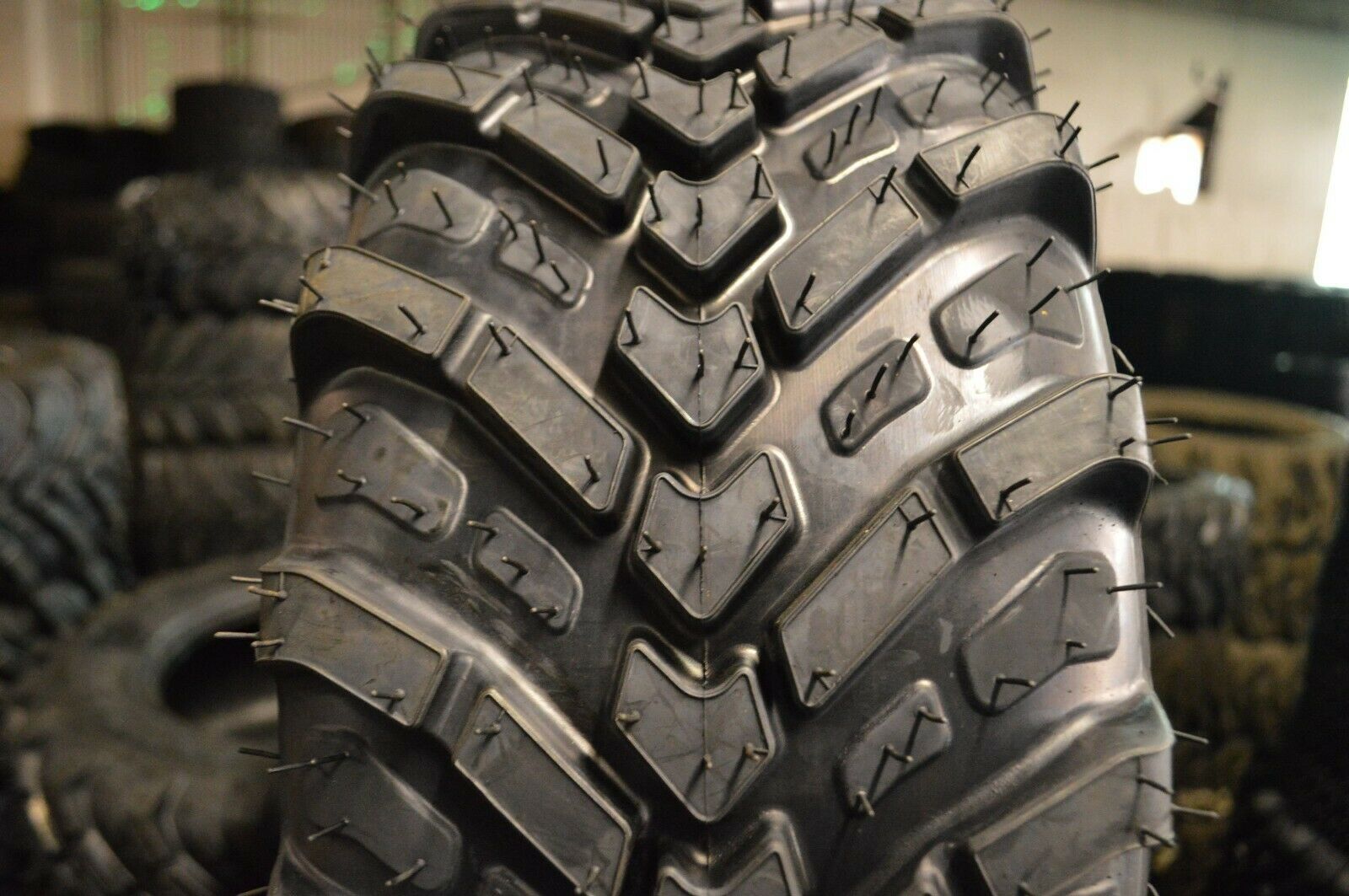

I'm thinking hard about ordering a set of 12.00-16.5's for my MF. I found them on ebay today for $125 a tire new, with the branding buffed off. Pretty sure I know who made them... :)
They're listed as R4 rather than R14, so you have to search around a bit... :)
Hoping for good snow traction, mostly. Hate chaining up, and with my almost bald 10.00's, anything would be an improvement any other time of the year. No turf to tear up, and our clay is hard as a rock in the summer.
The ebay tires are only 4 ply rated, but I don't care, as I run my current 10.00's at 15-18psi anyway for a bit more traction and flotation. With a 12.00 on the narrower 8.25" wheels, I'll probably be fine at 15psi without worry about pushing one off the bead.
The same ebay "store" has Goodyear R4 16.9-24's (also with the name buffed off) for a good price too, so I'll probably do all four at the same time and be done with tires for a good long while. My rears are currently 17.5-24's, so I should end up with a bit more lead than I currently have, which would be nice.
I'll get some pics

BTW, I'll agree that if this tire had the voided lugs present, it would be an excellent snow tire, and pretty good at everything else, except perhaps all out R1 territory.
