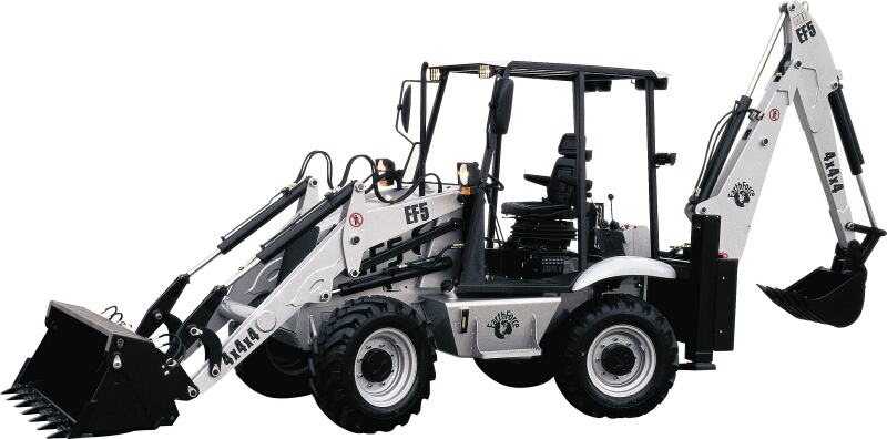

MarkV,
I had some concerns about the vertical stabilizers as well. As with anything, there are tradeoffs and compromises involved - you get a little, you give a little. The most important tradeoff here, to me, basically is: if you want to work tight up against the side of a building, you have to have a vertical stabilizer. Anything else involves slowing down a bit, or being a bit more careful, as opposed to simply "can't be done". So the verticals come out ahead on that basis. As for the stability issue, consider this: What do those huge truck cranes use? Almost all of them use vertical stabilizers. So, it's a matter of knowing how to use what you have to get to do all the jobs you have on your plate. Or, put another way: I'm sure there's less stability there, but I can live with it, in order to be able to do everything I need to do.
The tires are a bit of a concern, too. Here's my take, so far (subject to correction by actual usage, of course /w3tcompact/icons/smile.gif): There's a huge net loss when comparing the rear tires of my Kubota L4310HST to the ones on the EarthForce EF-5. There's a less huge net gain when comparing the front tires of the two machines. BUT, the front tires are more important in the typical usage I put a machine to, because of the loader and bucket contents weight. So that evens things out a bit, or maybe even swings the balance a bit in favor of the EF-5's tires. There are Michelin XM27's available that will fit the EF-5's stock wheels and add about an inch to the width. If actual usage of the EF-5 indicates that the tires are a big liability, I'll have some 20" wheels made and go to 2"-3" wider tires. Been there, done that. /w3tcompact/icons/laugh.gif

<font color=blue>If actual usage of the EF-5 indicates that the tires are a big liability, I'll have some 20" wheels made and go to 2"-3" wider tires. Been there, done that. </font color=blue>
Shoot Mark, this thing will look like a monster truck before you are done./w3tcompact/icons/smile.gif I also see you adding a way to extend the stabilizers out (like the concrete pump rigs) when you don't need to be next to the wall.
Oh heck, Earth Force might as well add you to their R&D department now. They have no idea what they are in for./w3tcompact/icons/smile.gif

Rat - I don't dispute the points you make at all - just the weighting of them, I guess. I agree that transferring power by mechanical means is the most efficient, I'm just becoming less and less convinced of it's practicality as time goes by.
Carraro is a manufacturer of axles, gearboxes, and planetary drives based in Italy. They have a web site, http://www.carraro.com, which for some reason doesn't work for me.
Rexroth is a German-based manufacturer of just about anything and everything in the way of hydraulics that you can think of. Their web site, http://www.boschrexroth-us.com, is pretty informative. They also have a large US presence.
I thought about the EF-6 - it would be nice to have all that power - but it's too heavy to transport comfortably, doesn't have HST and, besides, more isn't always necessary better. I can't believe I just said that... /w3tcompact/icons/laugh.gif Anyway, keep in mind that the EF-5 has way more power than an L48. Changes your perspective a bit, doesn't it?

Rat - Thanks! EarthForce machines are available without the backhoe, but you'd need one heck of a counterweight to make it useful. You can buy a counterweight from EarthForce as a custom order item. No big deal, really - mine is being custom-made, in fact. It takes 6-8 weeks to get one, that's all.
Here's a bit of information that you may find interesting: When I posted my original query about EarthForce machines last December, it was because I'd seen a rental unit in Greensboro, NC and the brochure I got then said a 3-point hitch is available. When I found out that no mechanical PTO was offered, I forgot about it, which is basically where you're at now. (I'm not claiming to be "further evolved" than you are in the tractor purchasing food chain, just telling you the progression of events as they happened for me.) Then, I saw the Power Trac, and I loved it. As you know, my initial reaction was to wonder how their 3-point hitch could be so stupidly designed. They seemed to think it wasn't a big deal, and actually said nobody have ever complained about it. That told me that not many people actually used it. Then I wondered why. Then my engineer friend told me why: that kind of machine doesn't really work well with a 3-point hitch. But he didn't say that should nix the deal, just that I should reconsider my having to have one. That line of thinking naturally progressed to my looking at TLB's, which reminded me of the EarthForce I'd seen last year. The rest you know.
The one area I can think of that I may still really miss the 3-point hitch is in road grading. I like to haul gravel from a stock pile in the bucket (which will now require a lot fewer trips, using the big 1.75 yd bucket!), then spread it with the blade on the back. With the EF-5, I'll have to do those things in separate steps, but I have a feeling I'll really like not having to look over my shoulder all the time while I'm grading, which should also greatly increase the speed I can work at. So, as I said before, it's all about compromises. As long as it seems like I'm gaining something as important, or more so, than what I'm giving up, I'm weighing it all very carefully and trying to keep an open mind. Will there be things I miss about the Kubota after I've used the EF-5 a while? I'm absolutely certain of it. Will I be happier overall with the EF-5? I'm just as certain of that. My Kubota just had too many limitations for what I was doing. I need to be able to move cubes of brick and full pallets of shingles, for example. The EF-5 will. I'm sore for a week and usually end up visiting the chiropractor after drilling a hundred or so holes with the 3-point mounted auger. I'm sure I'll occasionally wish the EF-5 had a 3-point hitch and a mechanical PTO, but when I weigh the things I'm getting instead, I think I'll be happy to exchange them.

Darin - I assume your question was directed to me, not to Rat, since he probably changes his underwear, I mean mind, a lot less frequently than I do. /w3tcompact/icons/laugh.gif
The retail base cost of an EF-5 is about $40k. Crab steering adds $2k, a 4-in-1 bucket $2k, sideshift backhoe $2k, full blown remote hydraulics and quick attaches front and rear another $2k, approximately.
As for my uses, I do a lot of road grading, a lot of clearing & brush cutting, a lot of landscaping. The landscaping jobs I do involve grading, leveling, stump removal, preparing grass seed beds, putting in decorative ponds, placing decorative stones (as in boulders), hauling lots of mulch, organic material (as in manure), and fill, and digging lots and lots and lots of holes for trees and shrubs. And then there's the usual stuff necessary to maintain 150 acres and 2 miles of driveway.

Rat - I agree - the EarthForce acquisition by I-R and it's affiliation with the Bobcat name is a huge success for the product line. It's also a huge bonus for the typical equipment dealer who manages to acquire the opportunity to represent the EarthForce line. Before the EarthForce, there was very little alternative to skid steers in the light to medium duty construction equipment market. There's really very little competition in this size class, and none at this price point, as far as I can see.
The EarthForce seems to be pretty much exactly what I was looking for, though I had to make considerable adjustment in my preferred "form factor". As I've said, I really wanted to stay with the removeable backhoe/three point hitch capable type of machine, but it just doesn't scale well.
Now, on the other hand, the ability to put skid steer type implements on the front, and mini-excavator style implements on the back, simultaneously, is what swung the deal for me. My EF-5 is going to be the first one to have the hydraulic version of the skid steer-style quick-attach. It was strange. It just so happened that when I was visiting the distribution center in SC, the president of the Superstav, the man who created the company in the first place, just happened to be there. I told him I thought they really needed the hydraulic quick-attach, and he said "done". And so it is, it seems. I also told him I thought it needed power tilt, and that's being worked on, he said. There's already an attachment that will accomplish this, but it would be nice to have it built in.
I was extremely impressed with the quality of the hydraulic controls. The loader, 4-in-1, and backhoe joysticks are as smooth as any I've ever used, truly professional quality.
Tractive power was excellent, I thought. My test was to push the empty machine up against the loading dock. At about half throttle, I was able to creep all four tires on rough concrete, not asphalt. Of course, the real test will be in actual usage, but I'll be able to report on that before too long.
I think what I'm looking forward to most of all, though, is being able to perform most work looking forward instead of over my shoulder all day long.

Hoghead - I think there are a couple of relevant factors, as far as parts pricing is concerned. I expect the pricing of the cylinder parts and frame to be higher than typical tractor prices, both because it's built in the Czech Republic, and because construction equipment is a lot more expensive, anyway.
As for the rest of the machine, though, the Kubota engine stuff is the same as any other Kubota part, the Rexroth hydraulics are common in the U.S., so they'll be priced similarly to other stuff in the same class. The Carraro axles are also used on other equipment, like Case, for example. Finally, the fact that they're now owned by Ingersoll-Rand should make a huge difference in parts availability and pricing. At least, I hope so.
