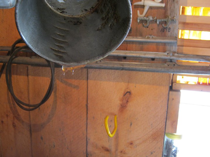

Best test for syrup to see if it ready: Dip a large spoon or dipper in the syrup while it is boiling. If the syrup drips off it isn't done yet. If it sheets off it's syrup. You'll know when it does it.:thumbsup:

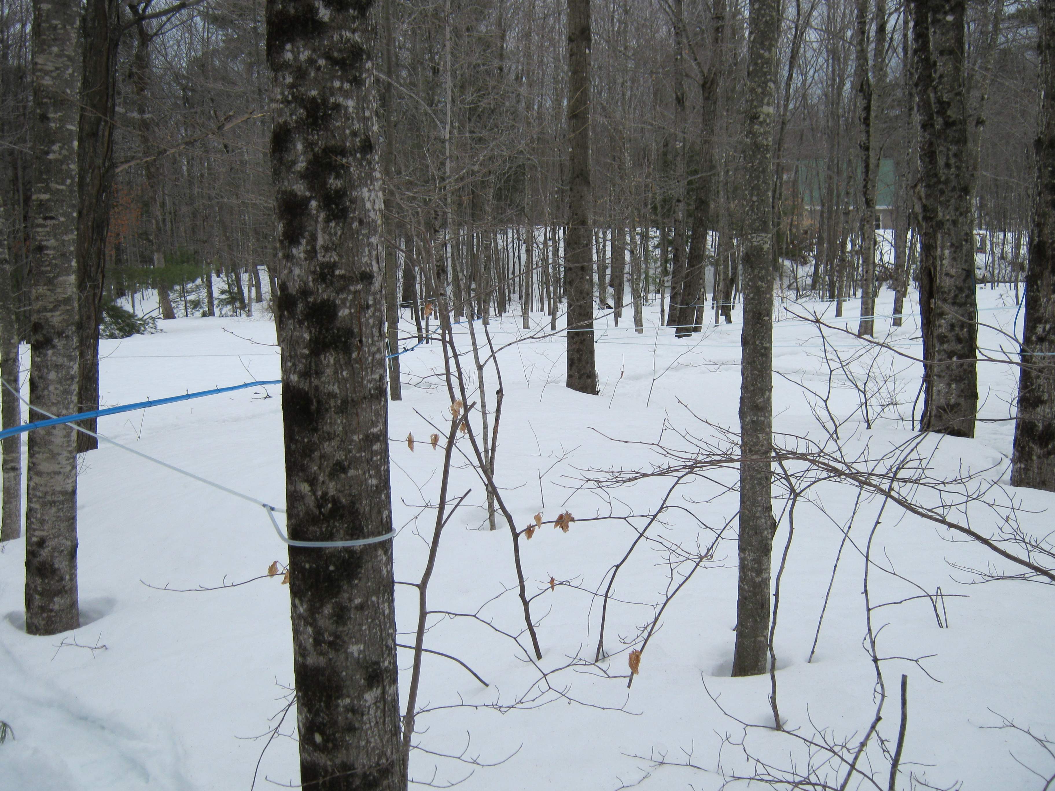

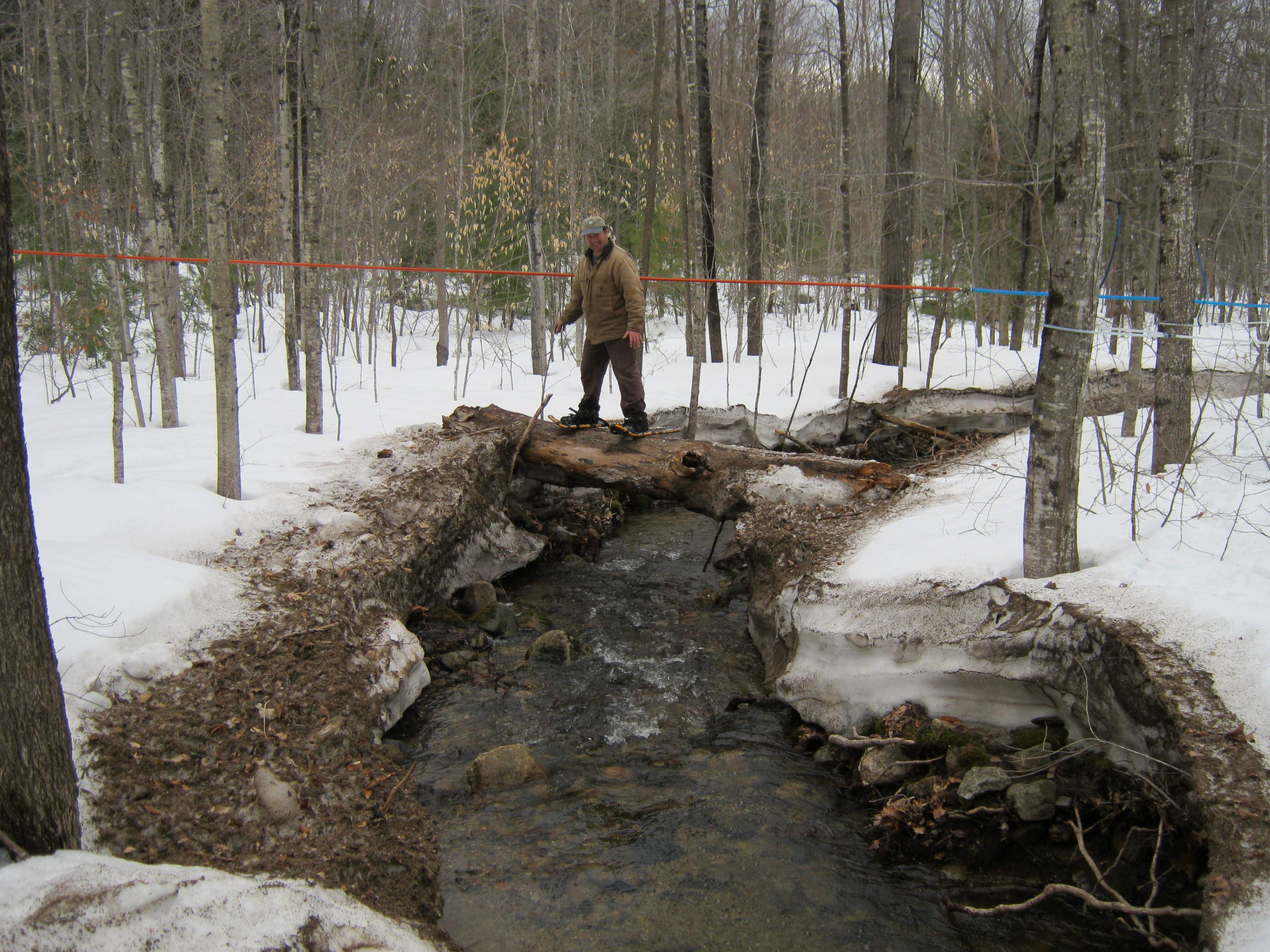

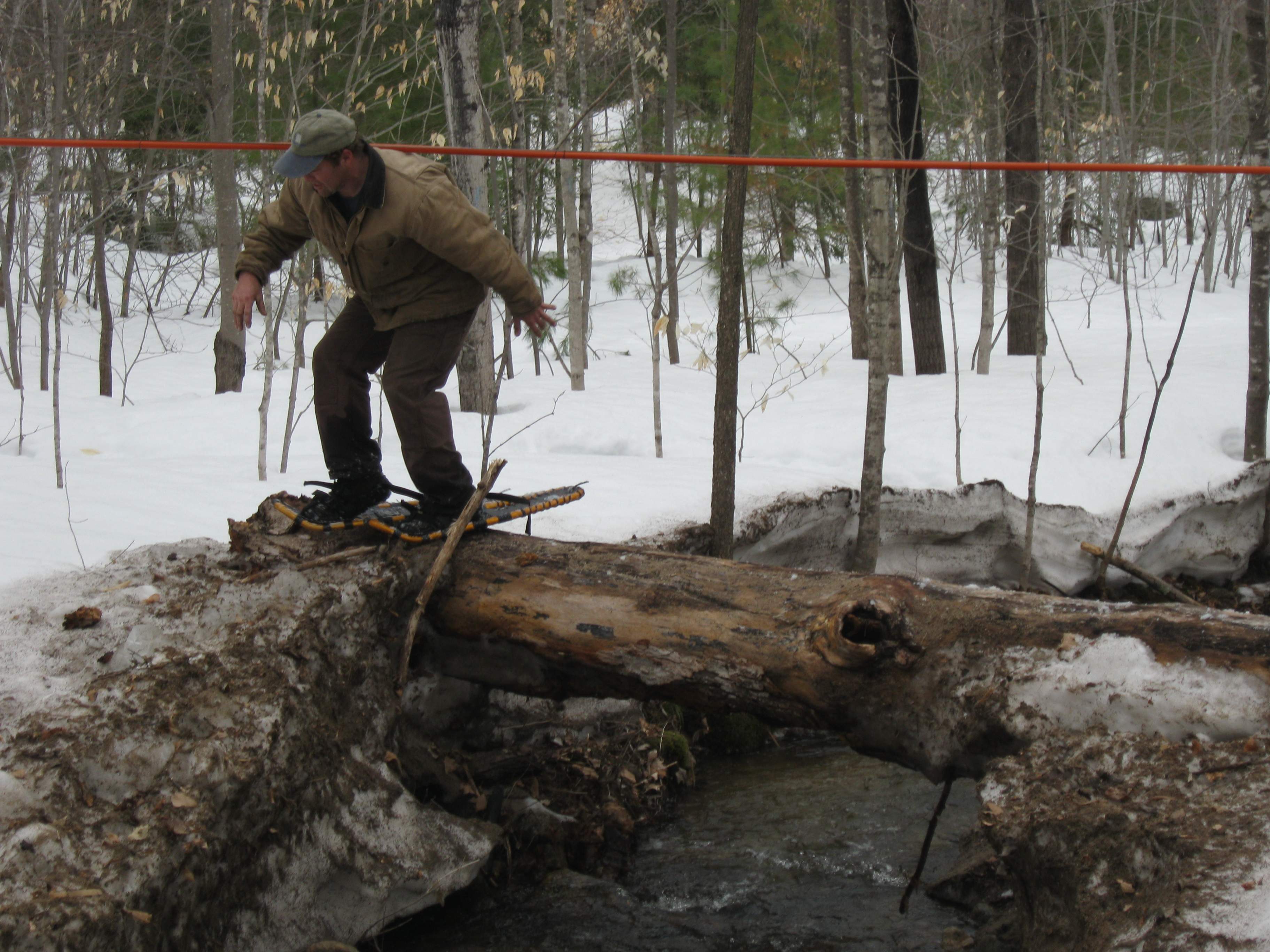

Almost done. We've got another 70 or so to do today, then 100+ buckets to put out.
Here's a couple pics from yesterday. We found a "bridge" so we could cross the brook. Not easy to do on snowshoes. :p

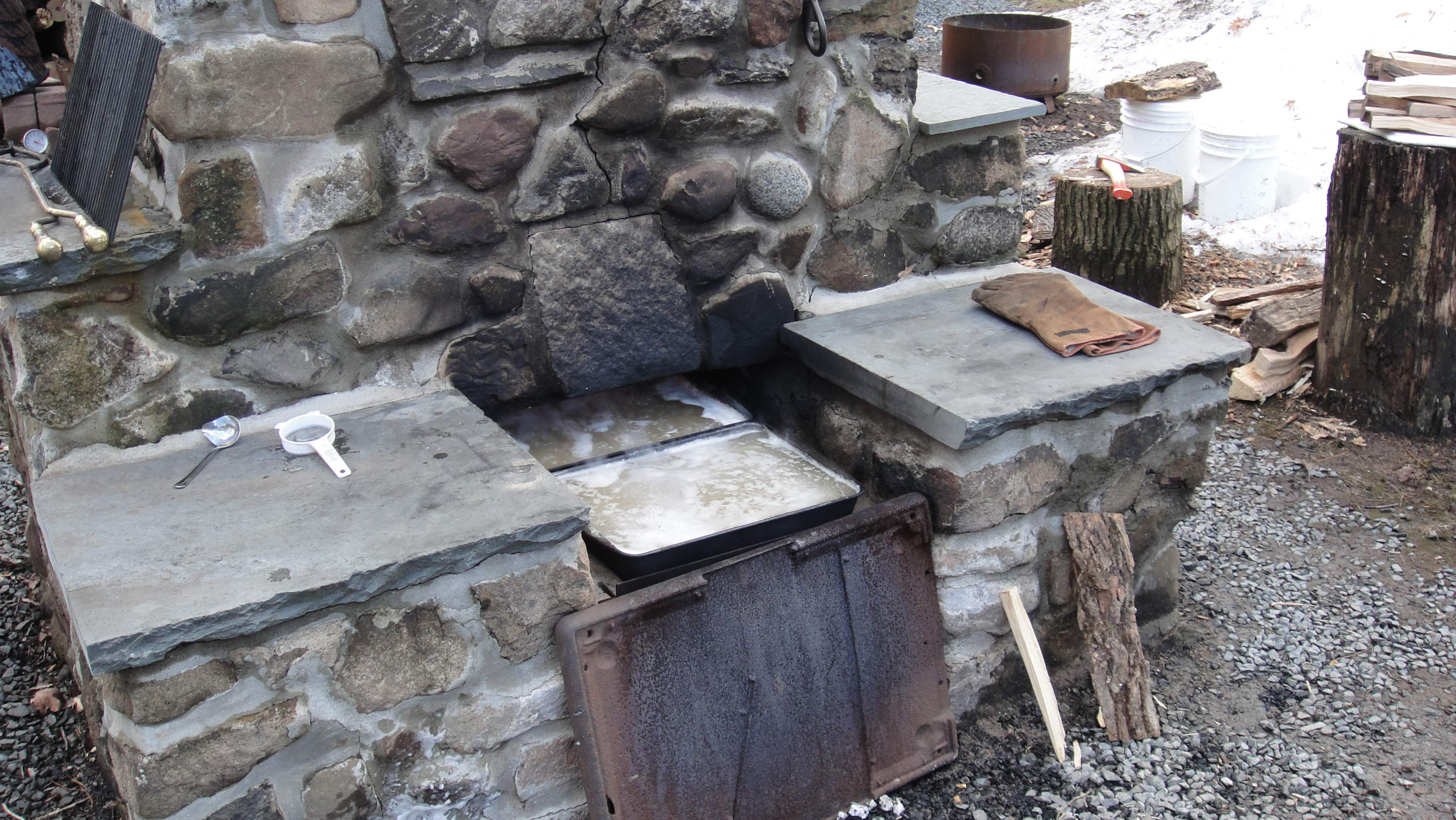

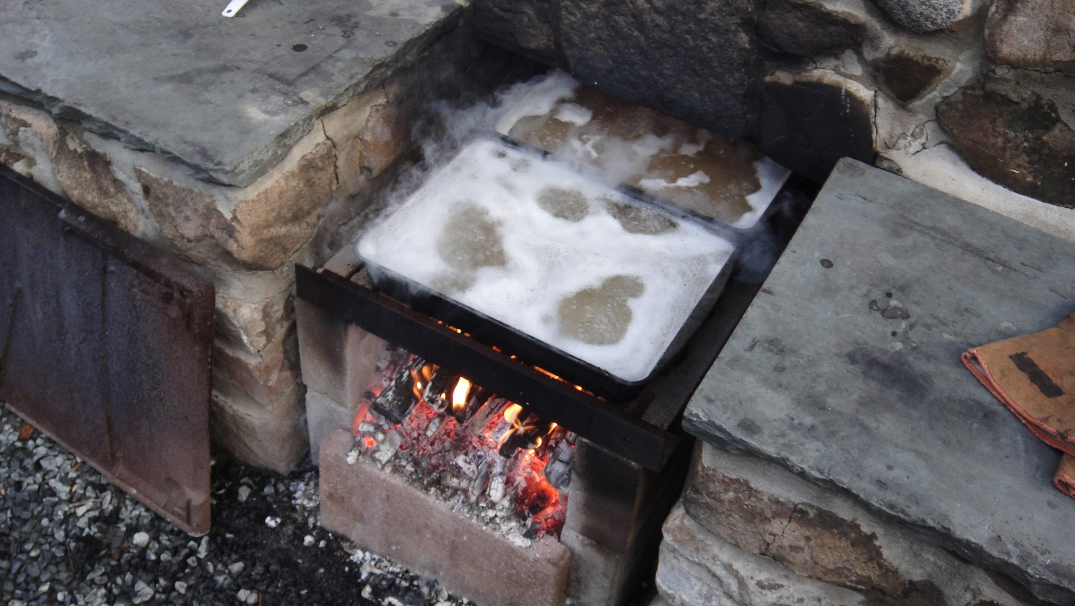

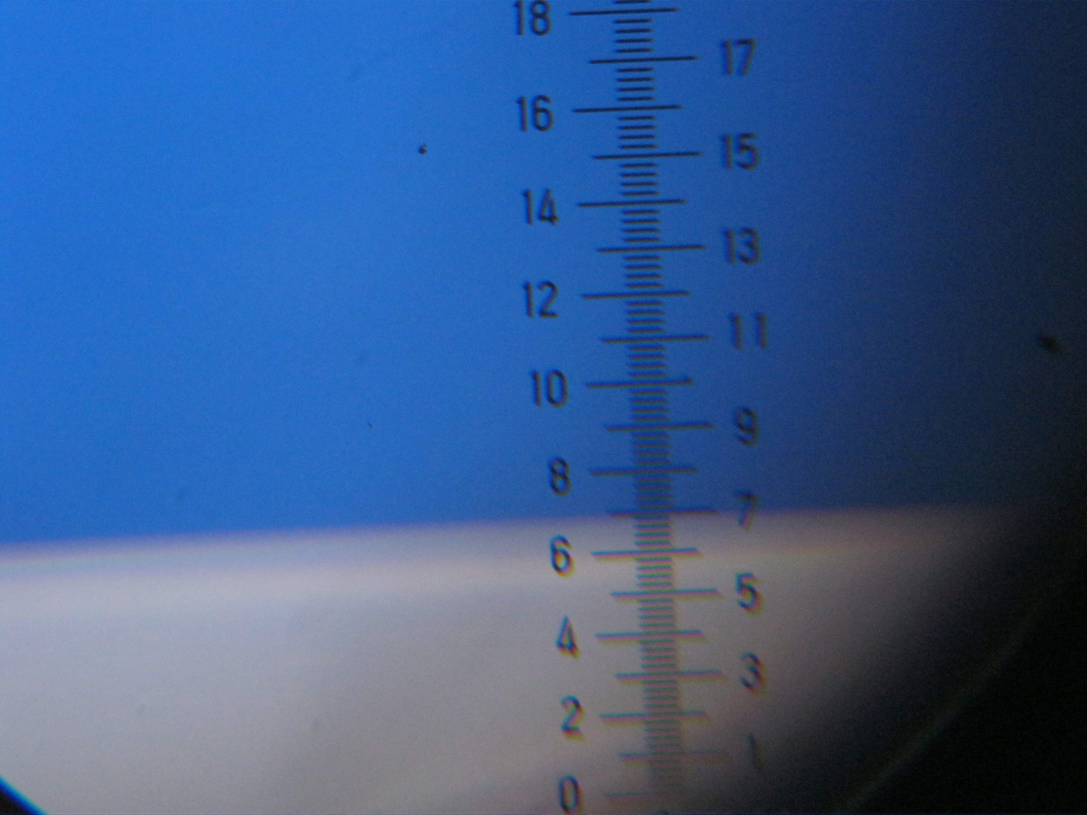

A couple pics. First one, 3% sugar. Not bad, gives us a ratio of 27 gallons of sap to 1 gallon of syrup.
Second pic, 7% sugar! :licking::thumbsup: That gives us a 12 to 1 ratio!

Here's as close to an example as I could get. Took me about 30 pics to catch this, lol, camera didn't want to click when I wanted the pic.:laughing:

   / Good syrup year this year? #19
Good season thus far, good weather all week, 3-6" of snow coming tomorrow and cold every night for the foreseeable future.
Hey thanks for trying so hard, I see what you're talking about.
