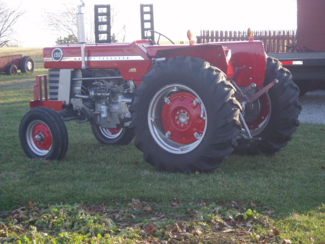

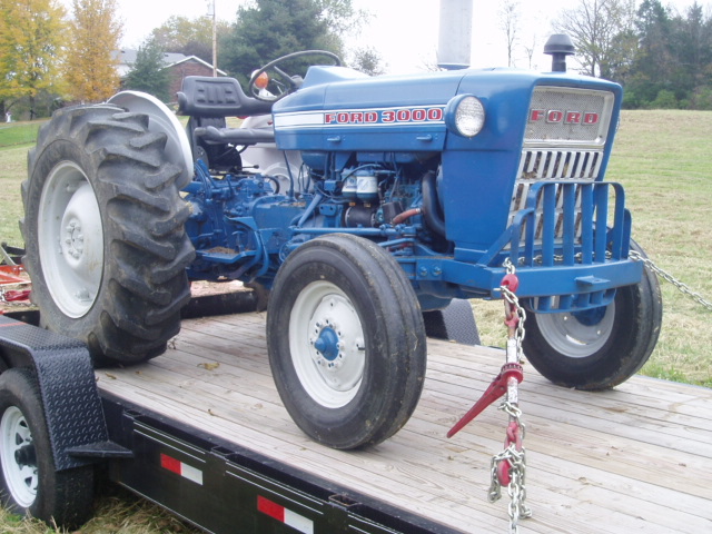

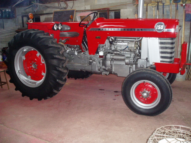

Here's 3 of the last 5 tractors I've painted. Massey uses OEM AGCO Acrylic Enamel. (Believe it's PPG made) Paint isn't even completely dry on this one yet. Ford uses DuPont Acrylic Enamel. Shot when it was too hot outside for reducer used Not my best effort. Deere is PPG "DEL-FLEET" . (OEM paint on Freightliner trucks, as well as paint of choice for UPS and FED EX jets) The Deere paint is 4 seasons old. (Picture taken this AM. Put rear blade on it for any snow the new year might bring) STill looks and shines like new. There's $490 worth of "product" sprayed on that one.
