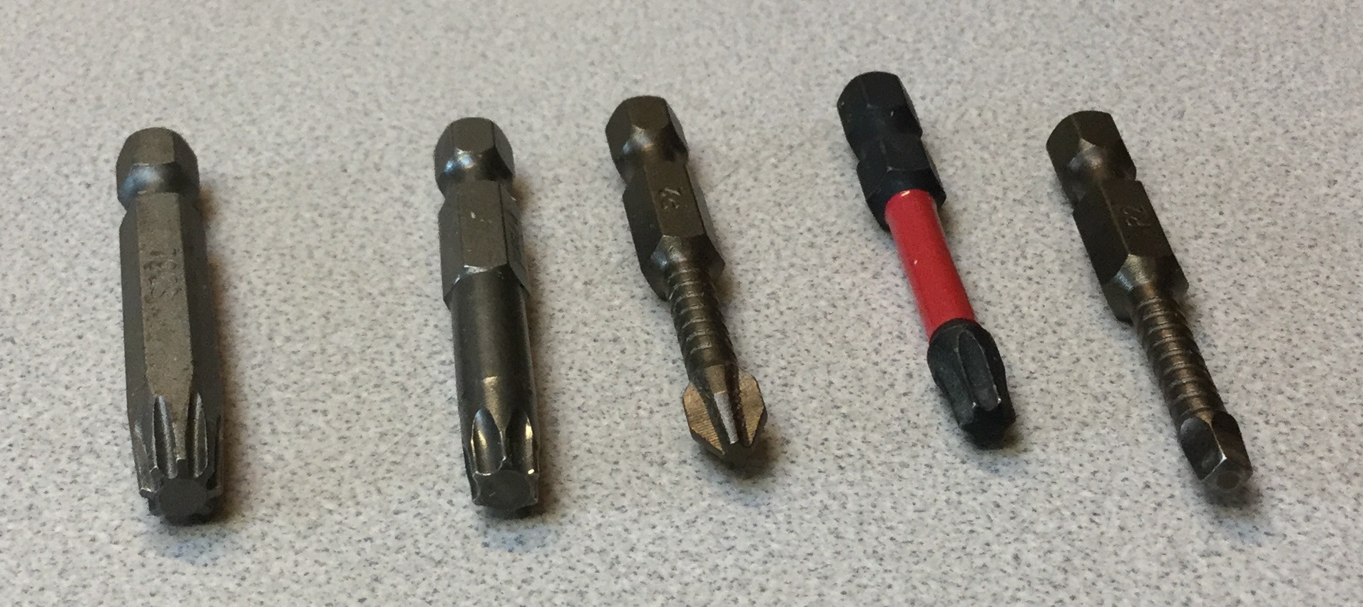

For fastening wood, I use impact bits in a Makita cordless impact driver. Sometimes in a cordless drill. I hardly use a hand screwdriver at all. The various bits are in the first photo. Milwaukee and McFeely's are the best. The bits that come in a box of structural screws are also very good. What is hanging on the wall in the local hardware store or big box store is usually crap.

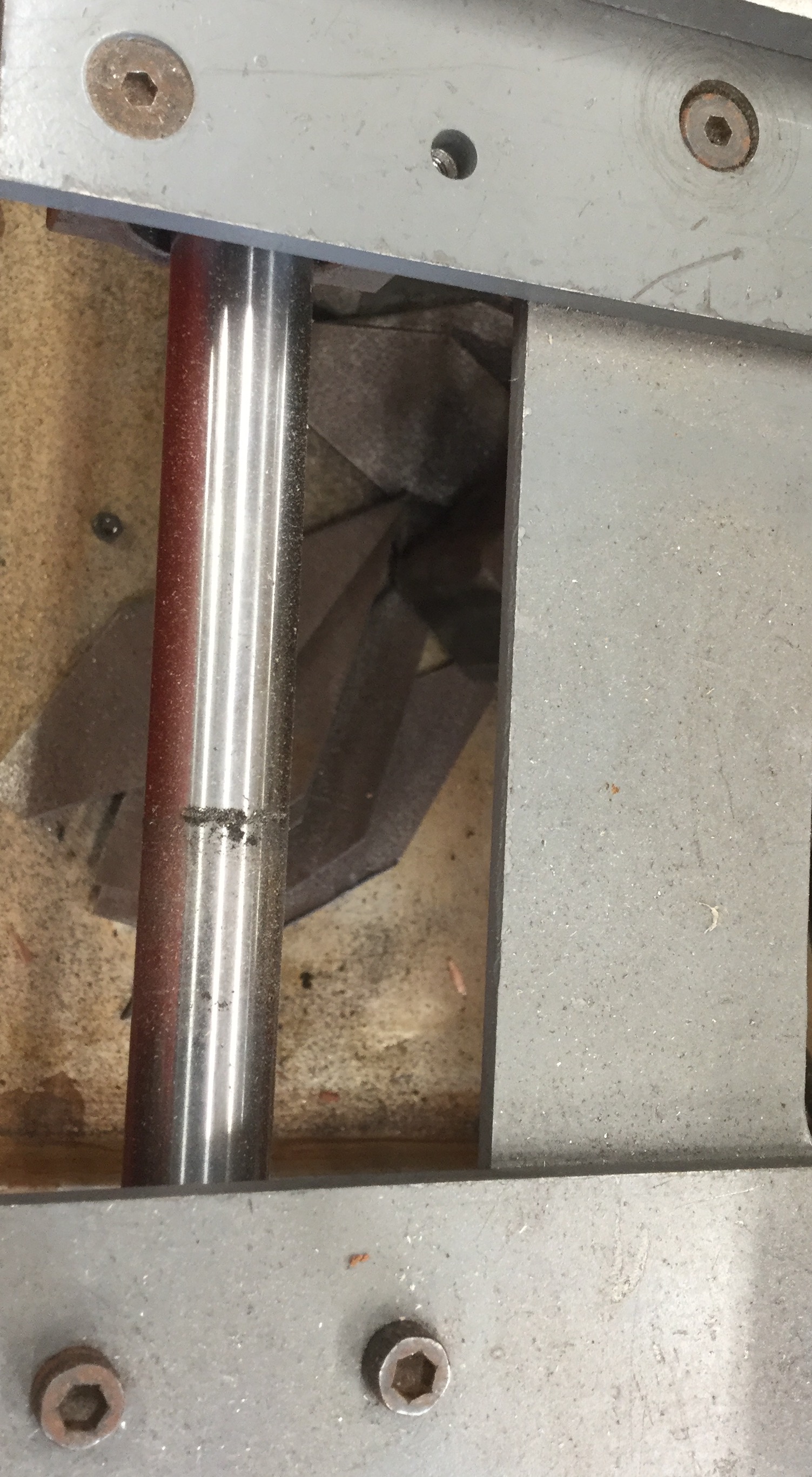

For fastening metal, I use socket head screws exclusively. Second photo.

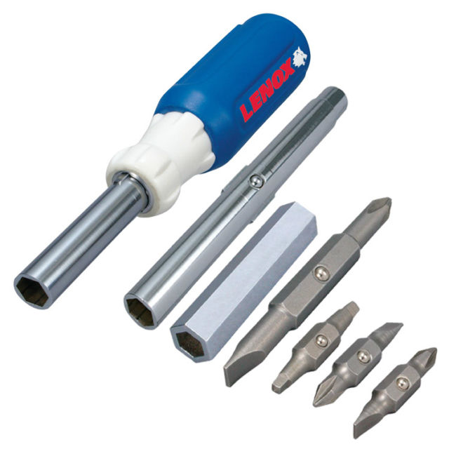

For odd jobs around the house, I use these Lenox multi-tools. The quality is good and they are very convenient and cheap, about $8.00. Third photo. There is a Southwind clone, the quality is terrible, compared to Lenox.
