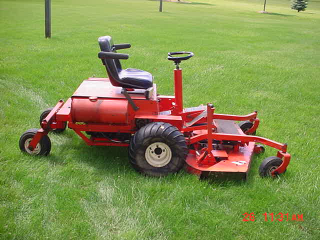

and while it's still dark and the first cup of coffee is disappearing, RS, how does that Simplicity drive?
It looks like a high effort machine but a poor man's version of the twenty thousand dollar JD and Kubota mowers made today. Never saw one before, pretty neat. Driving position reminds me of a cross between an old Alfa and old bus... It looks heavy duty and rebuildable though I wonder if parts are easy to get. Must be some owner's clubs for that. Just a very unusual mower.
Drives real nice ... ride is actually pretty decent as well, provided you don't try to go flat out, over hard dry ground ... or have the tires over-inflated.
It looks like a high effort machine ...
In terms of driving it ?
Not at all ... the steering is nearly effortless ... usually have to turn the wheel less than 1/4 turn when steering ... most of the time - if you're not doing sharp turns - you're only moving the steering wheel from 11:00 to 01:00 o'clock ... at most ... and I'm sure the linkage on ours needs adjusted ... ;)
It's hydrostatic (forward/reverse) via a foot pedal ... the steering wheel actuates the valves on a pair of Eaton (rotary vane ?) combo pump/motors (one for each large wheel) via a pair (or two pairs ?) of pushrods/linkage ... which controls the amount each wheel is driven ...
Turn it far enough and it will lock the drive wheel on the side you're turning towards (aka "turns on a dime")
LOL ... well, it is circa 1985 or thereabouts ... so the technology is a bit dated ... but yes, that's a fair way to describe it I suppose.
IIRC, we paid around $5K for it new, in the mid '80's ... the tires on the large (mid) wheels on ours are still the originals. Carlisle I think.
I think these were Simplicity's original offering in the commercial ZTR market.
The one you posted a picture of looks like it has the 60" deck (largest available ... ours is the 46") ... and the dual tail wheel option (ours is single tail wheel) It's also got some sort of non-original gas tank on it from the looks of it (stock gas tank is 6 or so gallons, black plastic, squarish, and on the other side)
Driving position reminds me of a cross between an old Alfa and old bus... It looks heavy duty and rebuildable ...
Yup ... it's a nice piece ... worth spending some T & E on.
The mower deck is fabricated (not stamped) ... probably 3/16" plate ... maybe 1/4" ... heavy-duty spindles with tapered roller bearings I believe. Pretty high tip speed on the blades.
Ours is in need of some TLC and cosmetic restoration ... it's had a lot of use and a hard life ....
Another winter project ... :rolleyes:
Probably depends on which parts ...
Last time I checked (a few years ago) the chain sprockets were still available from Simplicity ... but pricey ... I've only replaced them once (in 30 years) ... and then only the smaller ones. Would be pretty easy to fab using off-the-shelf parts.
Only one of the (two) mower blades was available (from Simplicity) last time I checked ... but I'm pretty sure that Oregon has something that would work, if not a direct replacement.
The Eaton pump/motors probably have rebuild kits available ... at least ... if not complete pump/motors. Ours have never been serviced.
The engine is a Kohler (Magnum ?) 18 ... original ...
Most of the stuff (pulleys, belts, etc.) is off-the-shelf kinda stuff ... or would be fairly easy to fab.
Could be ...
Yup ... it's kinda unique ...
