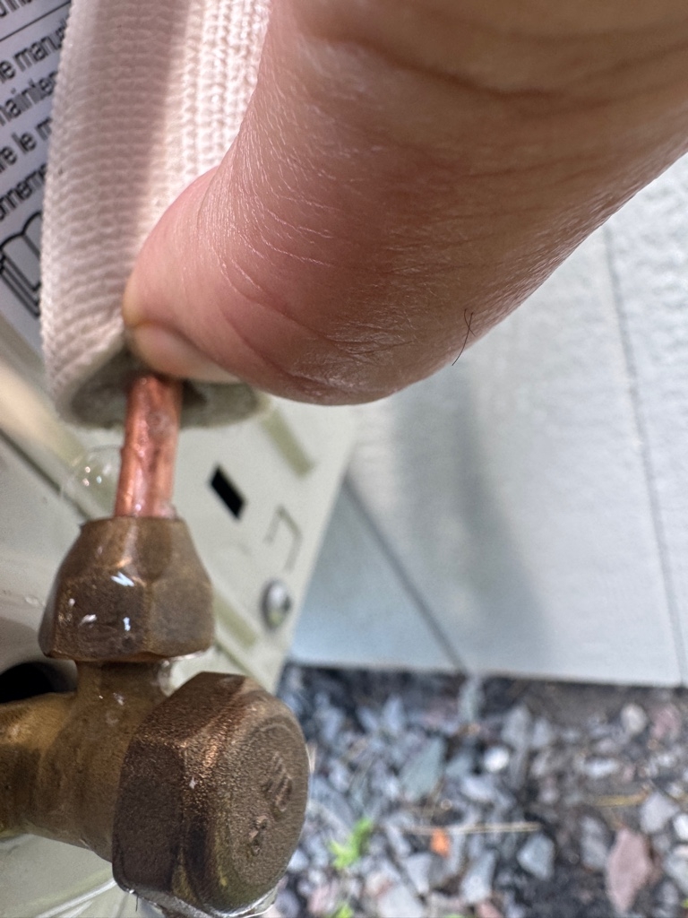

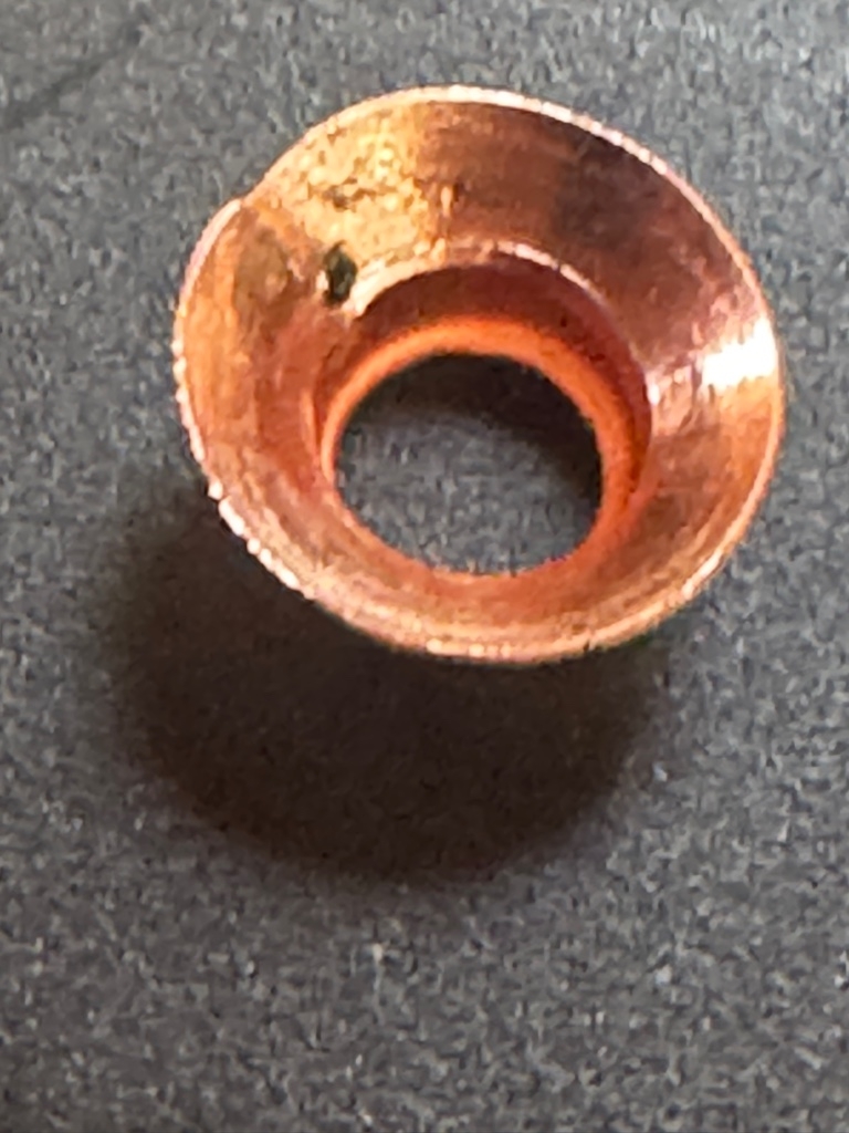

Next on the list was the mini split in the shed. Fortunately, the issue was installer error. I pressurized it with 400psi of Nitrogen, and the error was easily found. I heard it with the good old Accutrak ultrasonic leak detector and then verified it with good old bubbles.
As you can see the issue was some sort of inclusion in the copper right at the flare. This was a connection that I did, but I did use the cheap copper line set that came with the unit, but I cut it to size and re-flared it.
After fixing it, I pressurized it with N2 again and let it sit for a couple of hours while I went to take advantage of Whopper Wednesday at the new local Burger King. When I came back, the pressure was 10psi higher than I left it, due to the hot sun baking the condenser. I considered that a pass, there were no more bubbles, and the Accutrak was quiet.
Next step was to pull a vacuum, so while I was waiting for that, went down to son’s and looked at the 15 year old LG mini split in the old smoke house, now my DIL’s photography studio. That one was an easy fix, rodents had chewed through a wire in the outdoor unit.
By the time I got back up to the shed, the vacuum was down to 450 microns, so it was ready to charge. I weighed in 24 ounces of R454b (which is practically unobtainable now) and the unit is humming along making cold air again.

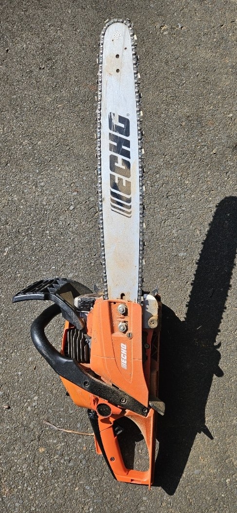

Worked on the chainsaw yesterday putting on the new exhaust, it actually made a difference for the little CS490.

Cleaned screen, added new exhaust and took it noodling in a 30" ash round. Did not bog down like usual. Shindaiwa exhaust exact match up thanks to xyz123 advice. and yes, I run a 20" bar on this little saw just fine.

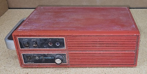

I don't recall how old the sirens are. They started out as CD Sirens, so that should help date them. We still have two in use. Had 8 total at one time. Home alarms
were bought in the late 60s early 70s to go in members houses. We started acquiring pagers in late 90s early 2000s for each member. But the fire sirens were still primary notification. Now you can get alerts on your cell phone.
The original siren was steam operated and was located at the "Town Works". I'm guessing that's what they called the public works building way back when. Well before my time.
