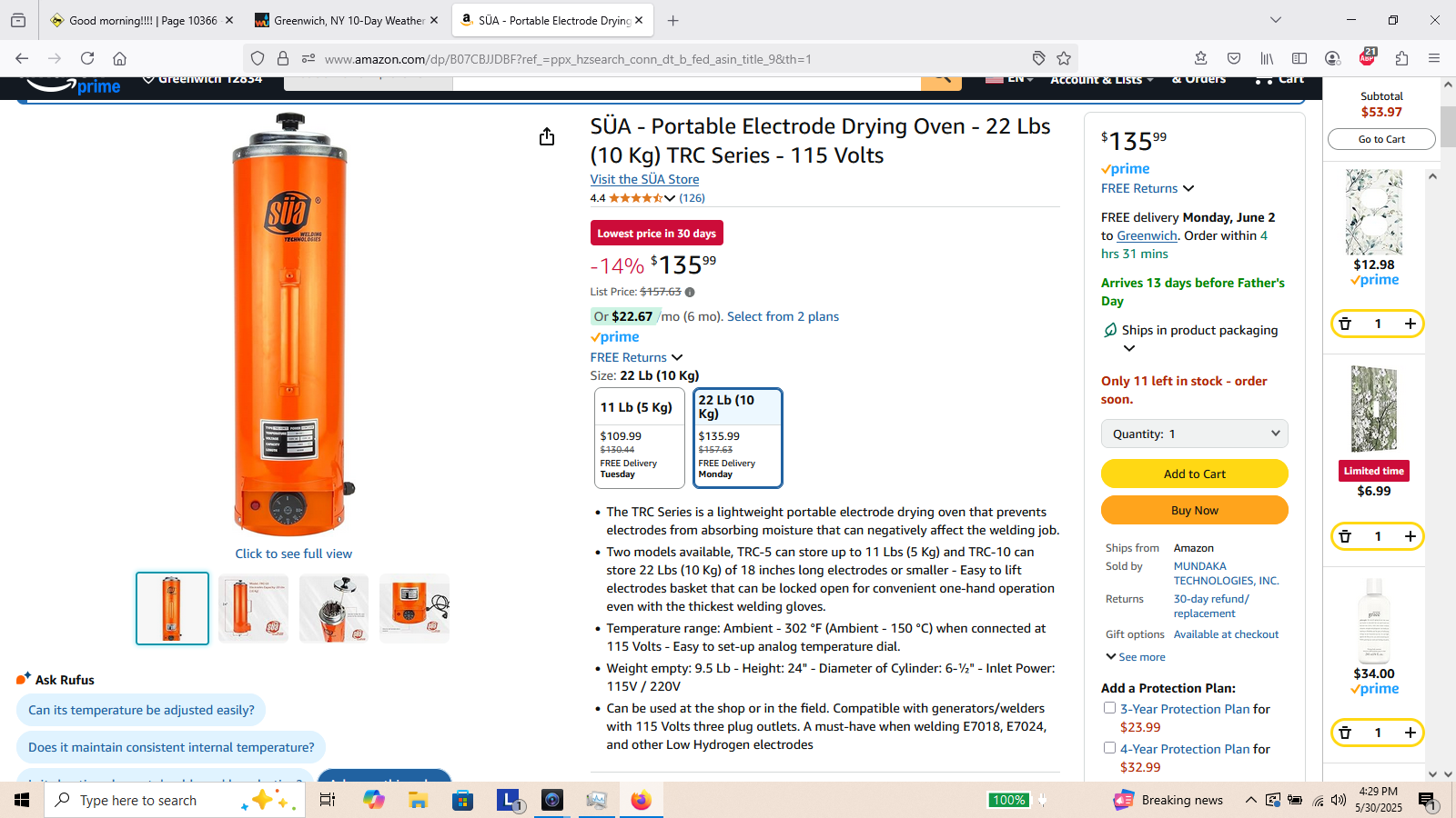

Looked over some of the electrodes on hand for stick welding and found that I have a lot more than I thought. 150 lbs of E6010 1/8, 3/32 inch, 50 lbs of 7018 5/32 inch, some E6013 and E6011 1/8 inch. Most of it is in sealed tin cans and supposedly should be good without attracting hydrogen.
PopG would it be worthwhile to get a rod oven to be able to use them after being open to atmosphere. Maybe for my limited use it does not make much difference since it is not be a certified weld
I got this one a few years ago. My welding usage has diminished considerably in the last couple of years.
After I open a box or tin of 7018 I store them in the containers show above. When I know that I have some welding coming up I'll fill the rod oven and let it run overnight to warm up and dry the rods.
My 6011 I just keep the rod holders closed up and they work well.
6011 and 7018 are the rods I mostly use and a small amount of 6013. The 7018 is the only one that seems to benefit from being dry.
That said when I know that I'm going to need a specialty rod, stainless or nickle or hard facing I'll try to get them in the rod oven over night. Not sure if it's needed but it makes me feel better.
