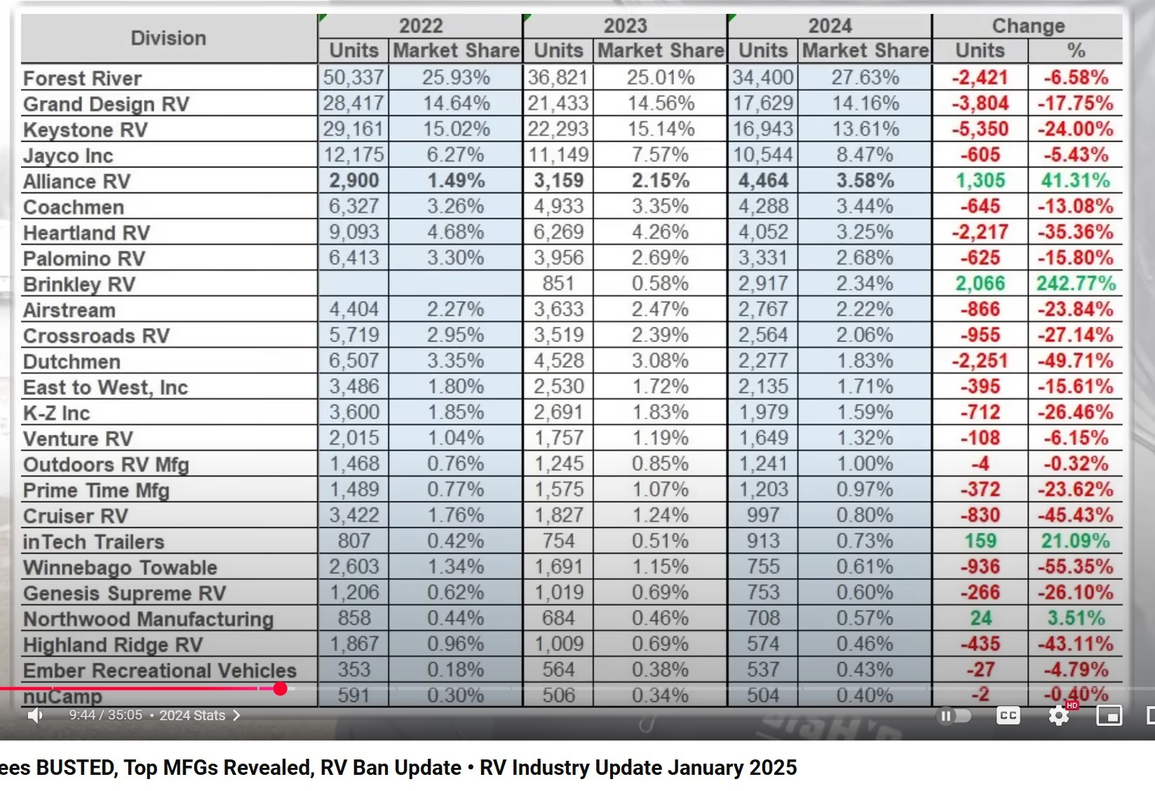

and for all of you who have owned rvs.
this is the sales figures for industry last year.
Very revealing that only companies increasing business are those that are known for
leading in quality of build. Consumers are really tired of poorly built, and particularly poorly plumbed rv's.
these negative numbers have to be considered in light of unusually high sales during covid, huge number of units out there so no surprise
things have slowed down. big numbers too.

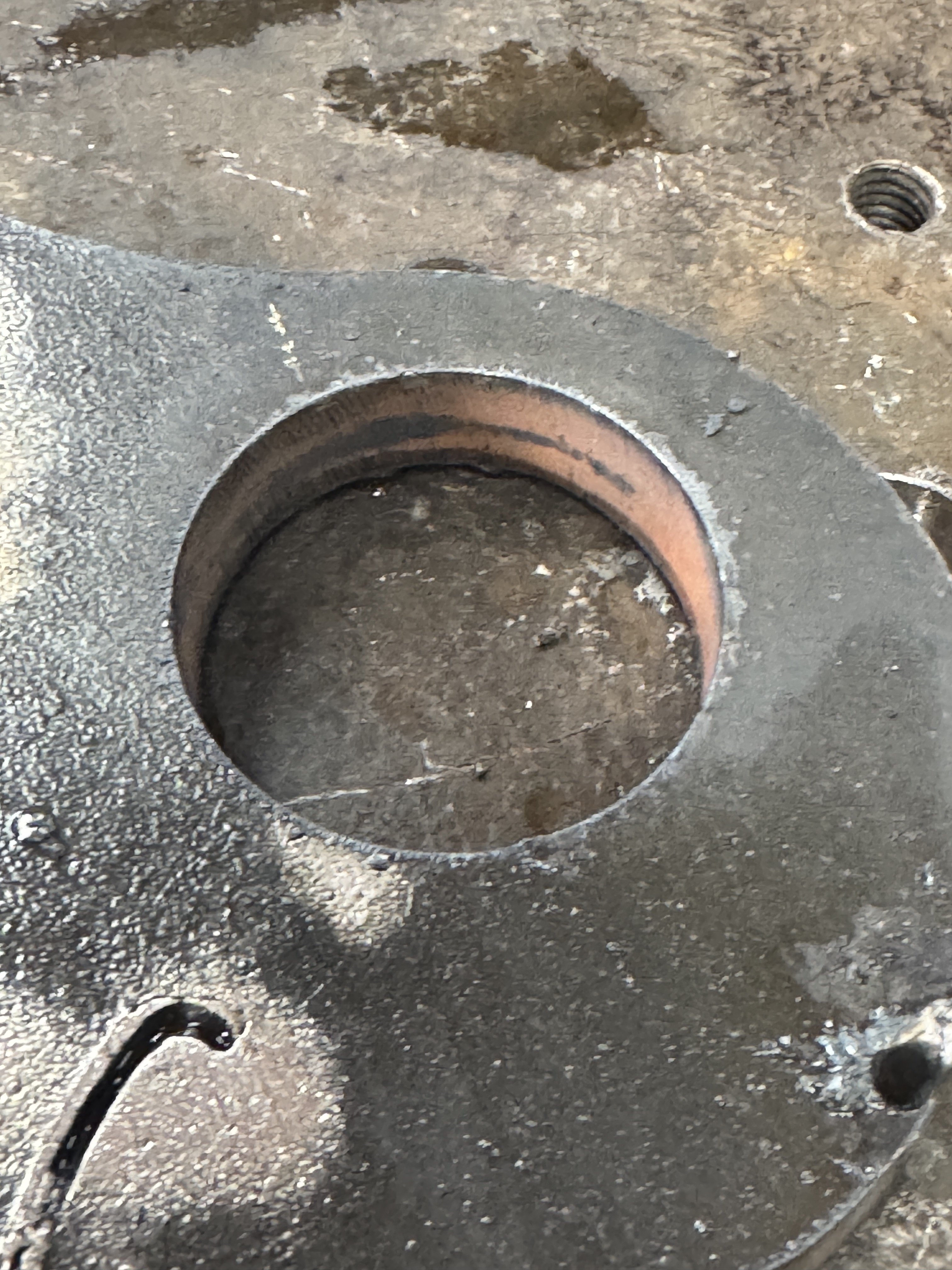

I did some experimenting with the plasma table, trying to better understand the piercing process and its various settings, and how they influence the process. One of the challenges of building a system is that there is no overall tech support. My plasma cutter, torch and table setup is unique to me. The good news is that once I completely understand the nuances, I can be my own tech support. It didn’t help that I’m completely new to the plasma cutting process.
At any rate by editing the G code and seeing the effect of each change, I made great progress, and working with the code directly was a huge help in understanding the entire process. I was able to pierce and cut a 1.625” hole in a piece of 1/2” steel with no discernible taper and a good pierce as a result of my experiments. It was the piecing that was giving me fits. You can see some failed pierces in the picture.
