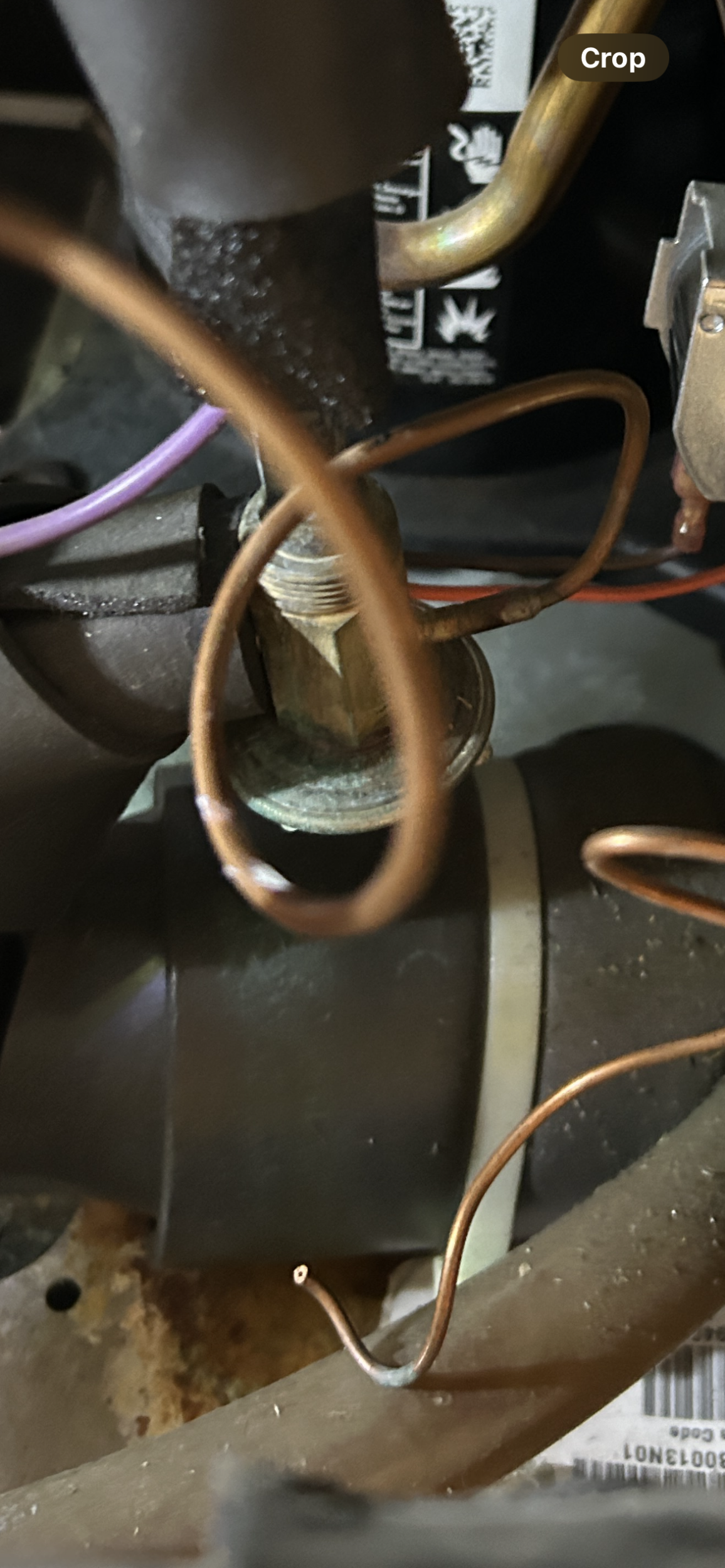

Thanks to popgadget for steering me in the right direct in finding the geothermal problem. Now have to decide on a course of action. Might replace entire system with high efficiency heat pump since unit is undersized. Will depend on costs. This will put porch ceiling and deck projects on hold.
Been running this system 12 yrs, would like to have gone longer.
The small tube with tiny hole broke from the bottom of TXV valve in middle. The purple wire goes to thermistor above, lowtemp caused by this broken valve is causing the compressor to kick off.

Dennis sorry tube failed causing valve to malfunction.

BEF, why can't you just replace the faulty valve and repair the pin hole?
I don't care whether one is independently loaded or broke, it seems like a lot of money to replace a whole system over one broken part. Would you replace your car/truck because you needed new plug wires?
