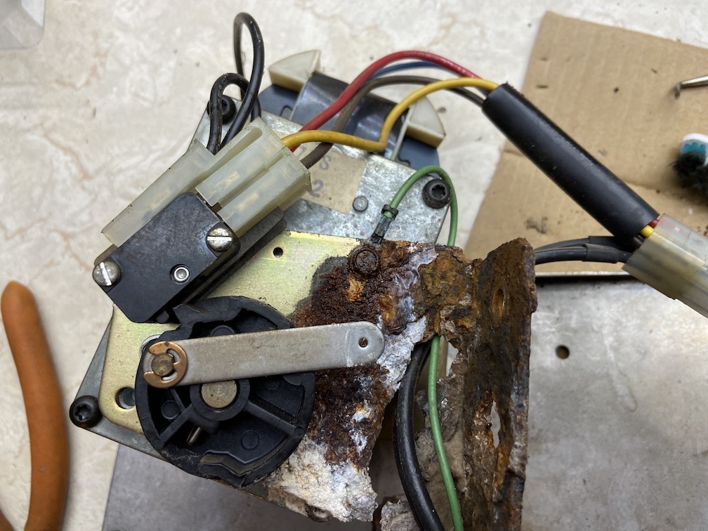

Got back into the water softener valve rebuild yesterday evening.
Figure I have made Her suffer long enough ... :devilish:
Got all the piston seals, spacers, and new piston installed in the valve using the hack method ... plus the brine injector assembly put on with new gaskets ... and the flow control housing and elbow installed. Just ordered a new brine injector nozzle and throat off Amazon, should be here tomorrow.
The flow control housing appears to be missing a washer which controls the amount of flow (doesn't effect sealing) which maybe should be there (?) ... not sure what's up with that, will need to look around ... but I think it was missing when I took it apart. Maybe not required.
Also got the flow meter put back together, new o-ring installed, impeller lubed up with some food-grade silicone grease ... you can blow into either end and it spins:

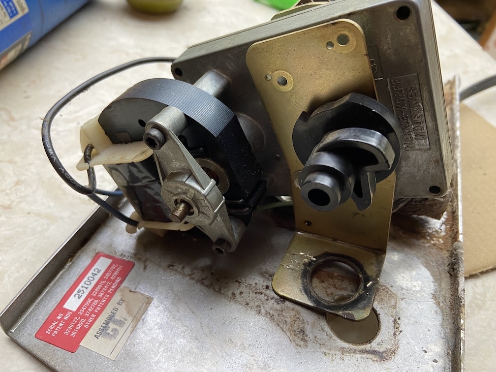

Was able to get Brine Valve Piston Assembly disassembled and removed finally (was where the open holes on the backing plate and bracket are now):

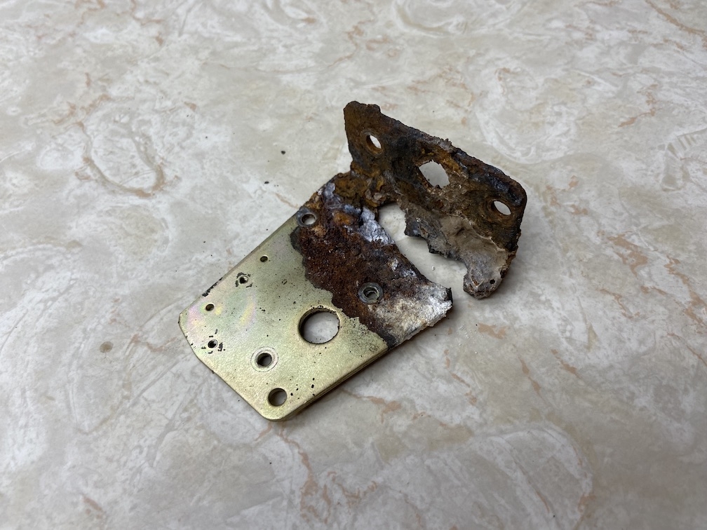

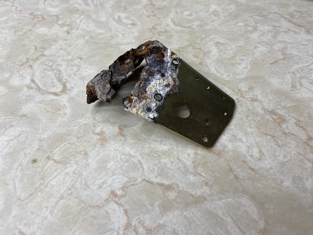

Since it went through that bracket that retains the motor assembly to the backing plating I was able to get the motor split off and get the other bracket on the other side for the motor removed - but it's in very rough shape:

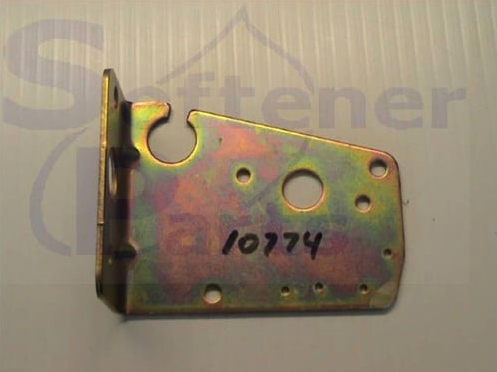

Here's what it should look like:
Unfortunately that bracket became obsolete in January of 2023 and is "NLA" ... which means that unless I can find one locally - either used, in good condition, or NOS - I'll have to fab something up.
Which should be loads of fun ... as several of those smaller holes are threaded (#4 or #6 machine screws) so they will have to be drilled and tapped in their exact locations.
Other that that, it shouldn't be too bad - most of the holes aren't so critical that the size and locations have to be totally precise.
Figure that I'll probably punch the holes as separate two pieces of steel and weld them together. Should be able to come closer that way, as opposed to trying to bend a single piece and then drill the hole (or vice-versa)
