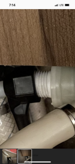

looks like several possible culprits
Won't be the crimped part vs the clamps
I need to feel around and try to locate anything wet.
at least I know what my hand will be touching now.
that fitting on the right looks particularly dodgy
well, first I have to clean everything in there again.
one's head almost goes in the bowl...
then down on my stomach and see if I can stretch my arm in there.
I can see me getting stuck.
help, I'm stuck in my toilet
actually why I try to keep a cell phone near.
This fitting doesn’t look like it’s on right

I agree, almost like it was misthreaded from the beginning.
Need to back it out and try again, with some teflon tape
Drew, BEF is right, it is misthreaded. Appears to be an NPT thread. Drew, the female probably has the first thread boogered up and will be really hard to start the thread back together straight. If you had an NPT tap, you could chase out the bad first thread and it would probably go fine after that.
