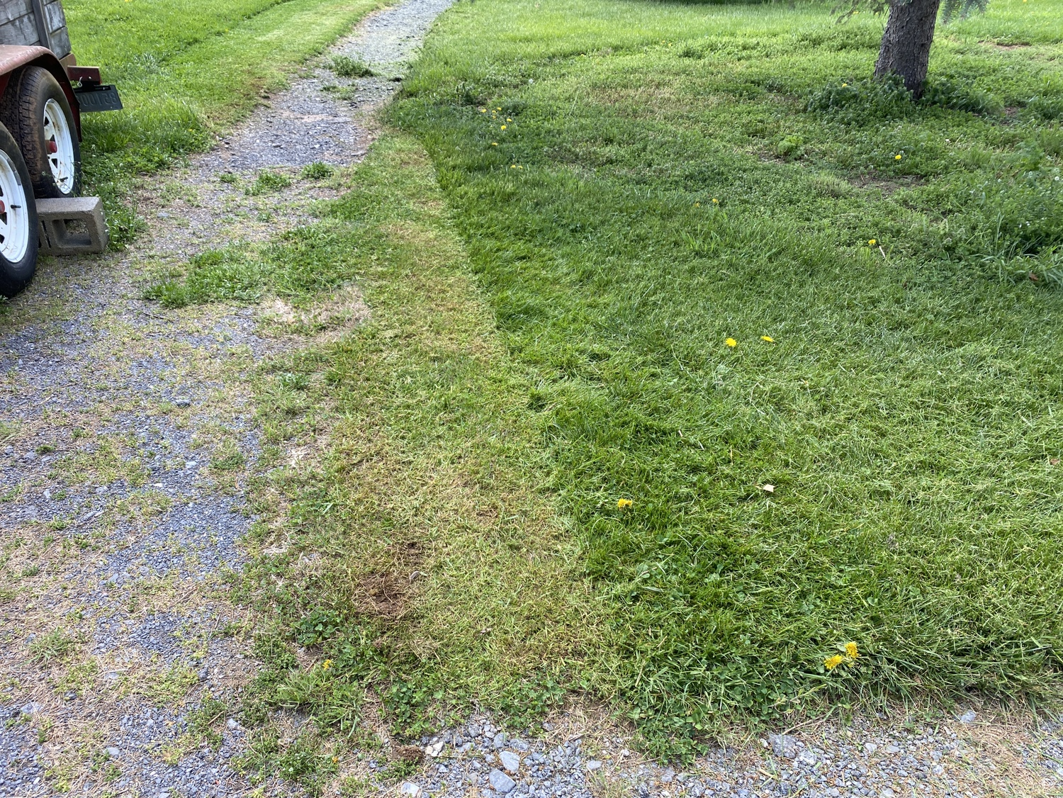

But I mowed a little bit to try it. With deck all way up, it’s scalped the ground. I think the lift arm from left to right got twisted, will have to check that out more.
Yup a tad off :oops: not unless your clearing stone from lawn or looking for mud worms as we say up here. ;)

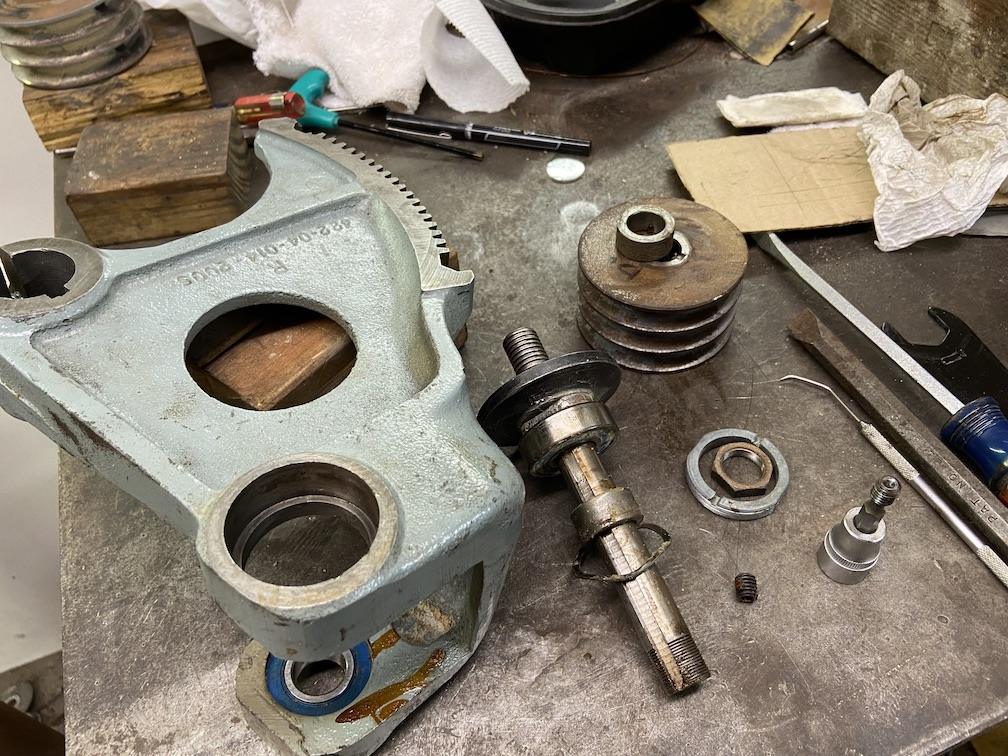

Tore down arbor for close inspection and deep cleaning, including more removal of contact cement (of course ... :rolleyes: ):

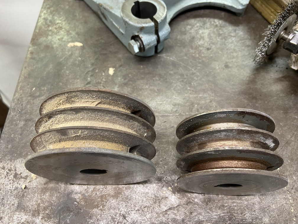

Pulley set screws were seriously over-torqued, couldn't break them loose with a T-handle wrench even after penetrating oil overnight and heating.
HF hex bit didn't have enough reach to engage the set screws so I took a punch and beat out the bit portion a little from the drive end which gave me enough reach to to engage the screws. B & D electric impact made short work of removal after that.

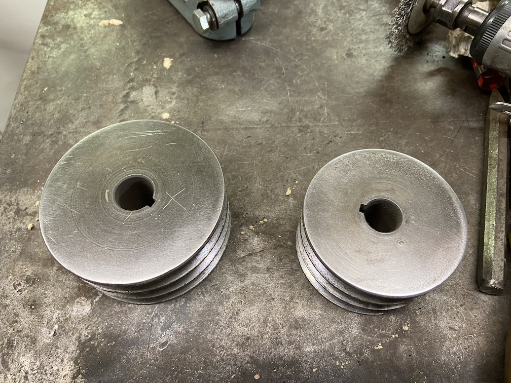

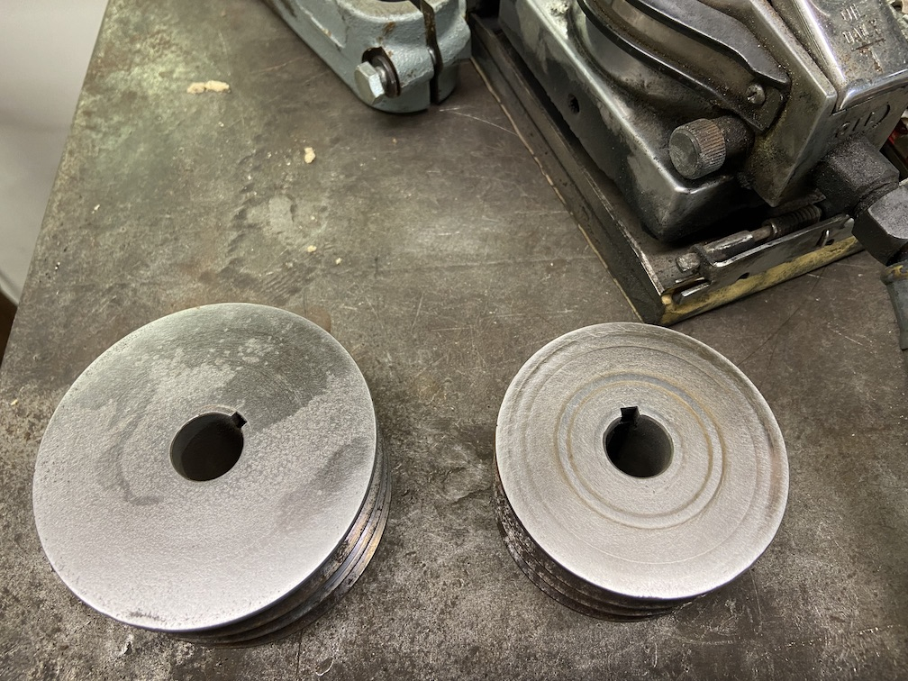

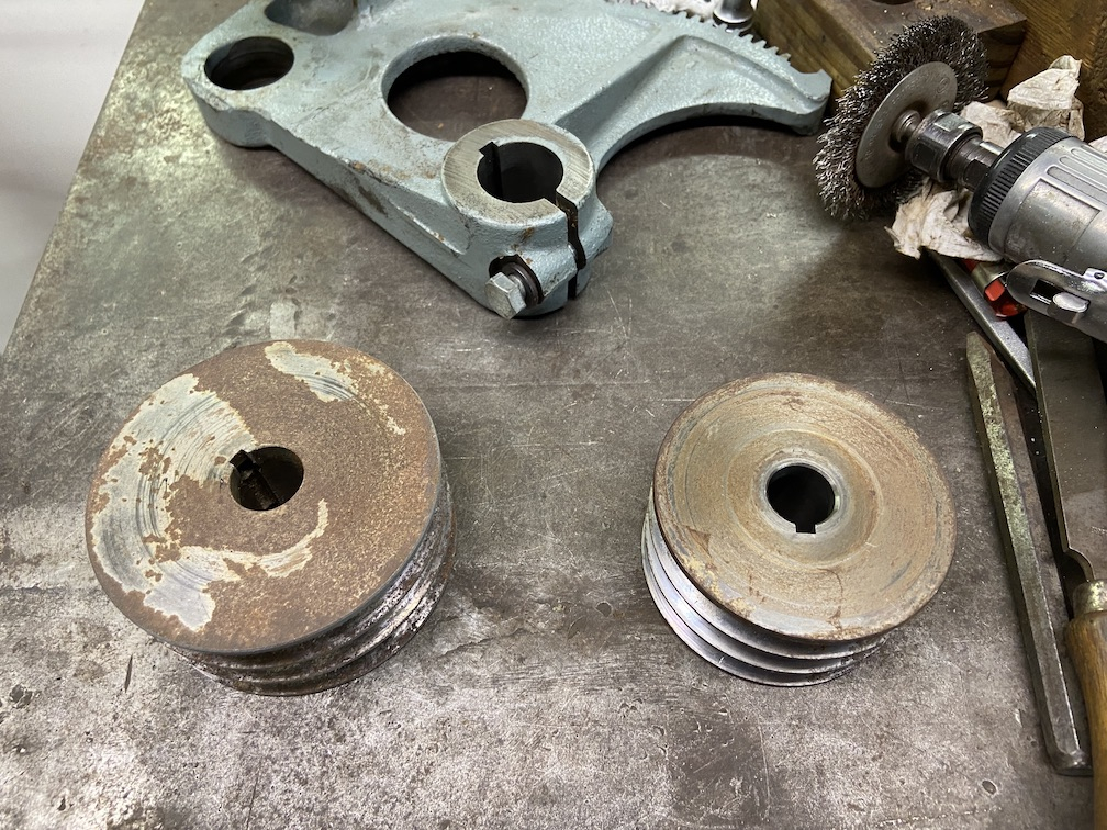

Both the pulley for the arbor shaft and the one for electric motor were a little scruffy:
... so they got the clean up treatment with the jitterbug sander and a couple of wire wheels in a die grinder, after scraping the heavy crud off them with a razor blade:

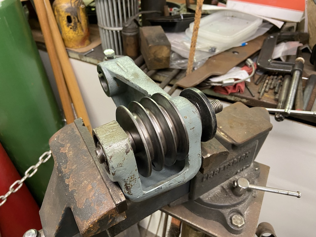

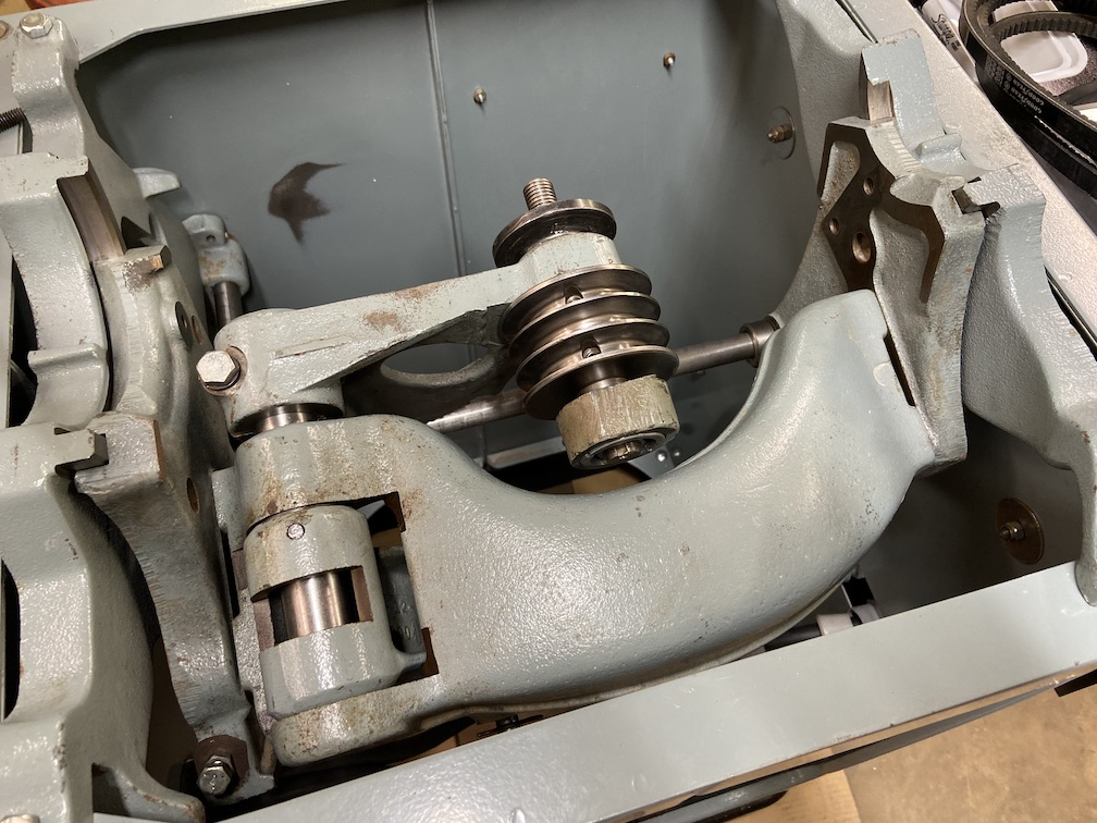

Both bearings seemed good so I reassembled after that:
There may be an issue with some wear on the shaft where the blade rides. If that turns out to the case, I do have a "spare" used arbor I got with the parts I picked up the other day that is in better shape on that portion of the shaft. It needs new bearings ... but those came with the arbor ... ;)
After that I got the arbor assembly reinstalled on the saw:
