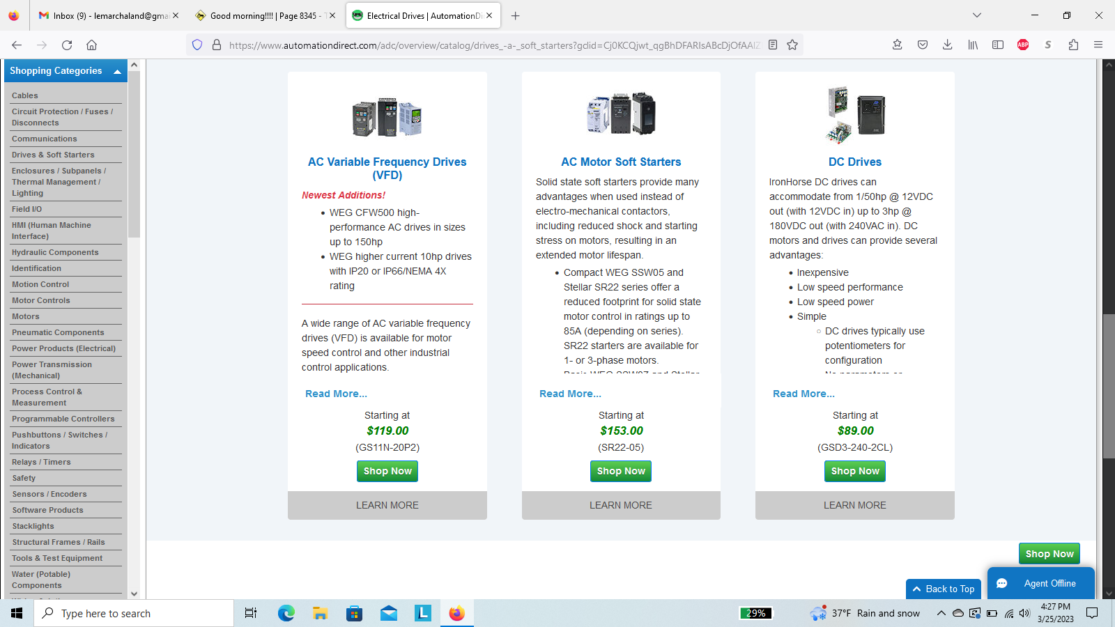

Have found a VFD on Amazon I think I'm going to go with that seems well-rated and is reasonably priced, just need to check the specs on the plate on the 3 phase motor to make sure the model I order has sufficient output.
Now need to start looking for an enclosure to mount it in.
Still trying to figure out the best mounting solution. From an environmental perspective, ideally I would wall-mount it in the basement - which is heated and cooled conditioned space. But that seems like it could be an issue in terms of easy access to the controls.
When sizing it, keep in mind that most VFD’s have a lower rating when being fed single phase than 3 phase. Also make sure that the one you choose will actually accept a single phase input.
As far as access to controls, once it’s programmed, you don’t have to access them for a saw, it’s never going to need reverse or variable speed. Just set to 60hz and you are done. You might consider running low voltage control wiring to the VFD for start/stop control.
As far as an enclosure, you will need to provide ventilation as the drives are typically fan cooled.
There is generally a good selection on eBay.
Right ... (y)
One of these two are what I'm currently looking at:
The first one what the guy that did the video I watched on programming these is using to supply 3PH to a 2hp Bridgeport mill. Mfg. claims a 3hp rating.
He says it's actually a little on the underpowered side for the rating on the Bridgeport's motor (which is actually 2 hp)... but he hasn't experienced any issues.
Here's his video on that:
which seemingly makes programming them pretty straightforward.
That's what I was thinking.
(y)
As at as an enclosure, you will need to provide ventilation as the drives are typically fan cooled.
Right.
Thanks, good to know ... (y)

Here’s the enclosure I used on my Bridgeport for the VFD, there is a switch and pilot light for when it’s on.
The coarse scotchbrite serves as an air filter on the exhaust to keep chips out of it, there is another opening on the bottom to let air in.
Here’s the low voltage controls, the potentiometer varies the speed, the middle switch is fwd-off-rev, and the bottom button is jog, with the bezel around it selecting direction.
