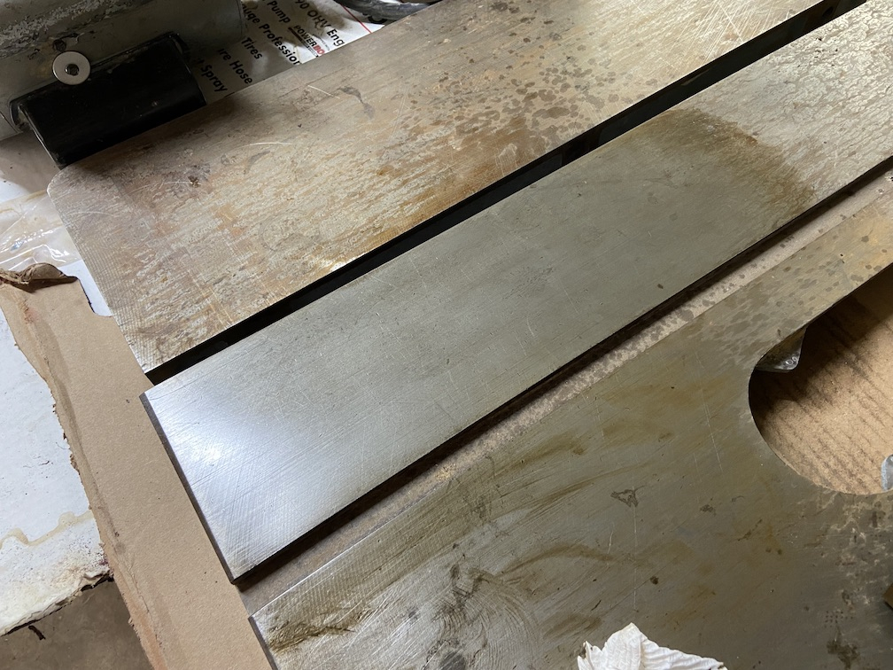

Decided to hit it and hand sand with a little Blaster and some 500 grit silicone carbide paper just to get a little better idea of what was underneath:
Doesn't seem too bad.
Fired up the compressor, dug out the HF jitterbug and hit it with some (previously used) fine emery cloth that I had used when I redid the top end on the Sprinter engine.

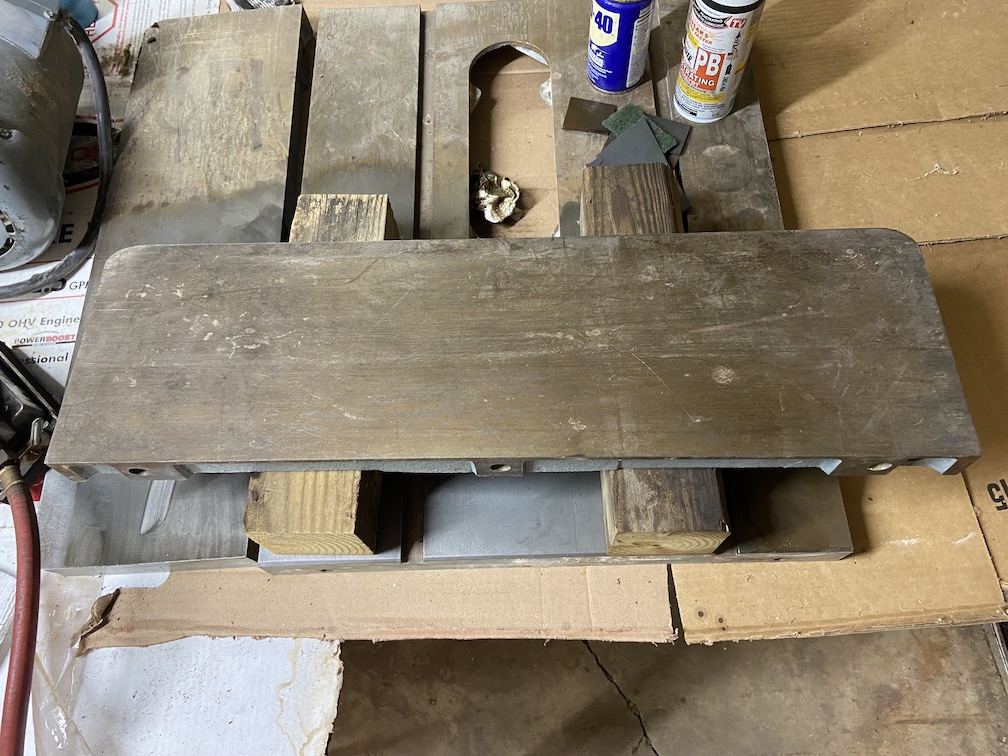

One of the extensions (before):

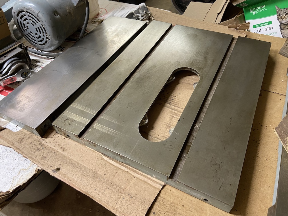

Where things ended up this evening when I knocked off as far as the clean up on the table and extensions:
Next on the agenda will be to hit the mating surfaces on the sides of the center table and extension wings with the jitterbug and dig into the clean out of the miter slots/t-track.
Might see if I can scare up an unused piece of fine emery cloth and hit the tops again.
I did measure the rectangular tube on the Biesenmeyer fence and it does appear that it is the commercial version of the fence not the homeowner version (although it is the shorter one I believe) ... (y)
