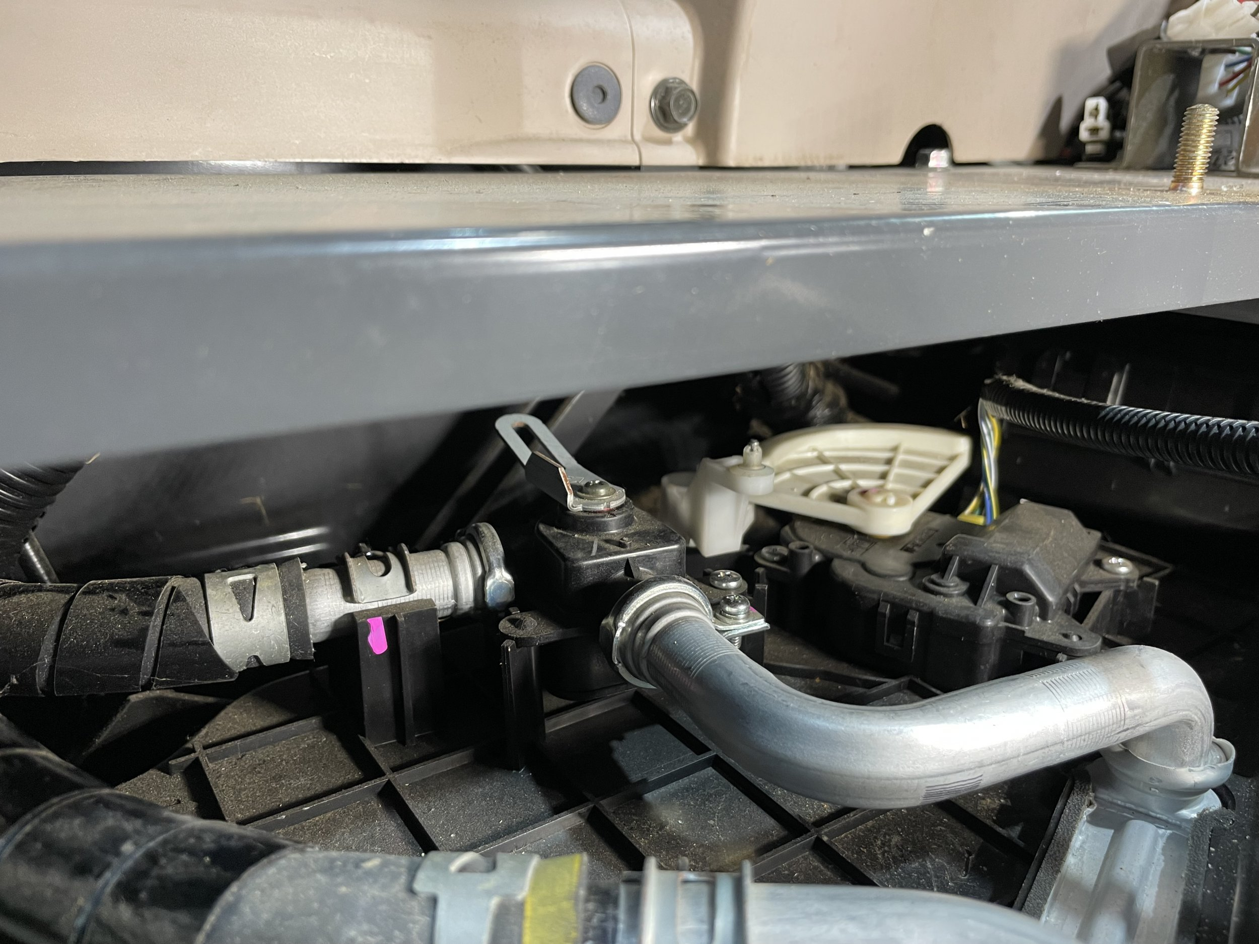

The heating valve on the tractor will no longer operate from the cab controls so no heat possible only works on fresh air or AC. I was looking into a replacement servo valve from Kubota but they hold it very dear I am afraid at over 300 dollars. It is buried under the seat platform and not easy to get to but took the seat out and the platform cover plate to be able to put eyeballs on it. Resorted to disconnect it from the servo motor to the valve and move it manually to the heat position so heat is working again. There is an access plate in the front part of the pedestal 4 inch 6 inch that I can remove with 4 screws and just barely reach the valve but will work for now if I need to turn off the heat. I might look into a choke cable I have to adapt it to operate the valve
I wonder why. Deposits? Freezing?
everything looks good under there and your tractor doesn't look that old
when something fails, I always wonder what I could have done differently, if anything, to prevent it.
like the only time I've blown up a small engine by not keeping enough oil in it, due to angle of operation.
I sure felt pretty stupid about that.
I'm impressed you identified the failed part vs electronic controls.
once all that stuff is taken off, bet that air seat isn't light, looks like you can replace the part.
Maybe do a youtube video and get a million hits that pays for a new M6...
