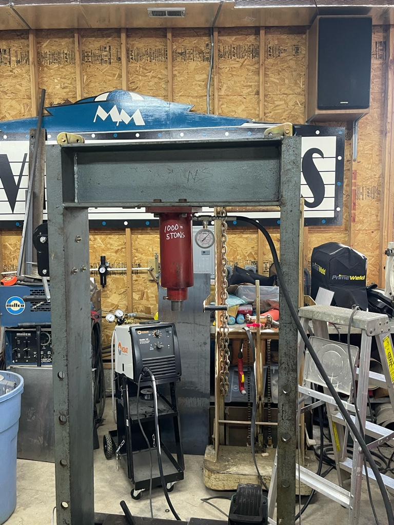

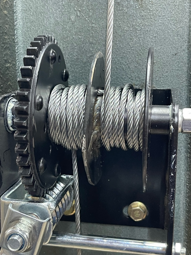

Today I went crazy on the press. I added a winch to raise and lower the table, found everything I needed at Harbor Freight. I used a worm gear boat winch, and modified it to spool two cables at once. Repurposed some snatch blocks for the pulleys by removing the hooks and welding them in place. It works great after tweaking the cable winds a bit. So now I’ve got a foot controlled, pneumatic powered press with a crank up table.

I see the snatch blocks I think on the top corners and assume the cables are running inside the web of the beam and using worm drive it can stop in any position. Very nicely done
