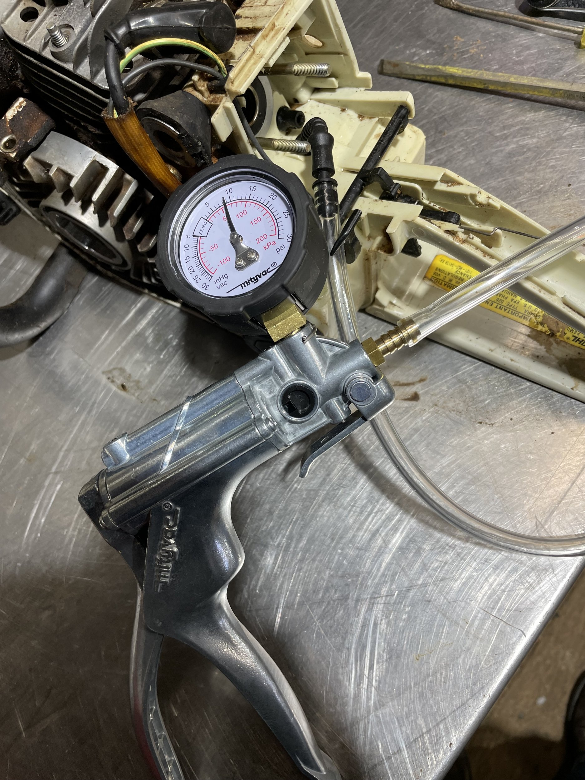

Working on the Still saw. Spinning the engine with cordless screw driver produced good spark so next check for leaks in fuel system. Holding pressure and carburetor held pressure also. Checked the diaphragm looks good but they are easily damaged by age by being stiffened. Maybe at fault since it would not start
   / Good morning!!!! #156,795
Did you check engine compression, how is it?
How about using starter fluid to see if it starts at all without depending on fuel supply.
Filter in tank ok. Cap letting in some air -check by loosening a bit, but not too much.
try this thread, lots of people on this one know how to do teardowns and troubleshooting:
Thanks will check out the thread.
It has strong compression, caps lets in air ok, starter fluid does not make it run despite having good spark whatever that means
