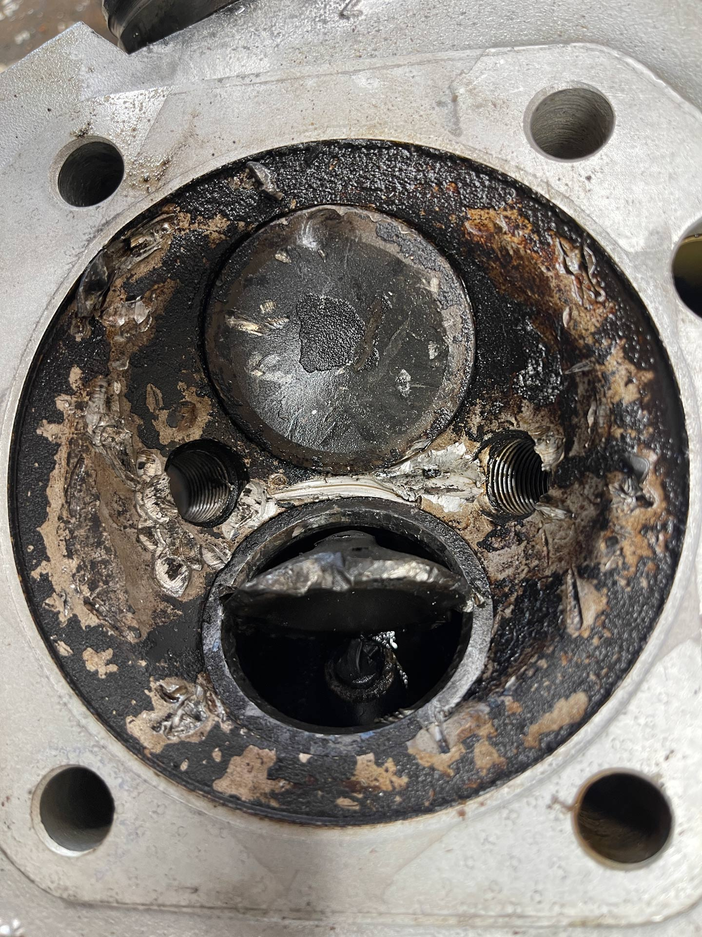

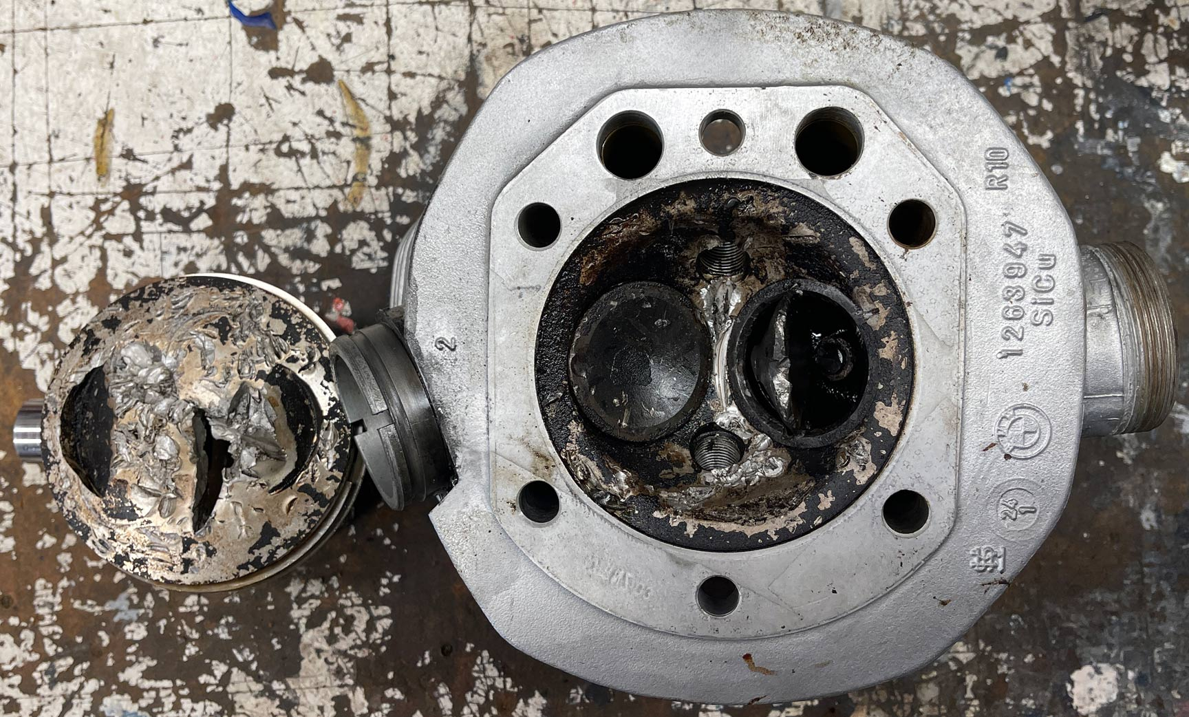

Didn't take long yesterday to see that the doodoo was deeper than I thought on the red motorcycle. After removing the head pipe from the damaged side I could see the head of the valve sticking sideways out of the valve seat.
Turns out the valve is non-magnetic, and very likely it's a Black Diamond stainless steel valve. They're infamous for galling in the valve guide, sticking open, and breaking off when hit by the rising piston. My records aren't clear on the history of this head, other than that the second spark plug hole was put there by a machinist that also uses those Black Diamond valves in his rebuilds. I'll give him a ring today and see what he says about repairing the head, but I don't hold out much hope for that. I might have a spare up in the rafters, and it's likly to be less expensive to recondition that one than repair this one. There's a good chance the rod is bent, too. And I can see that the bore of the cylinder is damaged, so that'll have to be sent out for repair as well. That can't happen until I have a new pair of pistons in hand, so this is going to be a long, expensive, repair.

RNG-
Yikes. That looks ugly, but repairable if it’s the only option. It’s probably a good thing that you have a spare. Do the rods bolt on the crank, or does it all press together?

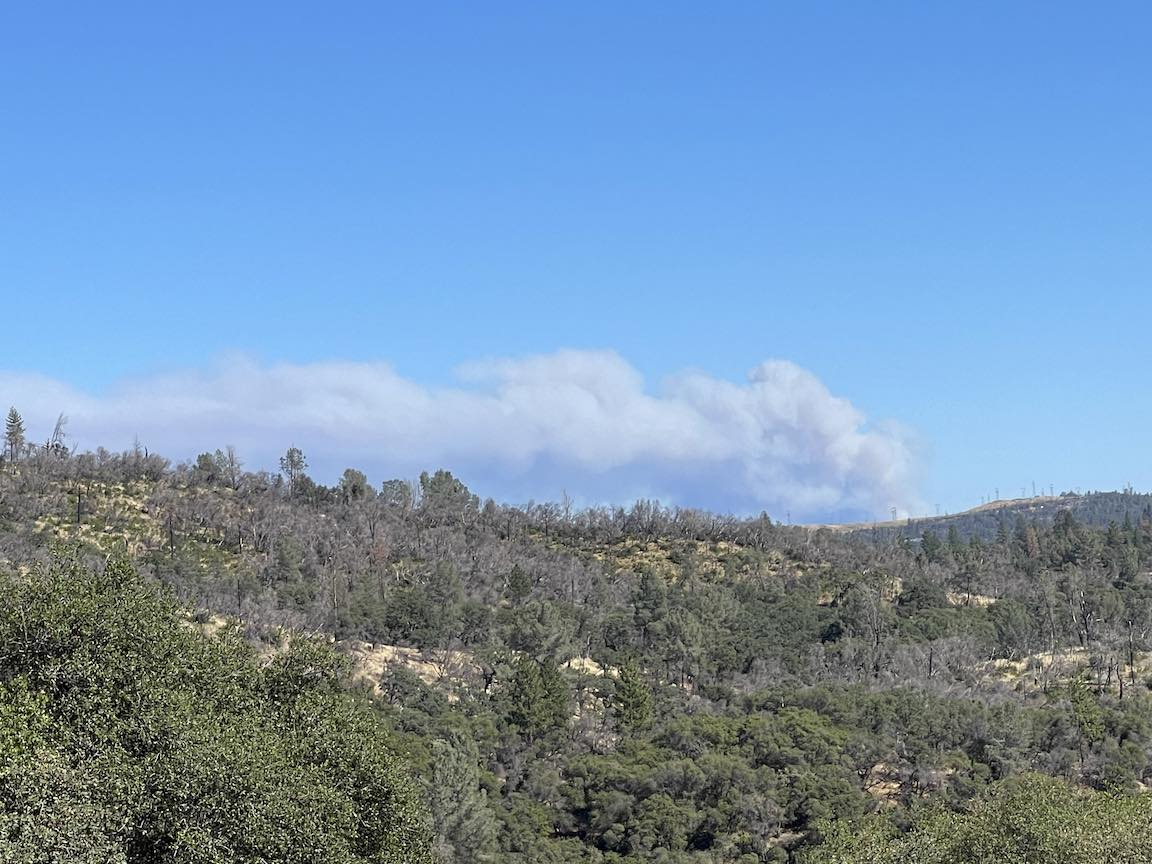

Forgot to mention another wildfire that sparked up yesterday to the southeast of here. It's called the Rices Fire, and the smoke plume was visible from the back porch. It looked a lot closer than the 25 miles it turned out to be. I remember that last year's Dixie Fire ran 28 miles in one night, but if winds hold in the current direction, this one won't be a threat.
The Watch Duty app this morning reports the fire has grown to 769 acres with 0% containment. Evacuation orders are in place and approximately 500 homes and buildings are threatened. The wildfire spread from a structure fire. Apparently the owners didn't create enough defensible space. Most people think defensible space is to protect homes from wildfires, but in reality the authorities put defensible space laws in place to protect the surrounding communities from structure fires and carelessness on private property.
Not only is Summer officially here, so is wildfire season.

The rods bolt on, Paul. This'll be the first time I've had to go into the bottom end of one of these engines, though.
