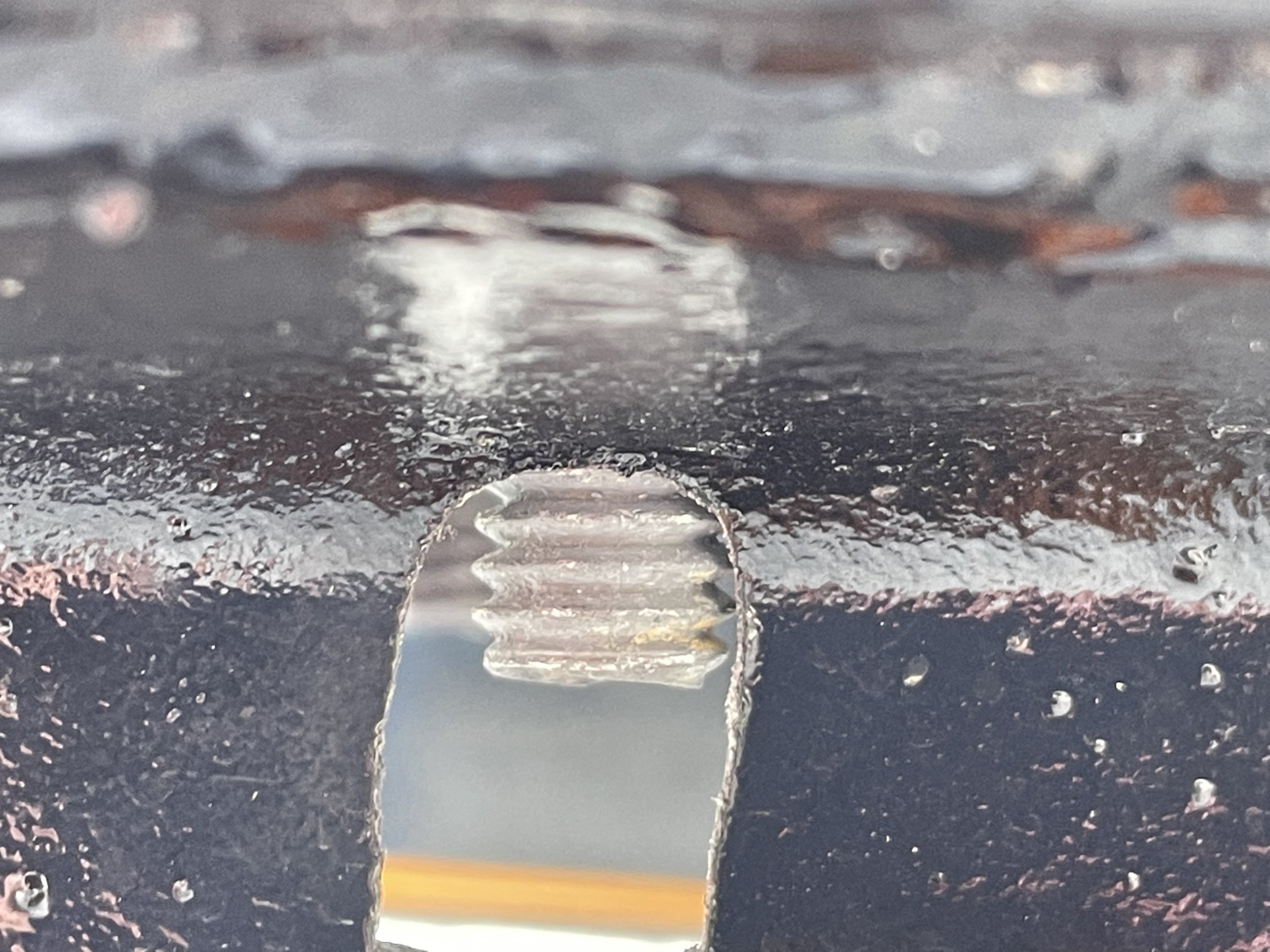

David, yes. I'd prefer delrin but will take steel. Thing is a bear to elevate, good way to wreck my back. I need it a couple inches higher.
Sure miss my floor jack... clamp goes around back but nothing other than pressure to hold it in. Born to fail. I will likely take a small strap and strap the tire on also. Visions of it bouncing down the Thruway at some family van full of kids. Belt and suspenders. Particularly since this is not the oem position. Again, this needs a couple of tack welds on it and never have a problem again.
next week, time to look at an Everlast or some small combo welder. I want to work smarter, not harder. My hands and wrists aren't happy at all from getting scorched by the hot drill.
The fun went out of that at the third ouch.

...was solid as a rock in its hole, decided with my new 18 dollar drill bit to go zipping
through the last two. Wrong. I now have four dull drills. Could not even get to bottom of the next hole.
Wow sure understand now what a magnetic drill is for.
My lesson from this is drilling hardened steel is nuts; I'm going to get a small welder. Could have done this really easily and without breaking a sweat with the welder.
Drew, don't know if you did this, but it's better to drill a pilot hole with a smaller bit first. The smaller drill will go through faster and easier...and the "full size" drill will be less likely to dull or heat
BTW, did you use any lubricant?
   / Good morning!!!! #152,014
Roy, yes and yes. My hat is off to the folks who made this steel.
I sprayed oil down in the hole and had the drill on slow, after drilling pilot hole.
But I was stumped on the last one, I kept dulling everything I stuck down there.
Even the new bit wouldn't work.
So....in this case one grinds them to death. Back to get a smaller cobalt drill. Something to more easily drill through bottom.
That big drill, and its operator, were clearly not up to the task. So yes, I need to get a smaller hole in first.
What is so weird is first corner went perfectly, drilled through reasonably easy, admit as I went on things just got harder and less little bits
of metal produced. I had a vac there and constantly vac'd the mess so nothing got in the driveway. Got one sliver in my finger. Got that out in a hurry.
So first three holes went fine all the way through, bolts on, mission accomplished. Then a fail on the fourth, the guy popping through that opening, and a total fail
on the fifth. I quit. I need a welder.

If the steel in the part you were drilling was hardenable, Drew, just the heat from drilling could cause what you saw. In those cases, a low drilling speed and lots of down pressure is needed to keep the drill cutting. If it just spins, it generates heat, and when the material cools, even carbide has a tough time cutting it.
I once tried to drill a pilot hole in a railroad rail so I could more easily cut it with a plasma torch. I used carbide bits, and burned up three of 'em before I gave up. Just can't get the control over speed and downforce with a hand drill that's needed to do the job.

I'm thinking a spot weld on that bolt though that little hole would both work, for reasonable forces, and be easy to see if coming loose.
Like my own inspection window
left palm is part cooked and right is muttering unsweet nothings to me.
As in get a welder.
I have a nice grinder, flap wheels galore, and am very good with a black rattle can.
Welding just makes more sense but I tried to do what I thought I could do.
And I can't.
I'm not that stubborn, one more hand to fold, and play another.
